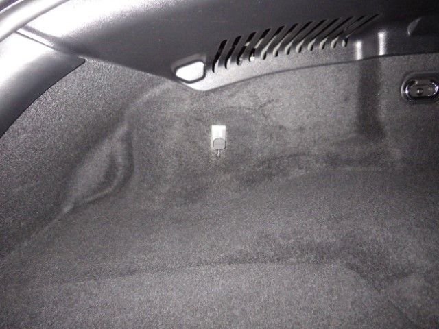

Supplied by another forum member....

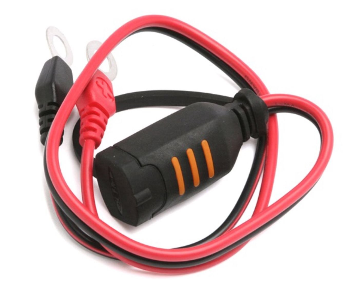

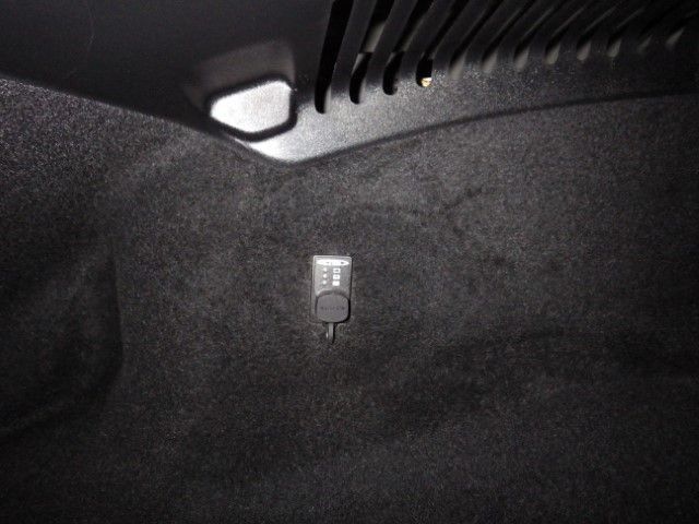

If you have Ctek tender then just connect this bit. When you connect the tender the wire fits under the trunk lid with no problem.

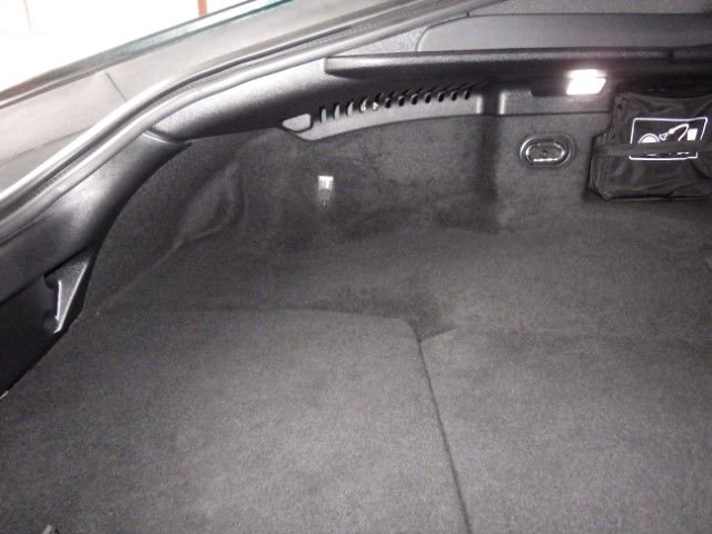

Or a build in tender connection as per the Jag instructions:
