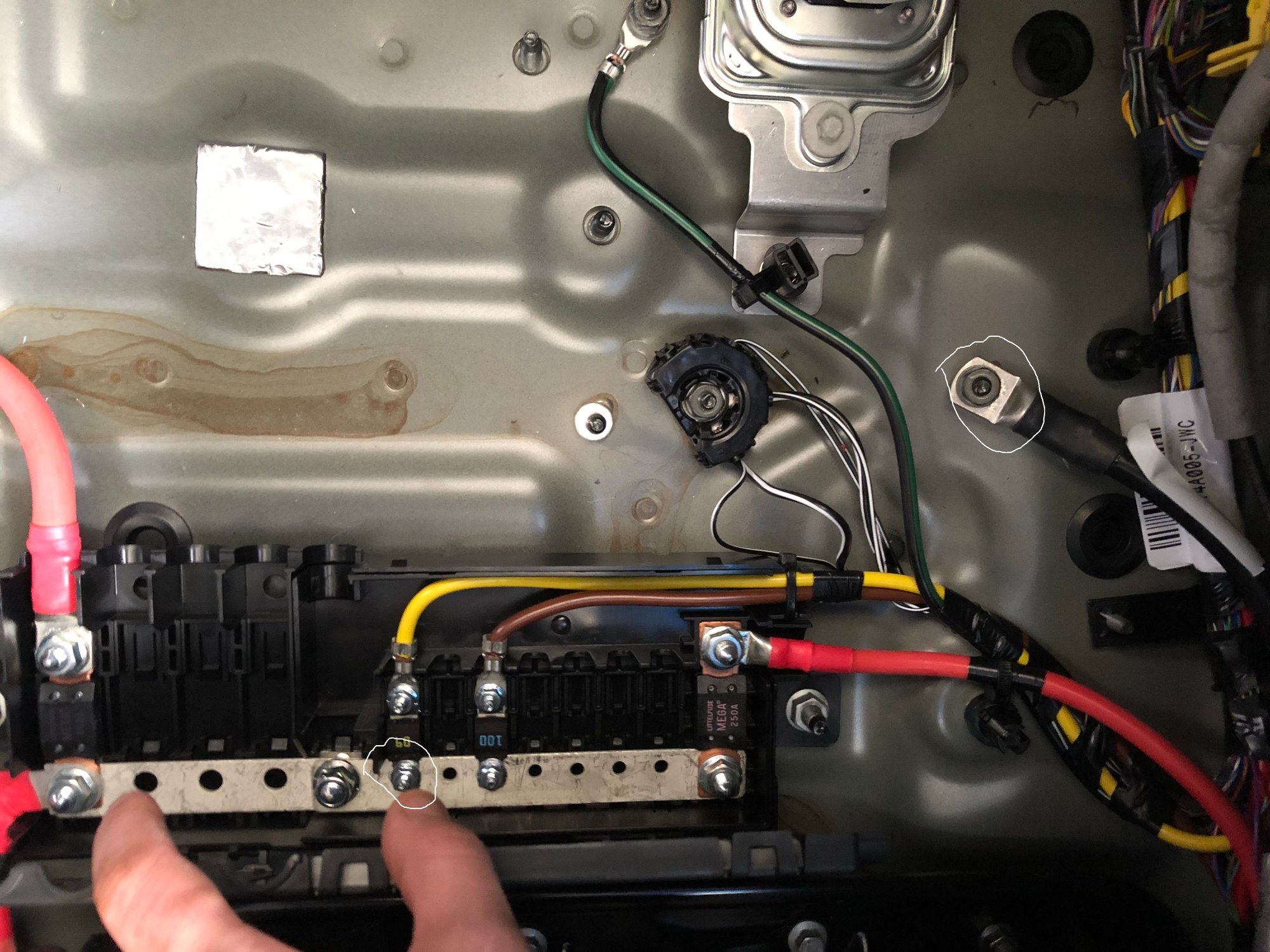

Hi,
Do I connect the CTEK to the areas circled in white? If I use the eyelet connectors do I need to do anything special or just overlay them on the areas circled?
Thank you in advance.

Another question:
I Use the CTEK battery tender on the front/under the hood main battery, do I also need to hook it up to the aux battery in the trunk separately also?
or does charging the main front battery takes care of both?

The connections circled in white are proper. You can connect the positive side anywhere on that bus bar.
Does anyone know: What is that thing to the left of the ground wire, with the white/black wires connected?
I believe that’s where a number of smaller circuits are grounded
That's what it LOOKS like...(I noted the big ground lug in the center.) But could the black 'collar' be a surge suppressor or something?

Is it necessary to disconnect the battery before wiring to that bus bar? My beeping voltage tester doesn't alarm when I touch it to anything in there.

No the battery maintainers only charge the big battery. The secondary battery is charged by the car as the two batteries are isolated.
You could add a second charger but the small battery does NOT start the car so I don't see any point?
