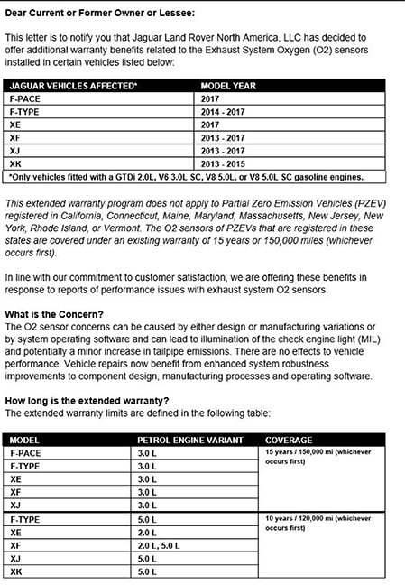

Are you aware that these sensors are covered by Jaguar under a 15 year warranty (for the V6 in Canada, at least and probably in the US)?

I asked at the dealership about the extended warranty and never got a reply. When I looked this up online, I seen from 2014 to 2017 the warranty was extended. The US has an 8 year emissions warranty on all vehicles, which I still would fall under, but when I asked about this, the dealer said they would need to determine whether this sensor effects the emissions. Which the obvious answer is, yes it does. The first sensor was replaced by the dealership and they had the car for almost a week, Since I have all the equipment needed to do this type of work it tends to be easier for me to just do it, I would rather take an hour or two and do it myself and have the car to drive.
Thank you for the information and your experience.

Thank you alchemystic for the letter

My thanks to all who replied. I ordered the O2 sensor, should be here tomorrow. I have to change oil anyway, so while the car is in the air I will replace the O2 sensor as well. Since I have a 2018 model year, I don't think much of this will apply to my vehicle, and for me to debate the dealership on this issue is not worth my time. I will check what I know to check to see if anything is out of sorts, but I doubt it since it is now three different sensors in different locations and both banks.

My 2018 O2 sensors were replaced under warranty, it would be worth checking again to save you the hassle.
