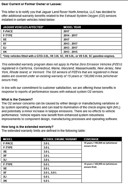

O2 sensor extended warranty covers 2014 to 2017 model years.
15 years for V6
10 years for V8
Old Nov 20, 2024 | 02:50 PM
JagV8's Avatar
Posts: 27,546
Likes: 4,924
From: Yorkshire, England
But not for the X-Type?
Old Nov 20, 2024 | 03:56 PM
Peter_of_Australia's Avatar
Joined: Aug 2022
Posts: 2,157
Likes: 635
From: NSW, Australia
That extended warranty for a few 2014-2017 models, valid in a very small part of this world only - obviously does not cover the X-Type, since the last X-Type was build in 2010.
Also: The X-Type is from the Ford-Jaguar era, while 2014-2017 is Tata-Jaguar, who all but stopped car production anyway (except for one electric "mobility-scooter"...).
