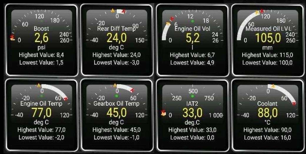

When you took your screen shot, was it just warming up? Your highest coolant temp is 90C (194F) which is much less than my max (225F after first start of the day and fully warm after ~10 minutes then quickly goes down to <200F).

It's just an example and I reconfigure my gauges now and then depending on what I am most interested in. I also keep a digital volt meter plugged into the power outlet in the center console. I have been lazy as far as consistent use of the gauges. Should be using them with that audible alarm for coolant temperature too.

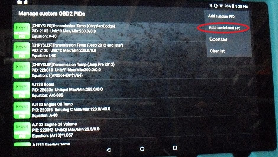

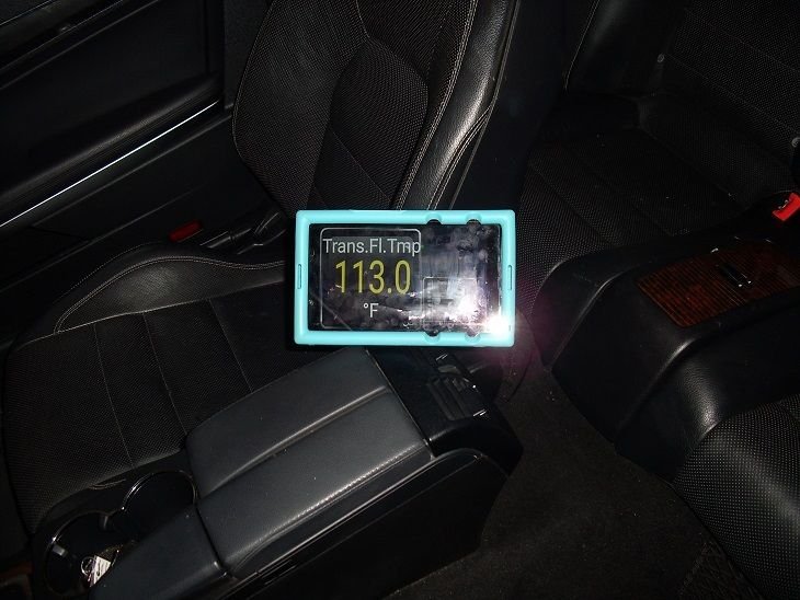

Here is an example of how flexible this system is. I was doing a fluid change on a late model MB 350E convertible. The car has the same 6 speed ZF we are so familiar with in the Jaguar world. So you need to monitor the fluid temperature to set the correct fluid level.
With some searching I found that there are all kinds of custom PID packs for TP. We have a great set built by Cambo just for Jaguars. I found and installed the Chrysler/MB PID pack. This car was an older MB back when they owned Chrysler. So it was listed for both brands.
Normally people try to read the fluid temperature by using an IR gun and that works but is a PIA! Too many things going on at once plus the lovely position of the fill plug right next to a scalding catalytic converter!! With this setup I made a large single custom gauge dashboard. Now the TOT (Transmission Oil Temperature) is easy to read and it's big enough that the tablet can be placed safely out of the way but still very readable.
Here I am sitting in the drivers seat with the car running monitoring the fluid temperature in real time. Now I know how close I am and can raise the car on the lift to make the final adjustment.
I have a heavy rubber case on mine and it can withstand drops of 4'-5' to concrete without damage. Yes it will happen in the shop!
A little bit of work but once you do some custom PIDS it's not hard.
