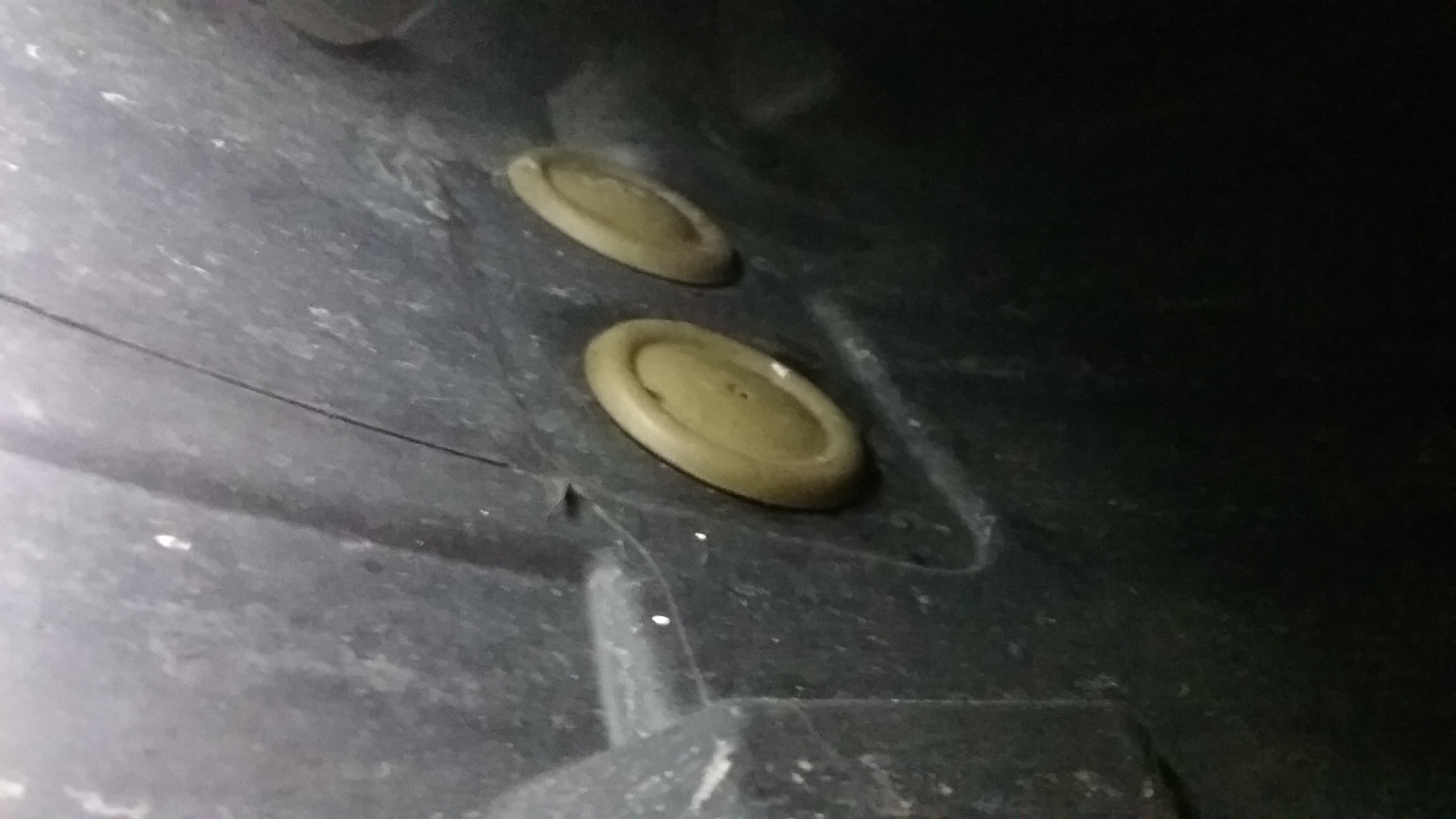

  #480
Valerie Stabenow's Avatar
Joined: Oct 2020
Posts: 1,444
Likes: 609
From: Wisconsin
Originally Posted by Uncle Fishbits
So I went to the dealer, and they took a peek.
this is a terrible few seconds of video that doesn't show the wiggling as much as the one edit that shows the "lines" completely off mark and not correct. But the flashlight and fender were moving quite a bit.
https://goo.gl/photos/Wex7m44uRXd3VZvK9
So the dealer fixes, totally under warranty, etc... but their explanation:
"A bolt, or bolts, just 'fell' out. Have no idea how that happens. Imagine that... so weird". They were friendly, accountable, etc.... but this sort of comment reminds me of the old days of Jag and problems.
I've an idea, but that's for another thread. =)
Had a similar issue with my new to me 2017 premium. Noticed that pass. side light/fender stuck out and gap between light assembly was wider than dr. side. Found I could push in light assembly and took a look inside fender well. There are 2 plugs in the upper well that cover access to the two fender bolts that hold the light assembly. A look in with exam mirror showed neither of the two bolts in place. Plus no "washer" scrape indicating any fastener had ever been there. Bought two fender bolts from dealer, had husband press in light assembly, and got the bolts in and tightened. That side now aligned. Gap between hood/ bonnet consistent with driver side.
