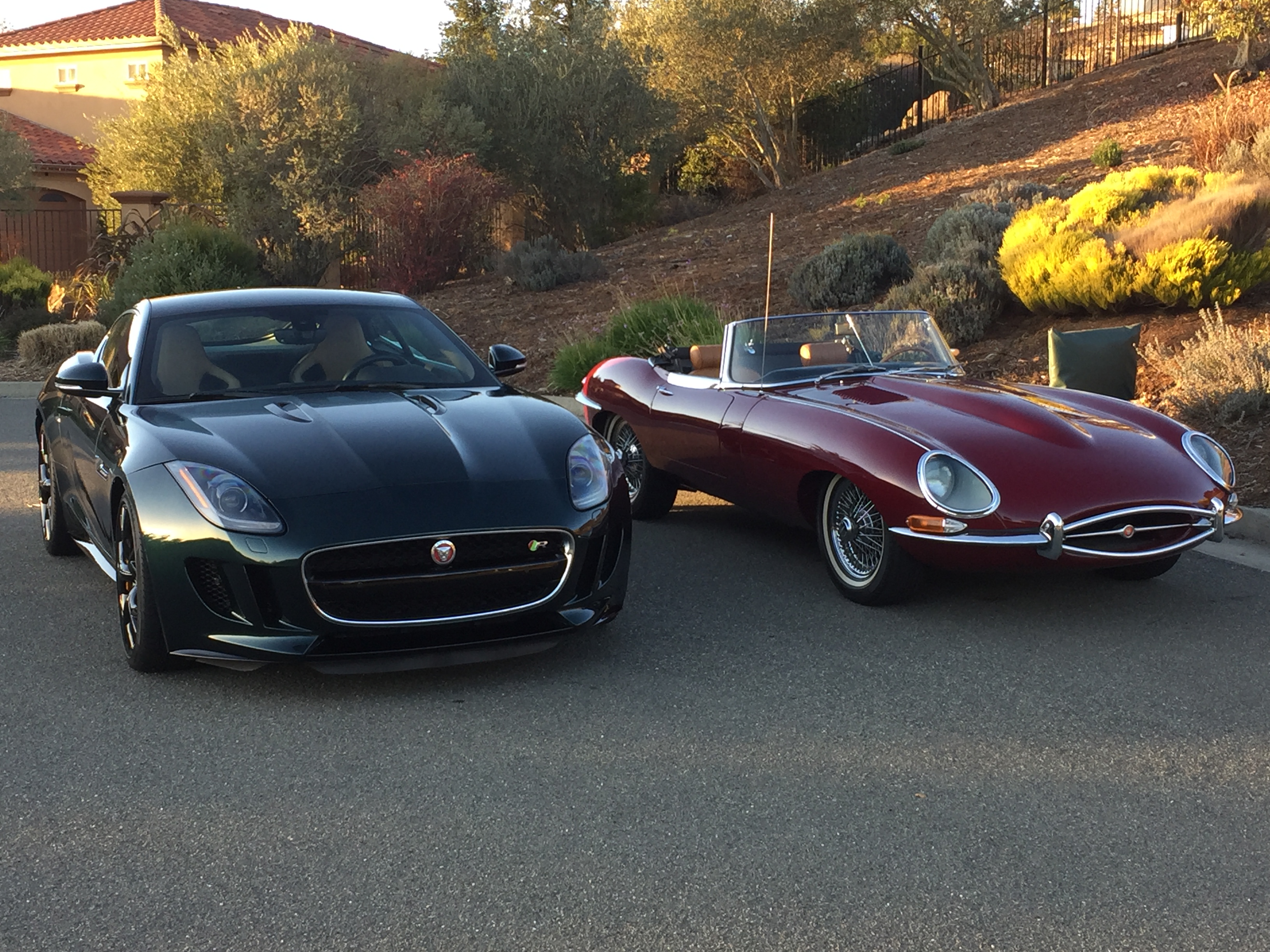

Default F-Type / E-Type design heritage
Nice work on the front grill mod! I'm thinking this may explain the origin of the F-Type split grill styling?(?):
