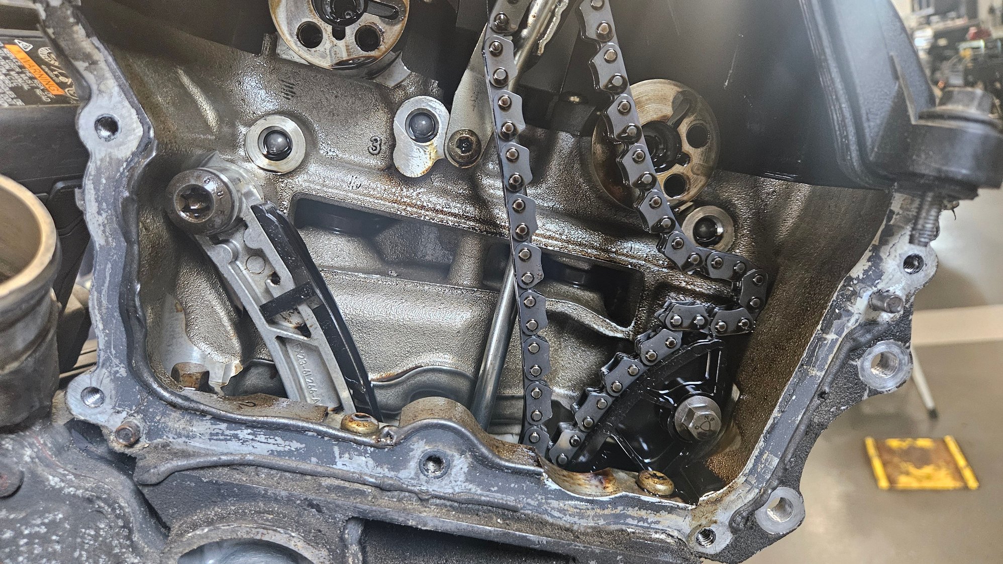

Have you fix the problem yet? I having the same problem on my XF with 3.0 SC

I recently replace all 4 camshaft sprocket and chain kit, but the codes keep coming back!

I made a DIY adaptor to test the oil pressure, it only show 4 PSI at idle speed......worst thing is the car doesn't have oil pressure warning, it only showed oil level. I teared down the engine and found out someone already replaced the oil pump and aftermarket crank and rod before sold to my friend! Because they couldn't sort the problem, so just get rid of it. Oil pump feels good and the solenoid functioning well, all bearings (Main & Rod) look clean, doesn't show any wears and tears. When I removed the oil cooler, I found some dirt inside! I tried to pour some gas to clean it up but the gas goes in never came out!! I using shop air to blow inside, it's not even get through. The oil cooler is clogged, that may be the cause for low oil pressure. I just ordered a new oil cooler, hope everything work out fine after that
