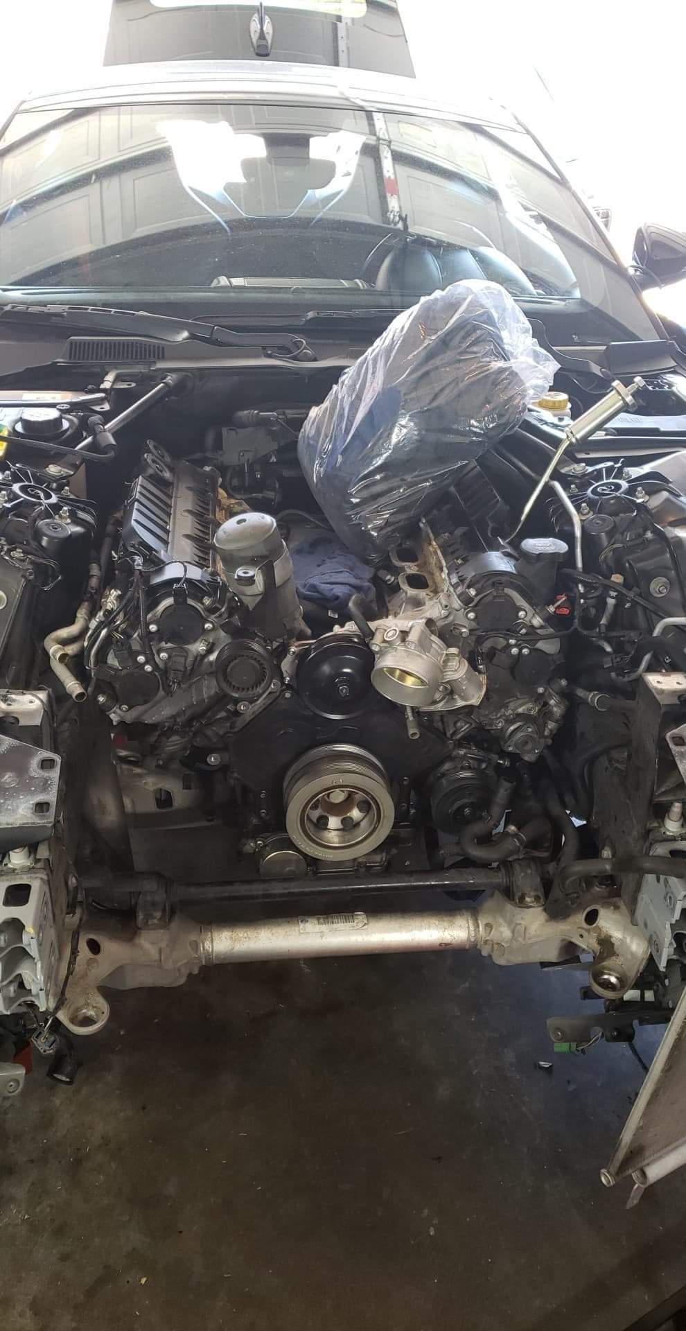

Ran into a more major issue. It looks like the injector is seized into the head. So I'm already started my teardown to pull the motor. Looks like a very easy to pull block compared to all the other motors I've pulled before. Does anyone have some technical info, as the torque sequence for the head bolts and how much torque? That would be insanely helpful. Thanks

Yeah I have the tool and I've let it soak in pb blaster and it's not coming out. It ended up breaking in half. So the only way to get it out is to remove the head and get it out that way.

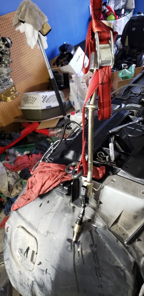

So I was halfway through tearing the car apart and decided to try something different to get the injectors out as they all were siezed in. I hooked up the injector puller to my cherry picker and cranked it out. The force to pull them out was brutal. Literally lifted the car off of the Jack stands a little. Got all 6 out like that, but I had 2 more broken ones. I unbolted the motor mounts, and lifted the motor up to get a straight shot at the injectors that were both on the drivers side head. I drilled and tapped the injector. Took the shrader valve out of my compression tester, and put it into the spark plug hole and closed the valves. Turn my compressor on full blast and hooked the bolt to a chain to my cherry picker and bang they both came out. I've never encountered anything like this and I've been working on cars for years. I've ran into some stuck injectors but not some that will lift a car smdh.

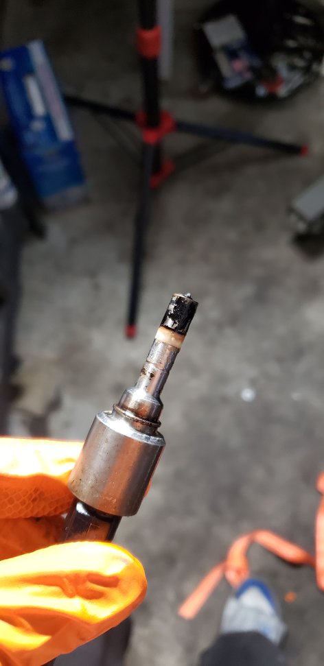

They all were stuck like that. If you look at the tips of the injector below the compression ring its coated with carbon. Carbon builds up onto the tip of the injector and locks the injector to the head.

I think driving this car soft or babying it is a big no no. High rpms help break up carbon, so if you baby it too much you're allowing carbon to form. That's just my opinion, maybe a seafoam every now and then. We don't seem to have a carbon valve problem, but this car does have an injector carbon issue.
