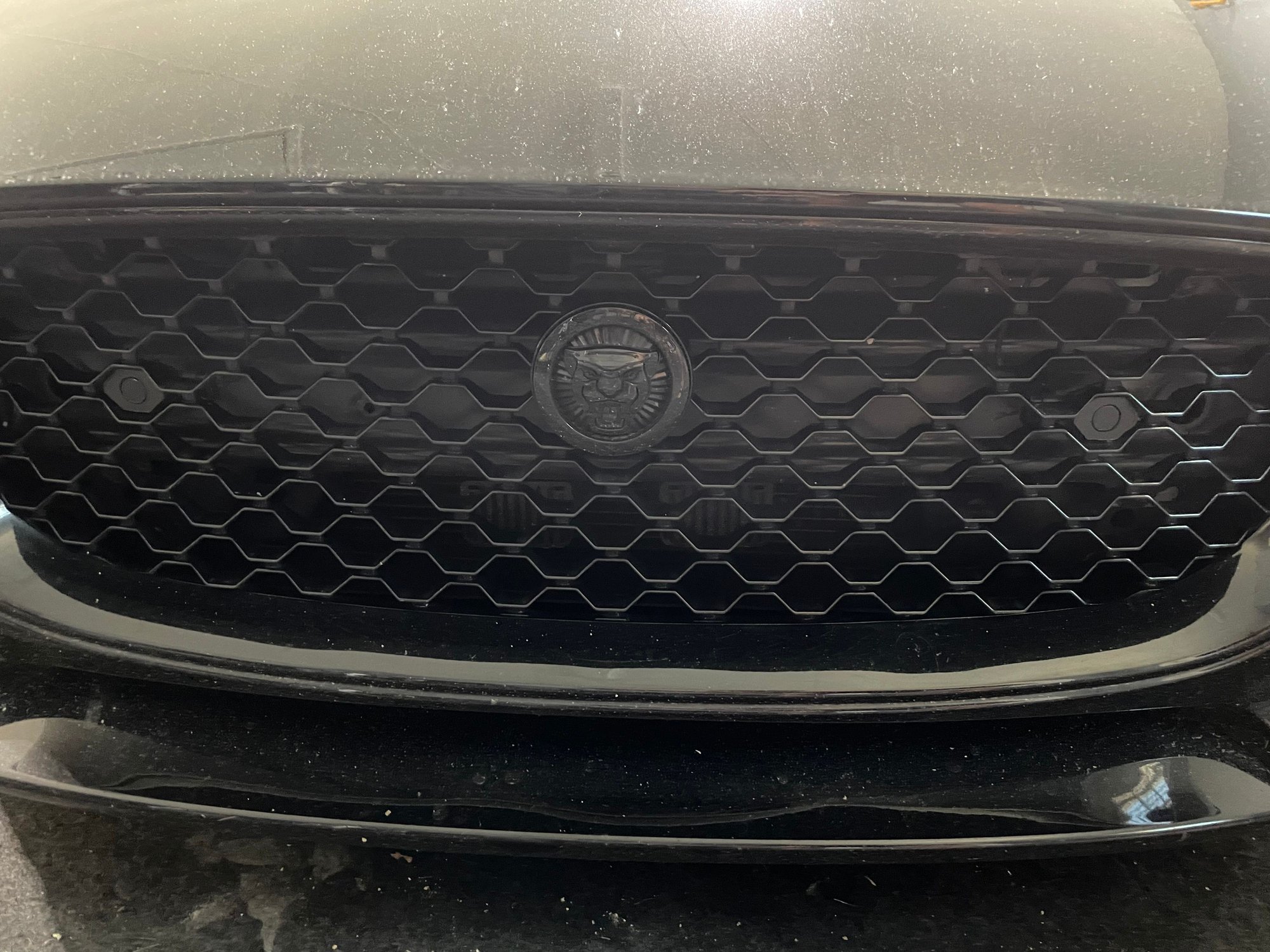

Not completely flush but no issues.

Mine is like Datriani's and they dont work properly.
That is interesting. I'll let Datriani chime in, but those look like Meister_Kajo too. Mine snapped with no fit issue nor sensor adjust issue. What is not working properly?

When they get a hit they just stay on until i either turn them off or i drive away.
I believe I did get those from Meister_Kajo. Yep, no issues.
