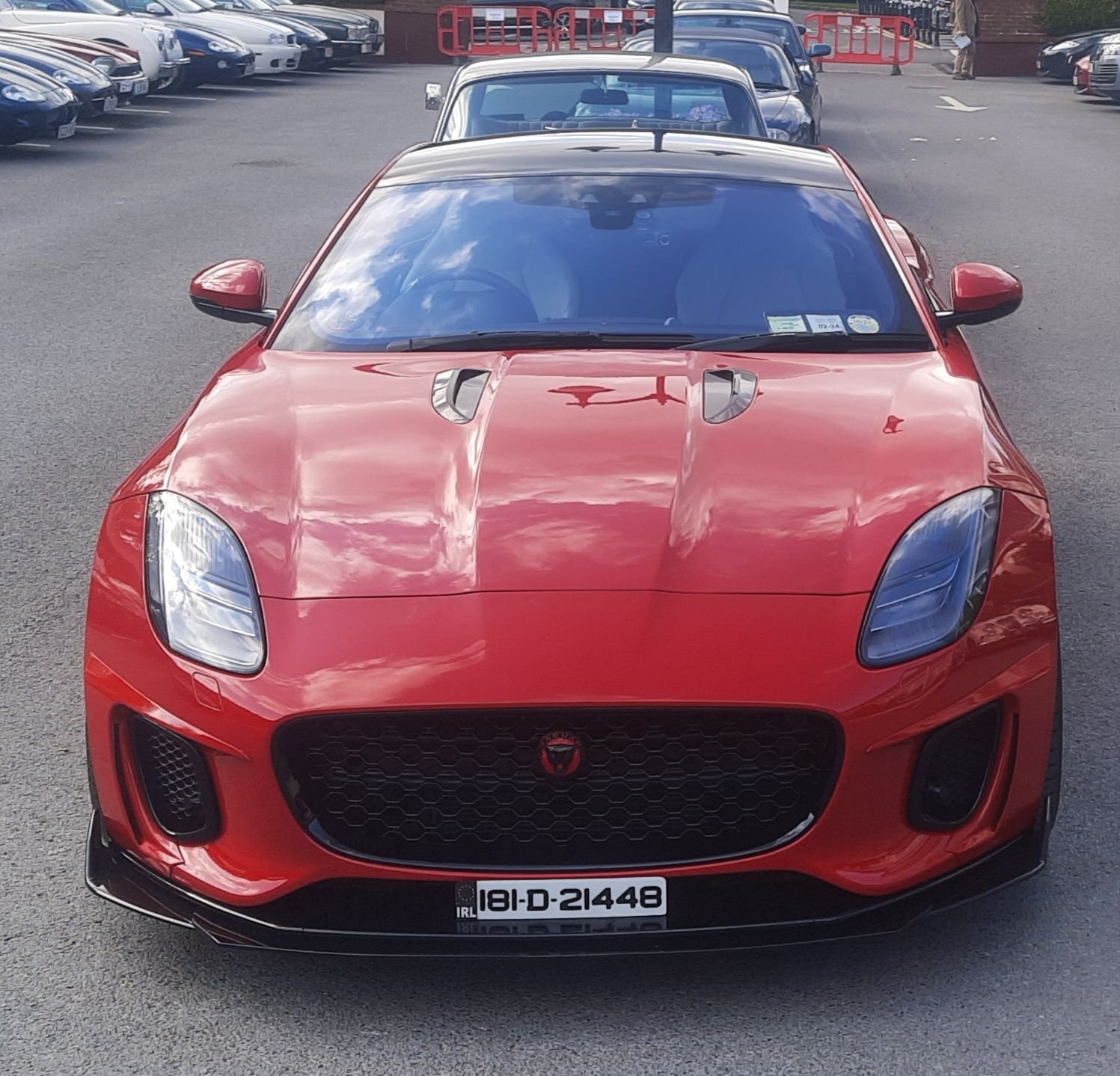

I was lucky got my OEM from the dealer back in 2019, €480 the whole thing

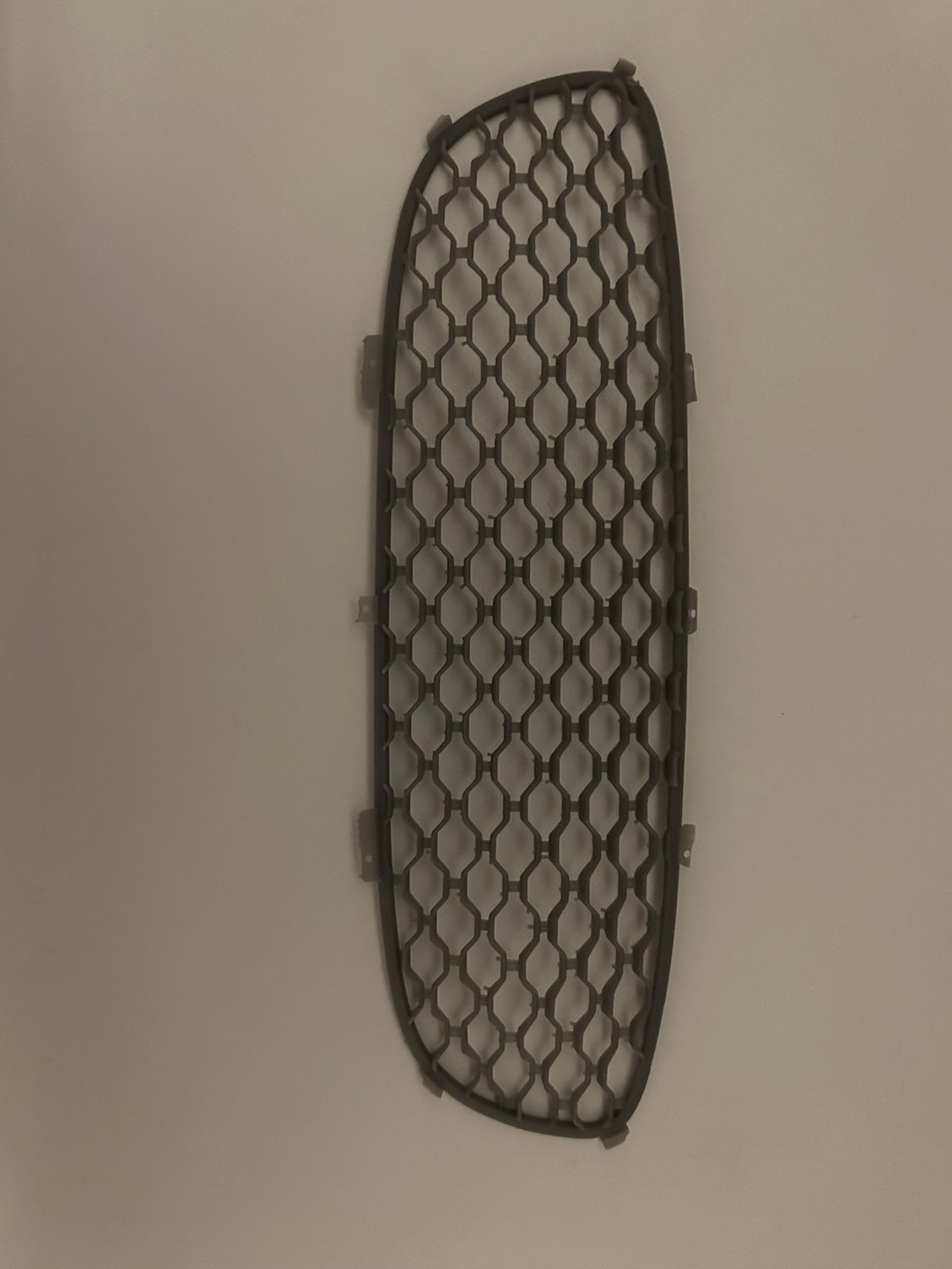

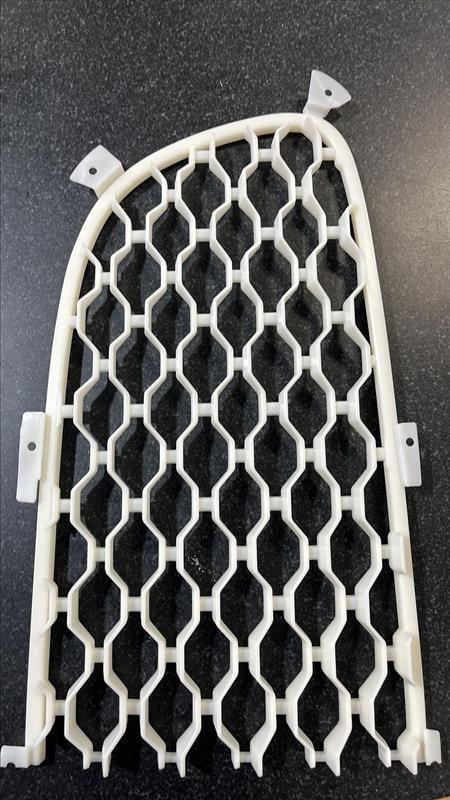

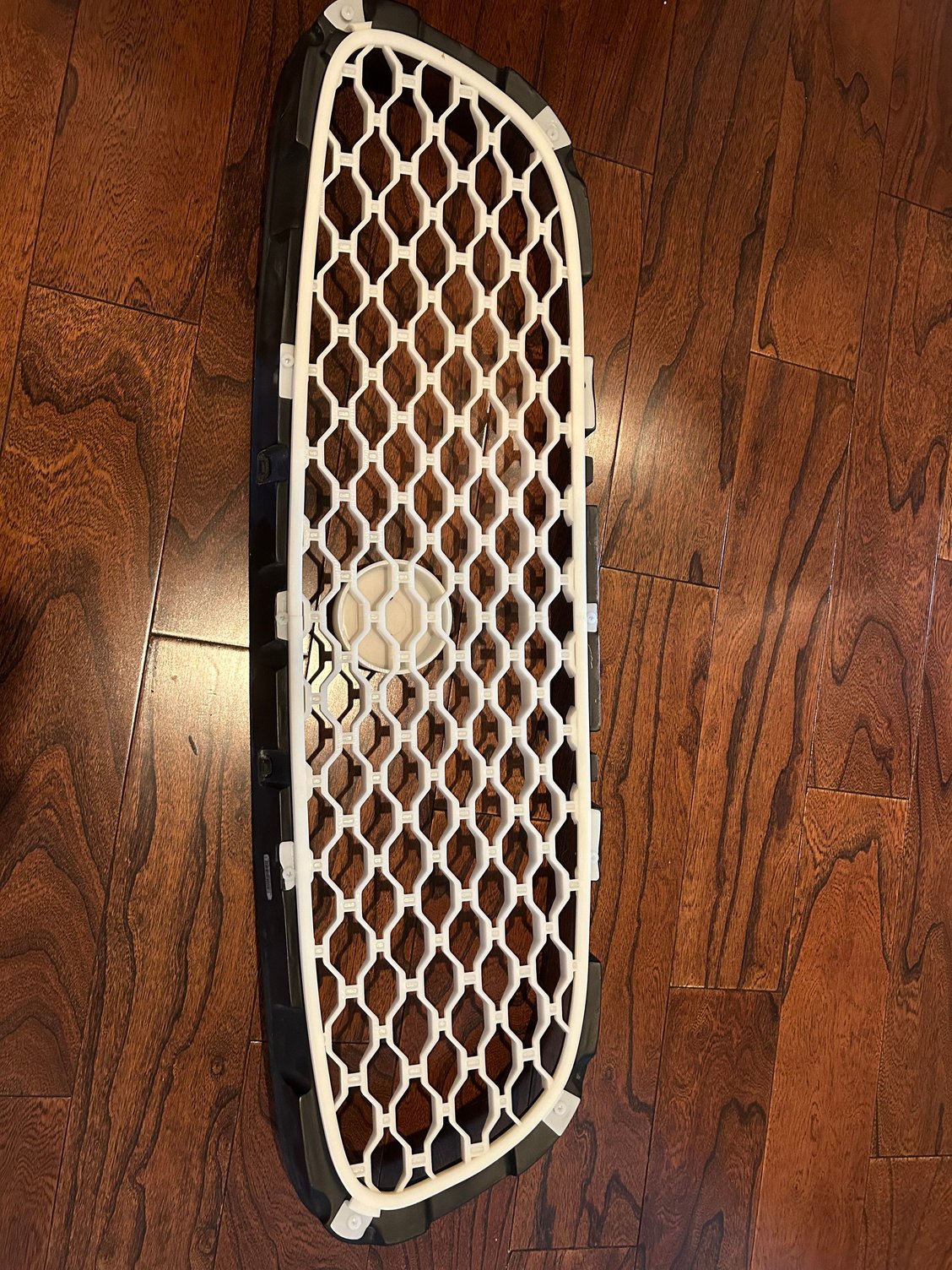

I think I'm ready for a 3D print for testing:

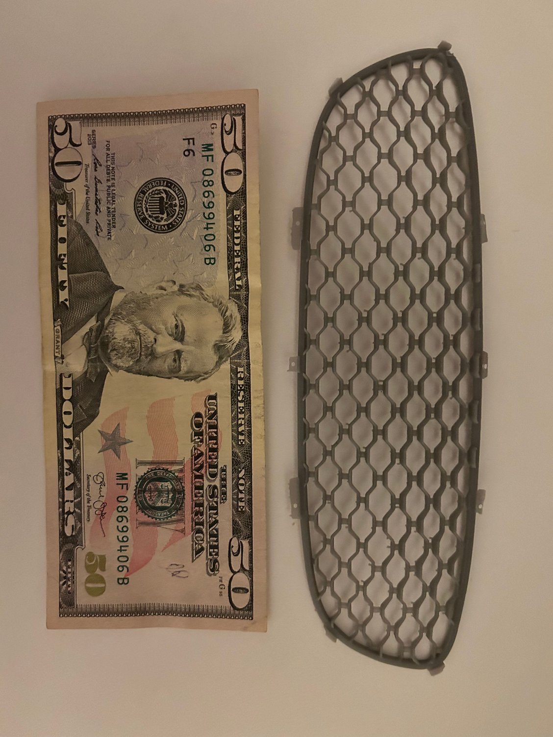

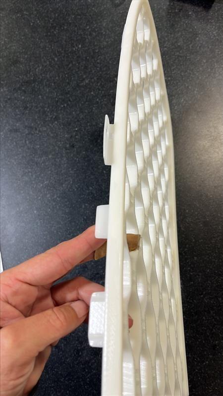

First 3D print is done and everything looks great!
Only one problem... It's a touch too small:
But now that it's done, I have ordered a full size print. It will be delivered July 10. Judging by the price, I should be able to beat both the cost and delivery estimates I posted originally if the part fits well.

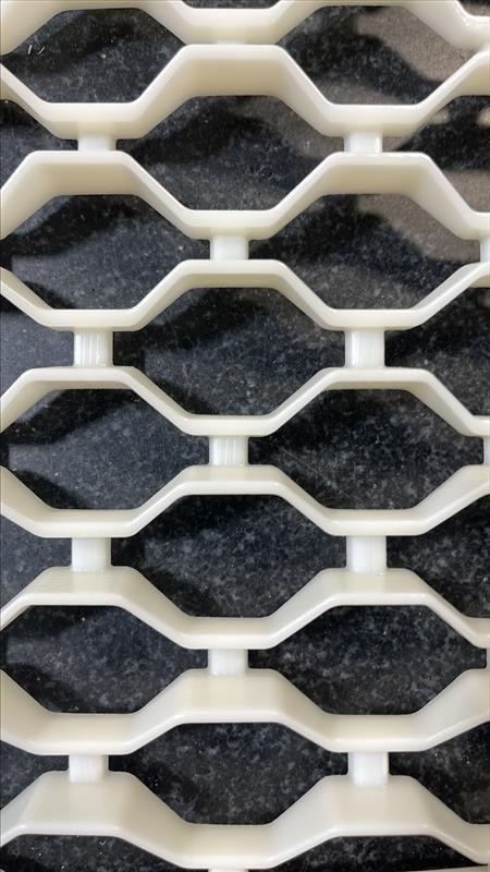

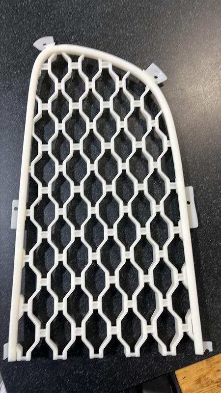

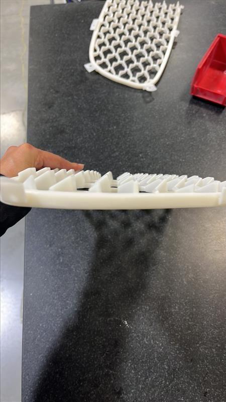

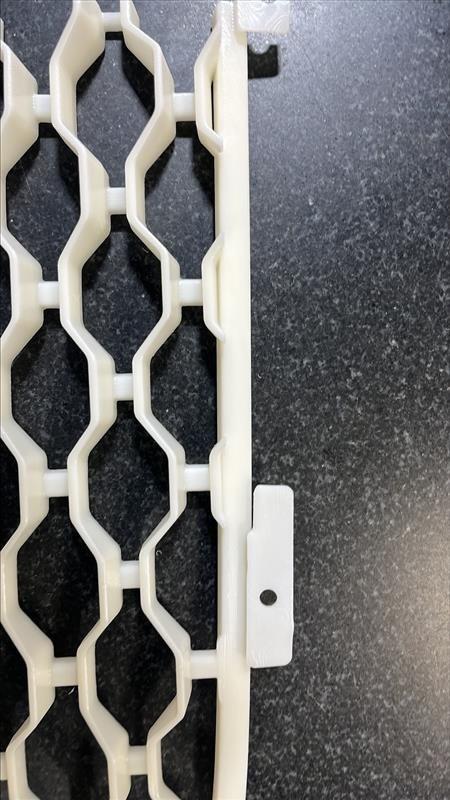

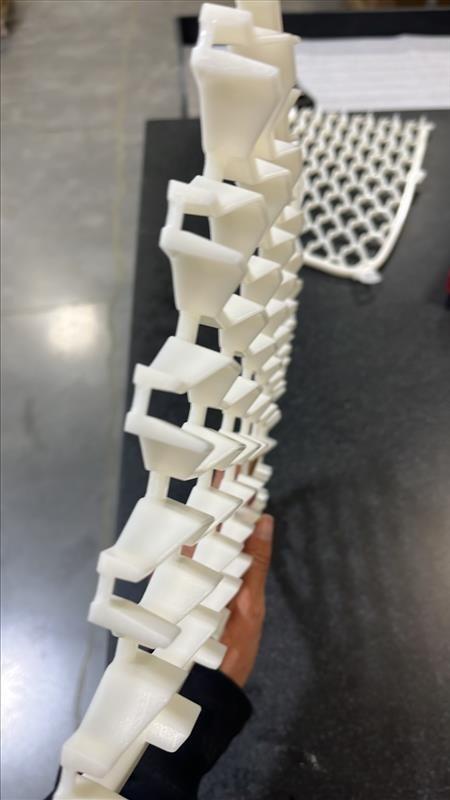

Printing company sent me update photos. Remember this is just for fit, not finish. Real parts will have much better surface finish and will be a single piece for the mesh.

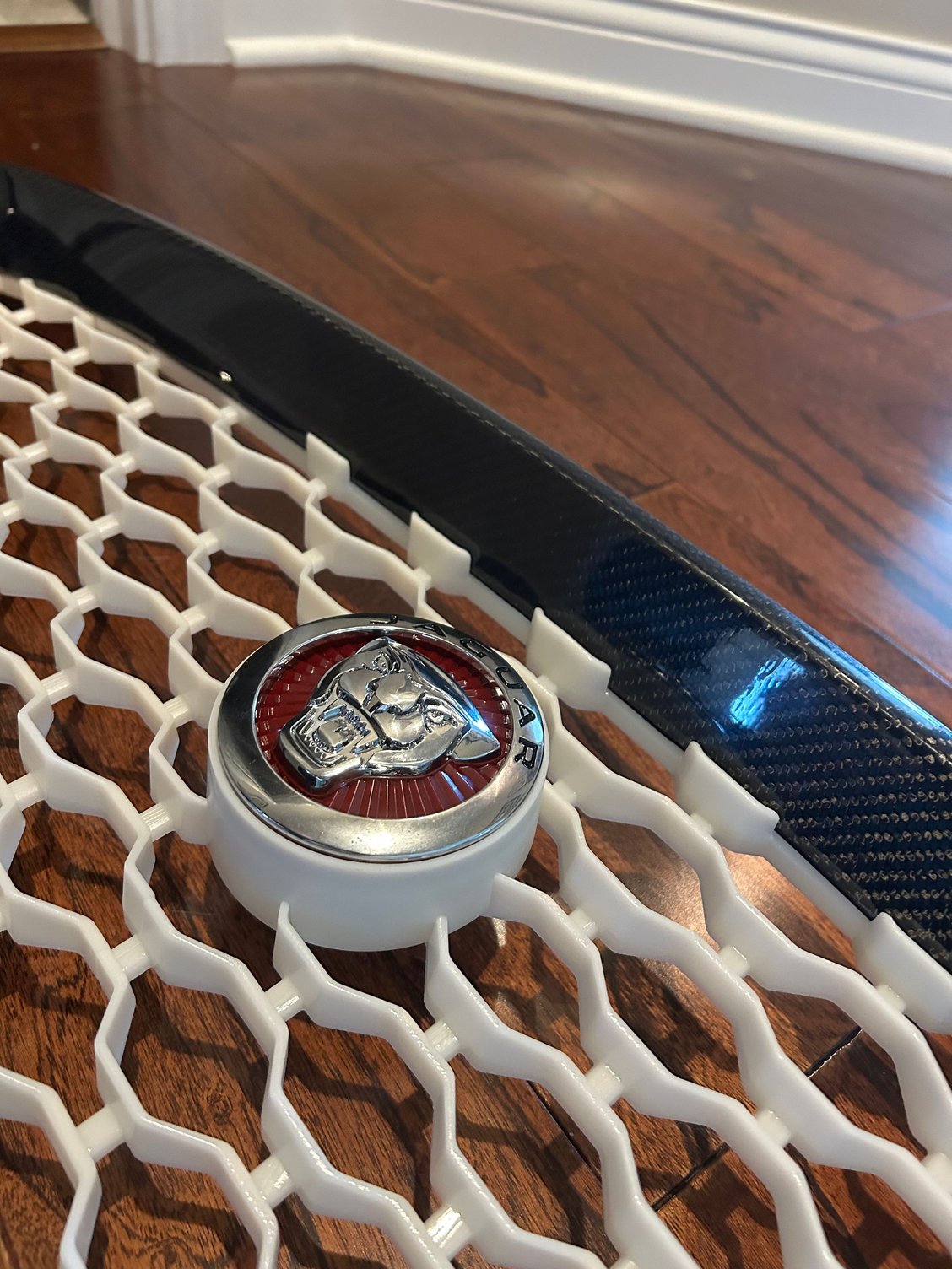

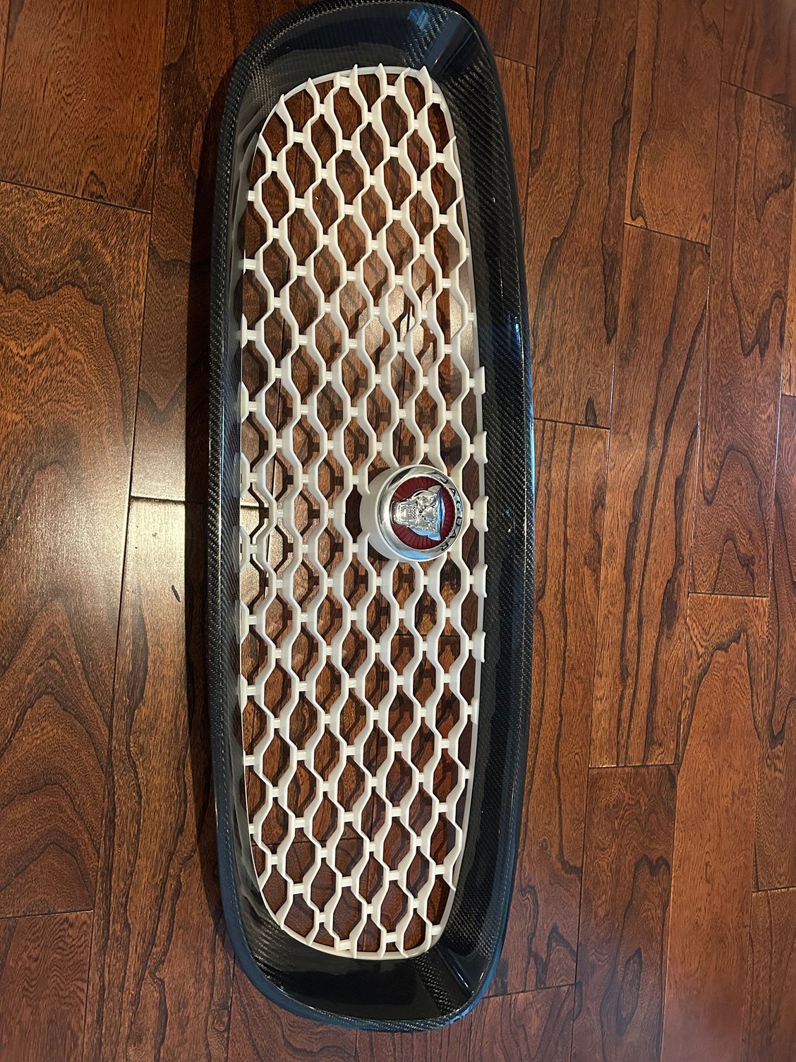

Got Harware! And the fit is excellent!
Nice! Is there a way to test how sensors and tow would fit?
Is carbon fiber the only option or do they come in black?
Old Jul 7, 2023 | 03:34 PM
  #59
mcphill's Avatar
Joined: Aug 2022
Posts: 403
Likes: 195
From: Indianapolis, IN USA
Yes, working on it!
Currently only carbon fiber (I think it's fake, but it is very convincing), but the part is easily painted if you want black. The finish is excellent and a light scuff should be all you need to shoot it with gloss black and potentially a clear coat. If there is enough demand I can look in to bulk processing getting them painted black, but would need at least 5 people that would want it that way.
