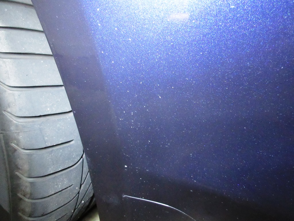

I don't have paint peeling however this is a high impact area. Wish I knew earlier, would have had Xpel Ultimate put on when I did the front. Photo taken right after washing the car.

Ouch! I have just received pricing on clear film protection, which includes an option for the rocker panels. Just waiting on a couple of answers to question about fitting and options.

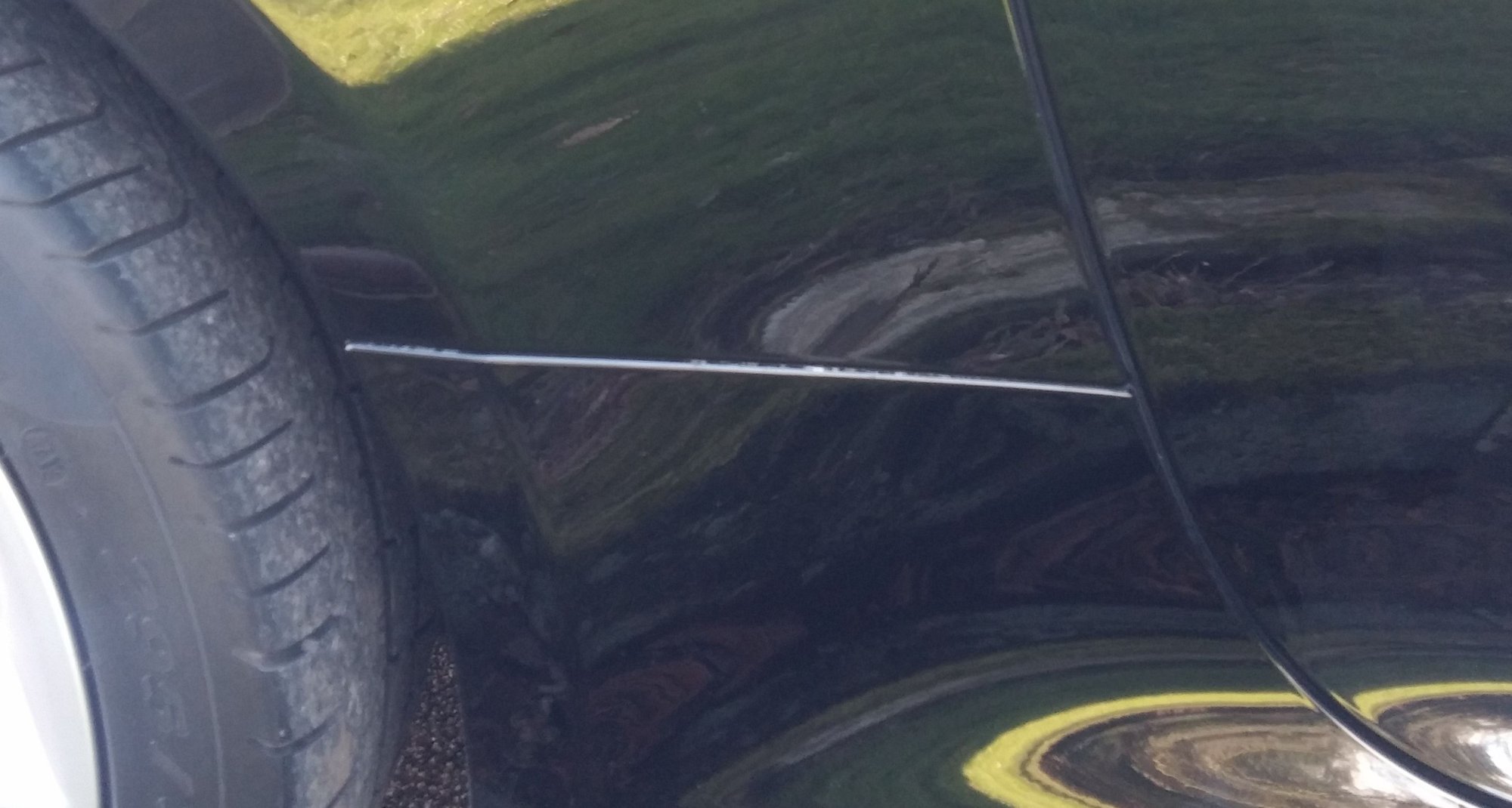

F Type 18 months old (ex demo). Just scanning the forum. Can't believe have just been discussing this problem with Jaguar today and then decided to search the web to see what the problem could be. Just seen your comments. Have exact same problem with mine. It's definitely not wax. Paint seems to be flaking between the panel join.

Yep that's it exactly the same. I had no arguments from the dealer they are going to fix it.
