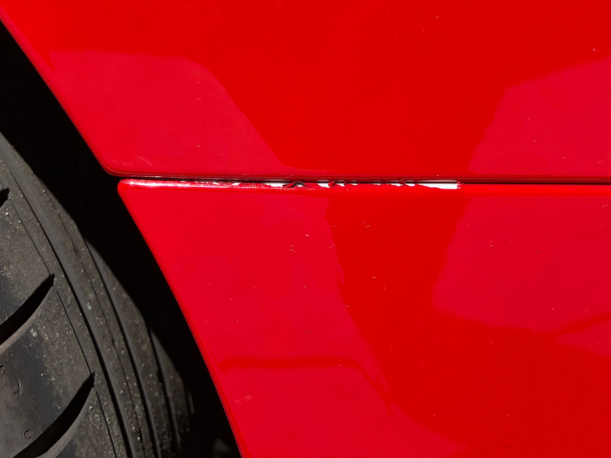

Funny to see this thread. I have my car in the dealership for the 2nd repaint on the panel, it was actually returned to the dealer today from the paint shop. They say it is very common. I also have the stereo kit going in today which will take out that nasty rattle on my door panels. This is the second time they are doing this on my car as the first time was a patch job and done before the service bulletin was put out. Hopefully this is the last time I need to address these two issues.

So I got the car back from the dealer. They re-painted the whole right panel in their in-house body shop. It looks good now and the color match is good as well. Let's hope the problem does not happen again on this panel or on the other side. I am kind of disappointed that I had to re-paint the car at this early stage of ownership, but what to do . Do you think that this will devalue the car in any way? specially if this is a common problem in F-Type?
I believe this has been said before, but the paint durability on the F-Type is really disappointing. The paint is very delicate and chips easily. I already have one small chip on the hood, and the car only did less than 1000 miles in 1 month of ownership. I was planning to install Xpel on the car two weeks ago, but this paint issue has delayed my plans.

Re-spraying minor parts like the rockers, rear bumper, etc., won't affect value if done well. What does affect value is evidence of a collision.
It was more common on earlier cars, but JLR supposedly added a layer of insulating material behind that panel which protects that joint from chafing. There haven't been many complaints on later cars. However, my 2014 hasn't had the problem either.

My 2016 F-Type has the same issue. I purchased it 3 weeks ago with what I thought was wax residue. The dealership had no idea how the paint was gone from both sides and thus had the rockers repainted...took a week to get done
2 days later the paint is gone again from both sides..I am reluctant to have the same dealer resolve with the TSB that I provide them...any ideas?

Damn, I noticed the SAME thing on a lower panel on mine too. Honestly, I never even thought about it being a defect and getting Jaguar on the hook for it.
Thanks guys. Calling this week.

My post from yesterday shows the same problem on my S coupe built in January
of 16 with only 87 miles on it. Does anybody have the date that the foam backing fix was instituted by Jaguar on the assembly line?

So are folks still seeing this problem? I just noticed that my 2016 R has this starting to show up.

I've had this fixed 3 times, approved body shop finally devised their fix and problem has not reacurred. It was fixed under warranty. Dealer says at least thru '17 new cars were still showing it! They did some shaving instead of extra padding as Jag recomended, could never get fitted with the padding.
