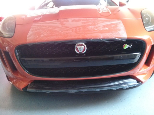

For us spirited drive enthusiasts, waiting for the clear-bra installer to arrive and add the needed paint chip protection is agonizing.
Tip of the day...
When I did HPDE track events with my previous Z4 coupe, I didn't have a clear bra, so I used 3M removable clear transparent shelf liner. It has the same stickiness as blue tape, but doesn't make the car look as goofy...
I also use it on long road trips on my SUV.
Below are pics of the 3M material protecting behind the tires and areas of front of my new F-Type R. I am taking it out with the car club tomorrow and don't want to mess the paint up prior to the clear-bra install in 2 weeks.
The 3M material comes off very nicely and can be left on for a couple of days without issues.
Cost: a mere $10.00 at Lowes, Walmart, Target or Home Depot. Best price is Walmart or Target.
Attached Thumbnails Paint protection while awaiting your clear-bra-img_20150328_173720-small-.jpg   Paint protection while awaiting your clear-bra-img_20150328_173727-small-.jpg   Paint protection while awaiting your clear-bra-img_20150328_173736-small-.jpg

The Contact shelf liner worked great on today's drive to Santa Ysabel with the car club with no paint chips on the rocker panels. The car did awesome on the drive... so much fun.
