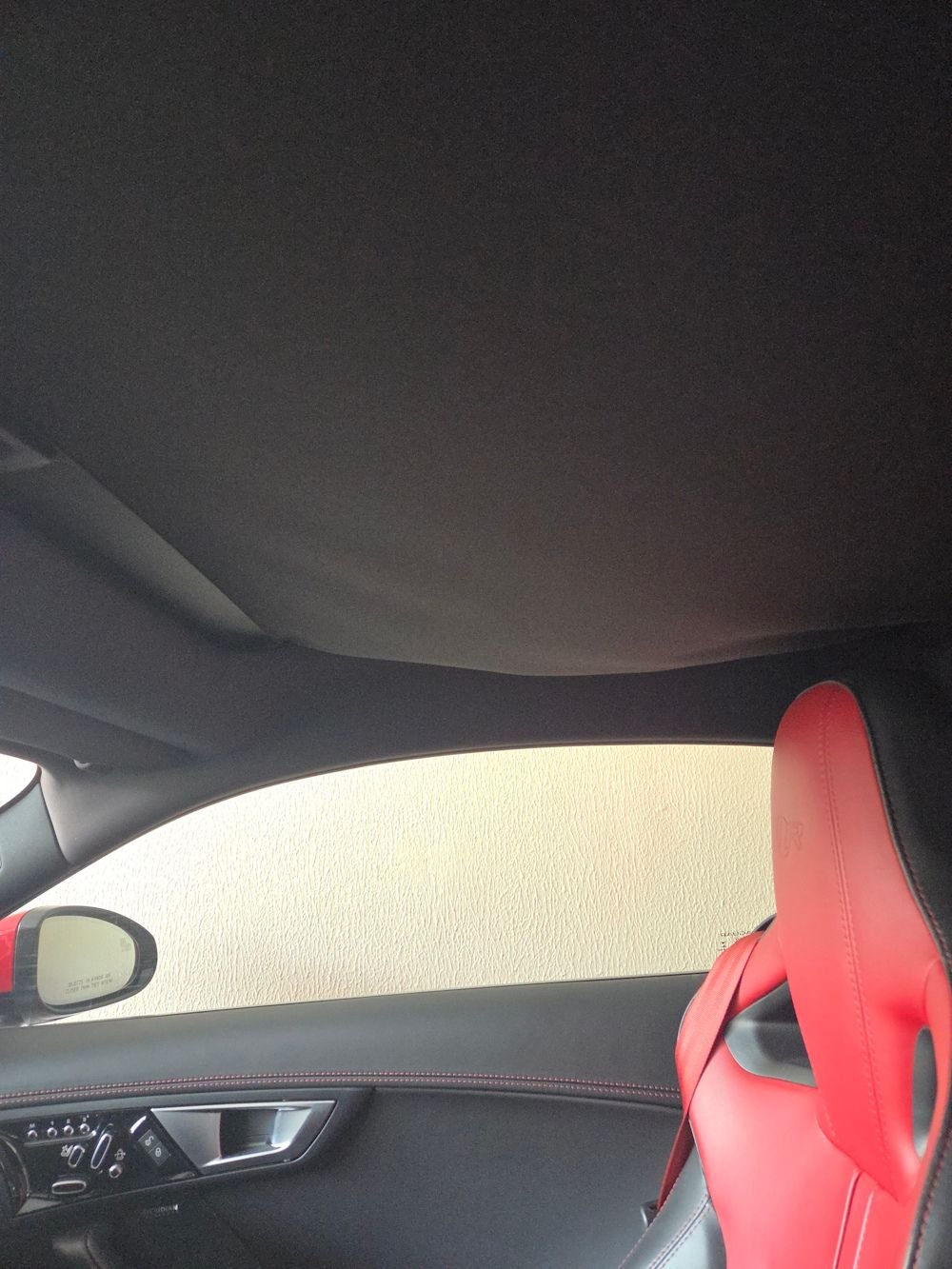

Hi all,
The slider of my 2016 F-type R is sagging from one side. Upon inspection, the glue which was holdiing the fabric dried out. I asked the dealership service center for a fix, and they quoted $4300. They said they can't fix the slider alone, they will replace the glass roof, headliner and the slider.
Did anyone manage to fix this issue, or at least make at least less visible.

That is incorrect. The sunshade is available separately. Part# T2R36223.

Is that part number for the frame only? Drawing is somewhat ambiguous.

I actually looked into this when looking at a car last year - it can certainly be replaced, but you need to remove the headliner, which means removing the side windows, and a few other things. If you have the time and technical competence, it shouldn't be a big deal!

Is reglueing it an option? Maybe using a hypodermic needle filled with glue to get to hard to reach places?

I installed the headliner in my 69 e and did use the hypo technique for a few areas that didn't glue. These were maybe 4x4 inch spots. I don't know that would work with the much larger area that the OP has to deal with.
The related thread has some photos of the inside and how the swap was done. I think I will check the glue on my Pano roof panel to get ahead of any loose areas that think they want to let go.

If you up one level it says that the sunshade included. https://parts.harperjaguar.com/v-201.../body--sunroof

Yup, assuming that your headliner is in good shape, that's all you need (unless there are misc hardware bits you're missing or that need refreshing).
You can find these second-hand as well for under $1000 USD.

One side window, anyway, so the headliner can be removed from the cabin. I recently dropped my headliner for other work but did not go as far as full removal, so left the windows in place. It was a pain, but would be less so the second time. Not that I'm in any hurry to do it again though. There would need to be a pretty good reason. I did not look to see how hard it would be to replace the shade, but I can't see removal of the roof glass as necessary.

I had exactly the same issue occur on my 16 R. The dealer quoted me about the same price even though the parts are not that expensive (this did not include replacing the glass roof -- not sure why your guy is saying so). The dealer also gave me an interior guy who they use for some jobs he came in about a grand lower. Might be worthwhile to check out some local interior shops.
