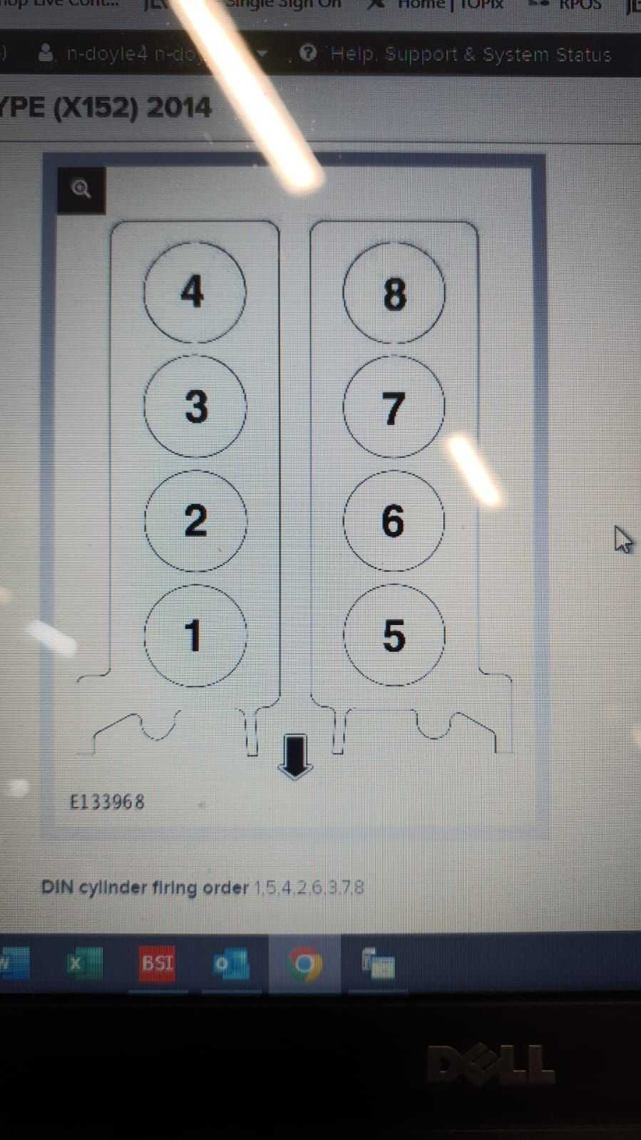

The Jaguar parts guy sent me this, it's not the firing order but CYL layout. Can anyone confirm this 100% for me please.

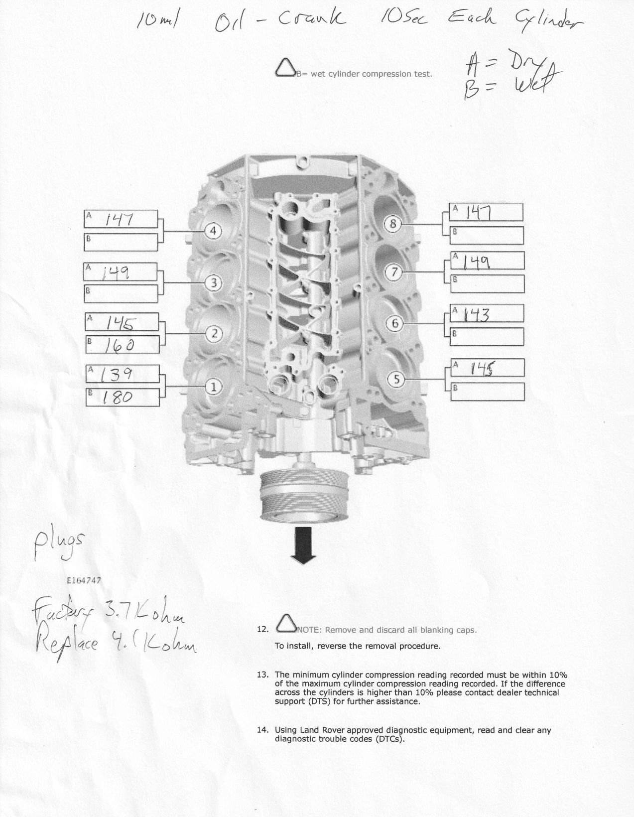

Well I still get confused on this sometimes? Lot's of variation.

Here is the worksheet from the service manual when I did the compression test on my 5.0L SC engine.
As I posted above what I use is when sitting in the drivers seat. The LH cylinders are even and the RH cylinders are odd.
Not sure I answered your question?

Yup ok cool, so I was working on the correct cylinder then
