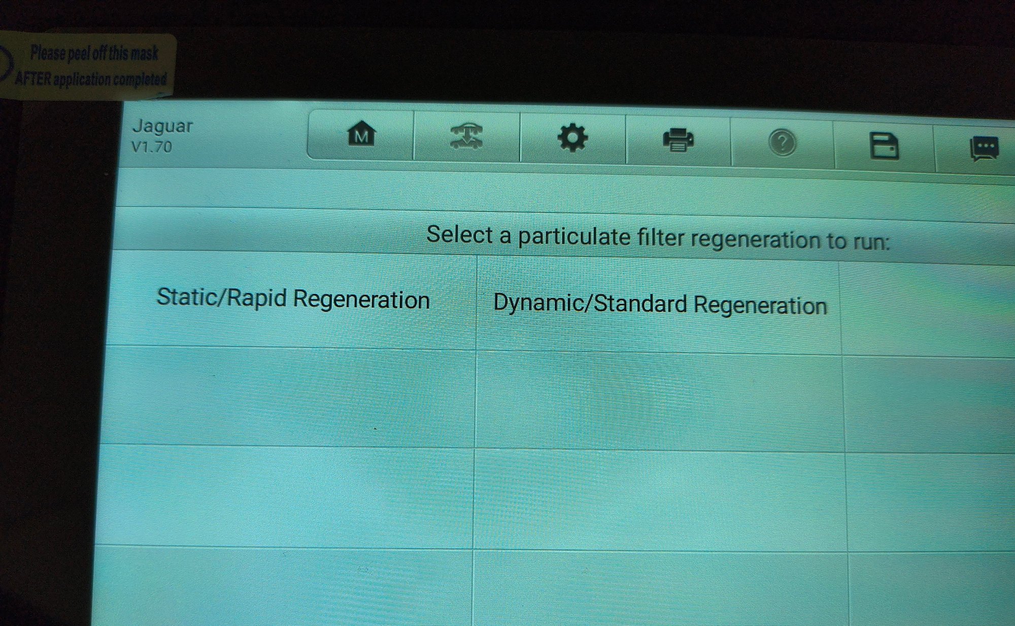

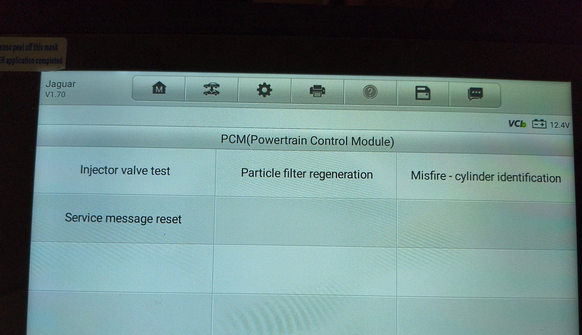

Old Jul 18, 2025 | 01:56 PM
  #60
TxDriver23's Avatar
Joined: Jun 2025
Posts: 50
Likes: 13
From: Texas
Originally Posted by DMeister
I found at least one scan tool from Launch that claims to be able to trigger a regeneration on both DPF and GPF, but I’ve yet to confirm specifically that the GPF function will work on the F-type.
I just looked at my Otofix diagnostic tool and decided to keep my fuse out for now. I have a 2024 car. I'm not sure if this will work, but I'll try to run the "Standard Regeneration" option every 3000-5000 miles.
Here are a few screenshots of the options presented in the tool when navigating the service section of the tool.
Other options presented in the PCM service menu.
Notice received after selecting particulate regeneration regarding the two options.
Again, I will probably run the Standard Regeneration option every 3,000 - 5,000 miles unless the warning light is illuminated.
In all honesty, my F-Type is a third car, so getting above 5,000 miles each year will be a challenge for me.
