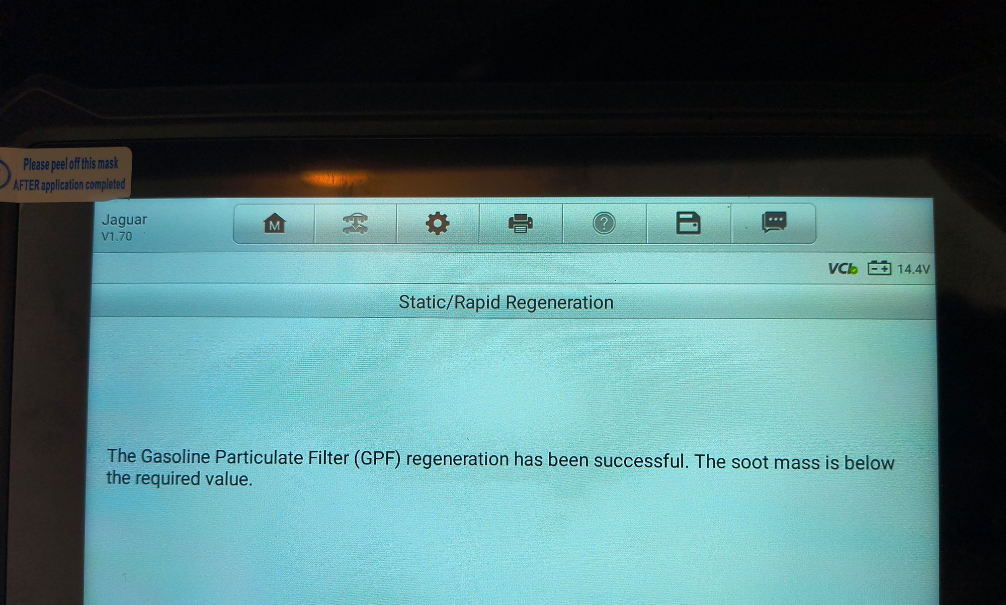

I sat out to run the regeneration today and I have to say there's gotta be a sensor somewhere reading the "soot values" without displaying anything. Again, my car is brand new, so the test completed almost instantly. A car with more miles would definitely return different results.
I started the car and it let the temperature reach 80 degrees Celsius and it was over before I knew it.
Took about 3-5 minutes to reach the desired temperature.
I can report that I received the same results with or without the fuse seated. Also, the same results were returned doing the standard test while driving.
I guess I'll know more after I get a little build up going.

So, were you ever able to find a function that would tell you when the last regeneration was run, the number of them that were run, what the current soot build up is etc? My understanding is that there should be a way to see these sorts of things concerning the GPF.
So to be clear, you ran both types of regenerations with and without fuse 15 in? When you started the regen for the static one did it raise the rpms up and make it very obvious that it was doing it etc?
I find it interesting that it still succeeded with the fuse out? Would it not make sense that the scan tool should have failed to get the regeneration to run when fuse 15 is out, just like the ECU is supposedly failing to initiate a regen if fuse 15 is out (according to Paul Busby and company)?
Thanks for reporting in about this stuff.

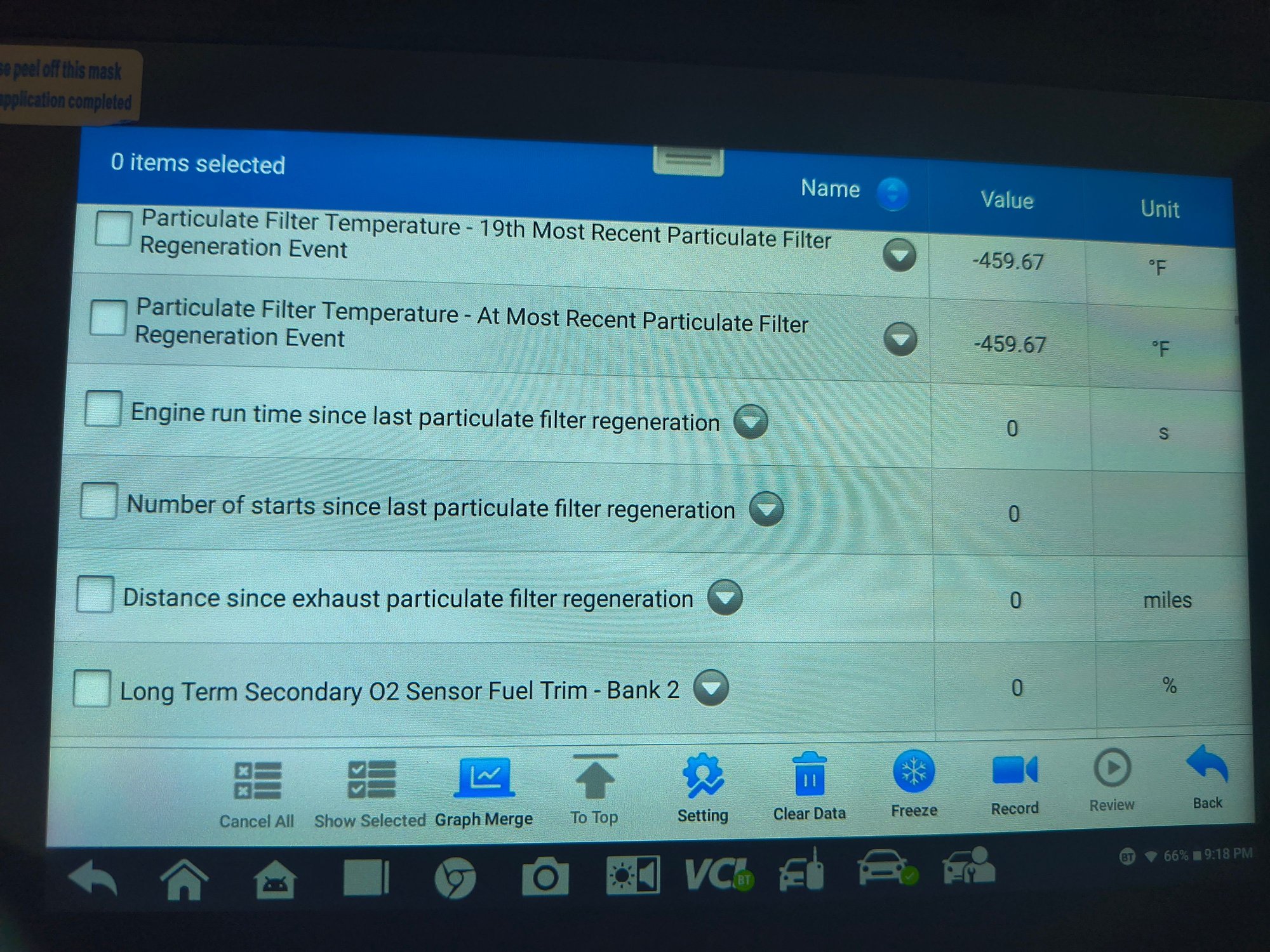

No problem reporting this. I hope it helps someone somehow.
I can actually the particulate filter status when I view live data, but again, my car is too new. And here it depicts a mileage count since the last regeneration was run.
Lesson learned. But I'll develop more trust in the tool after I view data from another vehicle. I've got an XE outside but it's a gas model and doesn't have the filter.
I probably should have viewed this data first.

I've got a whopping 477 miles. 😂😂. I know...I know.
I heard a very slight throttle increase... similar to going into Dynamic mode. Same with and without the fuse present.
I honestly don't think it did anything at all. The soot mass value is too low for my car.
