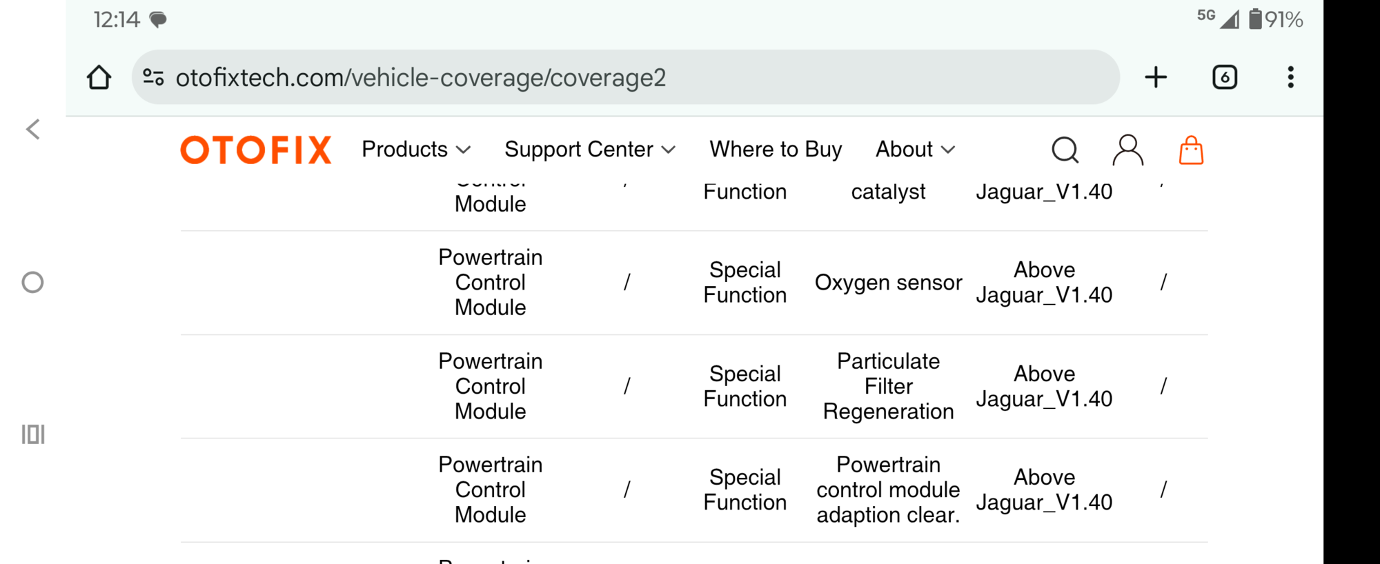

Originally Posted by TxDriver23
I have the IM1 which is primarily for locksmith work, but on the Otofix site, the D1 Lite tool is listed to perform GPF regeneration with Jaguar software 1.40 or higher. I'm currently running 1.70. The D1 Lite is listed on their site for $319.
You can alao find them on sites like aliexpress for a bit cheaper. I never looked at Launch, but I think all of these devices are made in China and sold under various names with one group supplying the software.
I'm not sure if it's required, but for my model, an internet connection is required to get anything done. That may be solely for cloud access to immobilizer data.
I'm going to run the rapid test one day this week just to see how long. It actually takes and if it will drive my neighbors mad. I had problems on the block while running a transmission fluid flush on my Corvette before changing the filter. I expect this to last much longer.
Point of interest, I went on the Otofix website and looked at coverage for the D1 Lite unit and searched with "particulate" for the jaguar F-type and it only came back with diesel particulate management being supported 1.40 and above. Not sure where you saw that this model supports gas particulate filters.
Perhaps only the higher end model does? or it does with 1.70 running on the D1 Lite? But I can't really tell for sure from the website necessarily.
Clearly it is supported by your higher end device based on your screen shots literally saying gas particulate filter.
I notice that now. When I filtered, I didn't catch that diesel was specifically called out. I only saw "particulate regeneration "
Here's a screenshot from their site.
Yeah, but it could well be that it actually will with the 1.70. To know for sure someone would need to contact them.
Just wanted to point this out in case there is an issue, and someone were to order it thinking it was for sure good to go.
I'm going with a Topdon product myself that I have confirmed can do the business.
