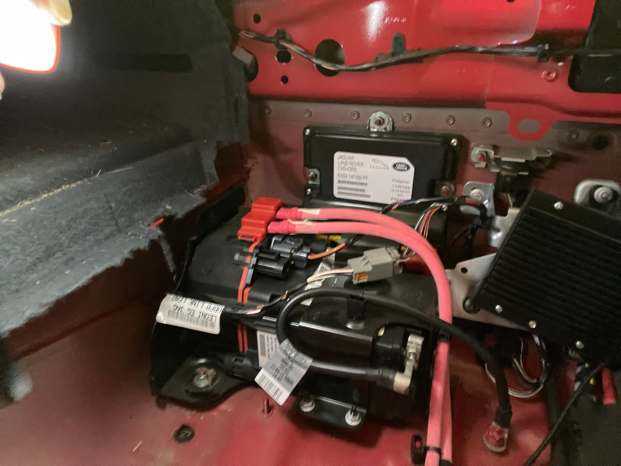

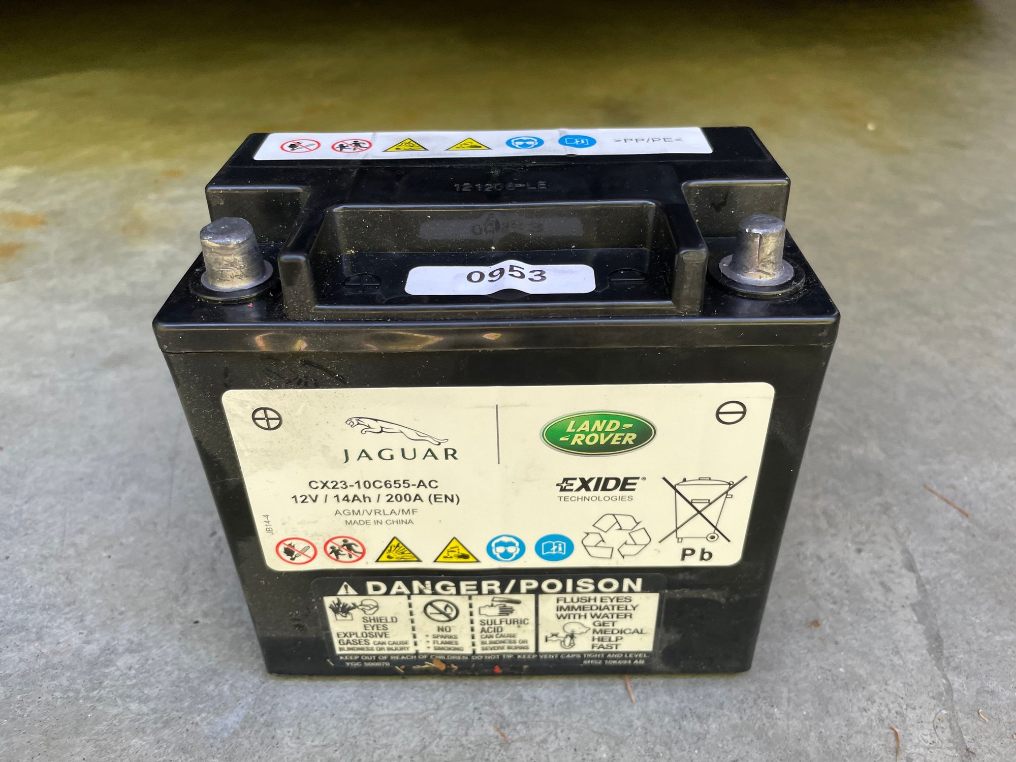

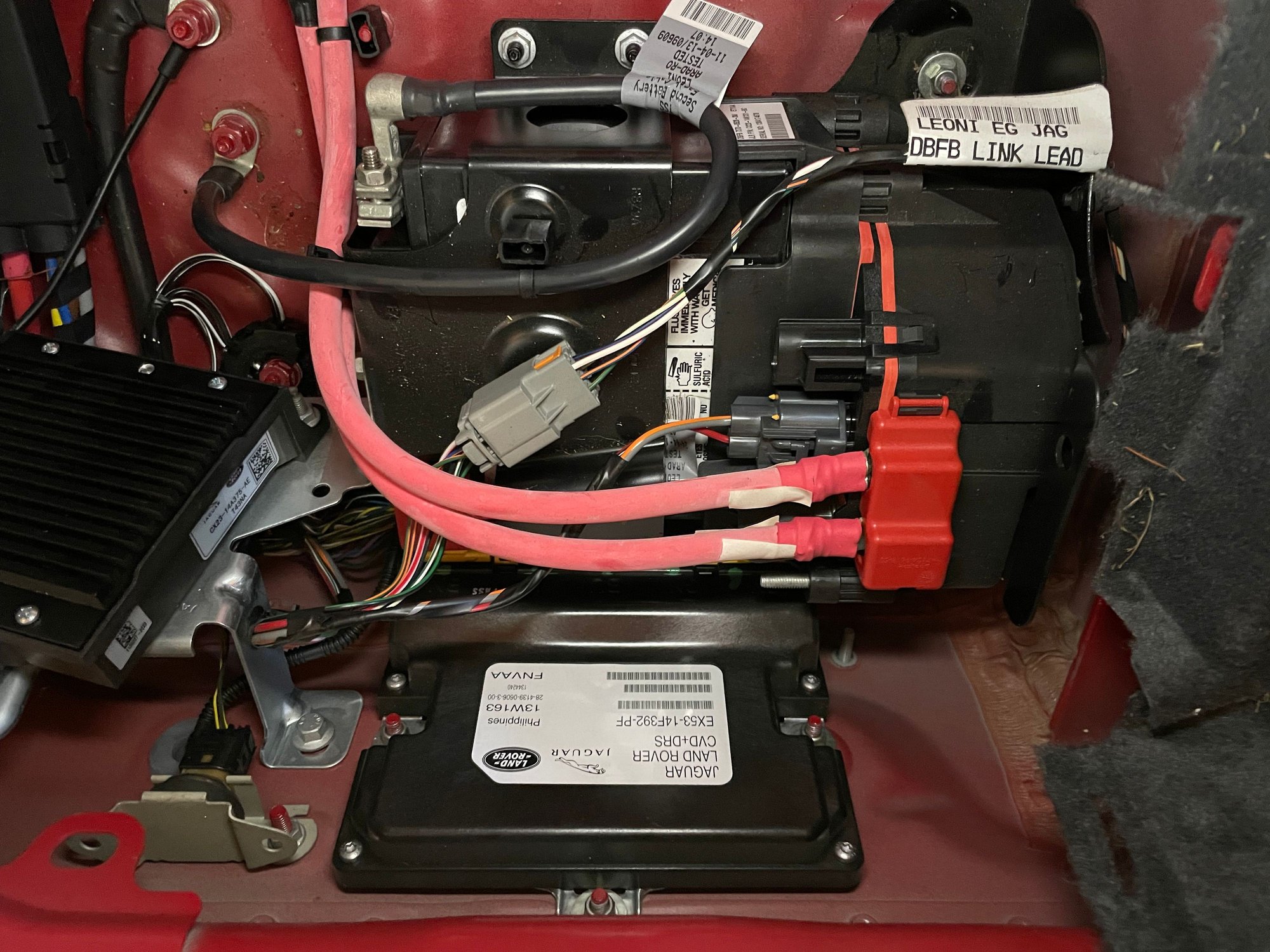

Took a while to find these, from when I removed the battery in 2021…
From the front of the trunk, looking towards back right corner of the car
From the front of the trunk, looking towards the back left corner of the car from this perspective
Looking down at the battery

Thank you for the pictures, they do help.

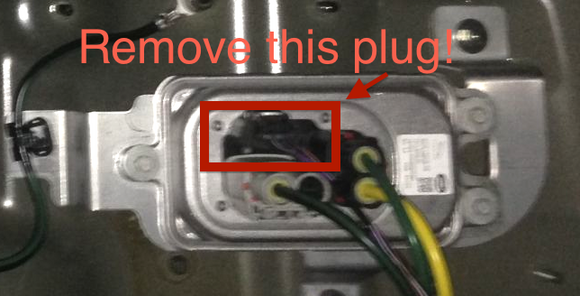

The module is in the trunk space under all the trim and compartment covers. Sitting right on the bottom of the trunk floor. I think this covers post dual battery cars up to the facelift cars.

I've done it, I switched on the ignition without starting the engine but the start-stop disable light didn't come on, also the disable button was lit all the time.

Need to complete the cycle. Start/Stop wasn't available for a couple minutes after startup anyways. After the motor is running it determines if the car has enough volts available to enable Start/Stop. It will decide it doesn't because you've unplugged the module and it doesn't "see" the voltage. Same as having a car with an older battery with less capacity.
