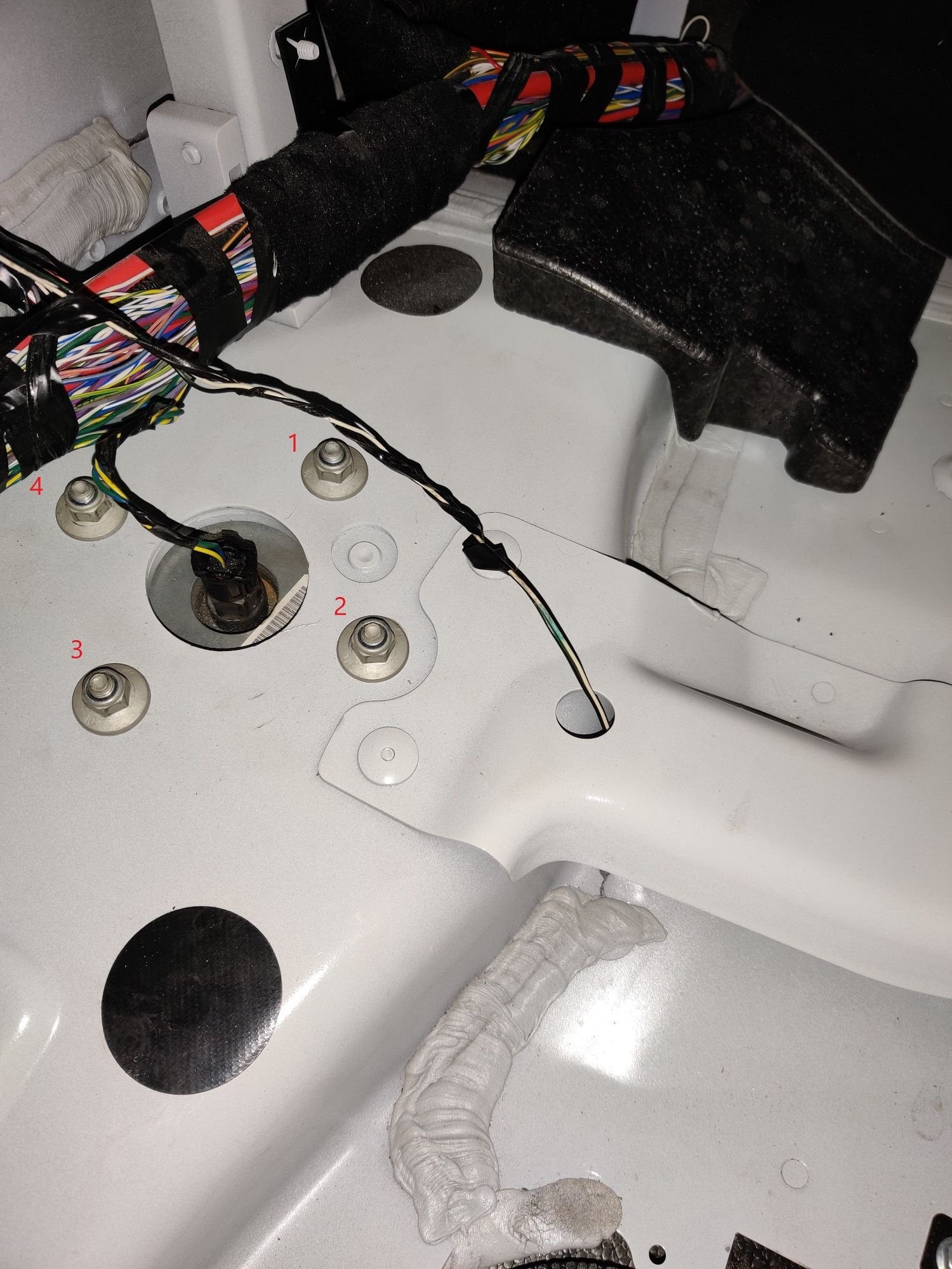

Hey guys, lowered my ride on VAP lowering springs and been having a clunking noise coming from the rear left suspension area when going over any bump and dips(front left, front right and rear right are perfect). Been trying to identify the cause and after checking many many things it is still there, I will be taking it apart tomorrow but would like a few questions answered to pin point the problem.
I'm suspecting the culprit is the lack of spring isolator. Contrary to my reply in TheRock's DIY thread, my installer did not transfer them to the new springs, I wrongly assumed they were on the strut and only realized when I picked up my old springs.
So just in case fitting them doesn't fix the noise, my questions are:
1a) can the strut be mounted "wrong"? See pic, if bolt 1 were reinstalled to where bolt 2 was, is it wrong? My installer didn't leave mark as TheRock suggested in his DIY.
2) What is the torque spec for the strut tower nuts and the strut center nut? I checked and they were tight but not sure how tight.

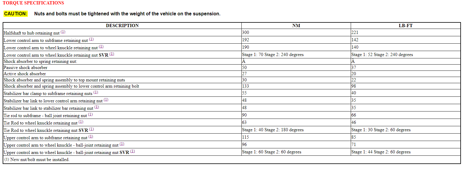

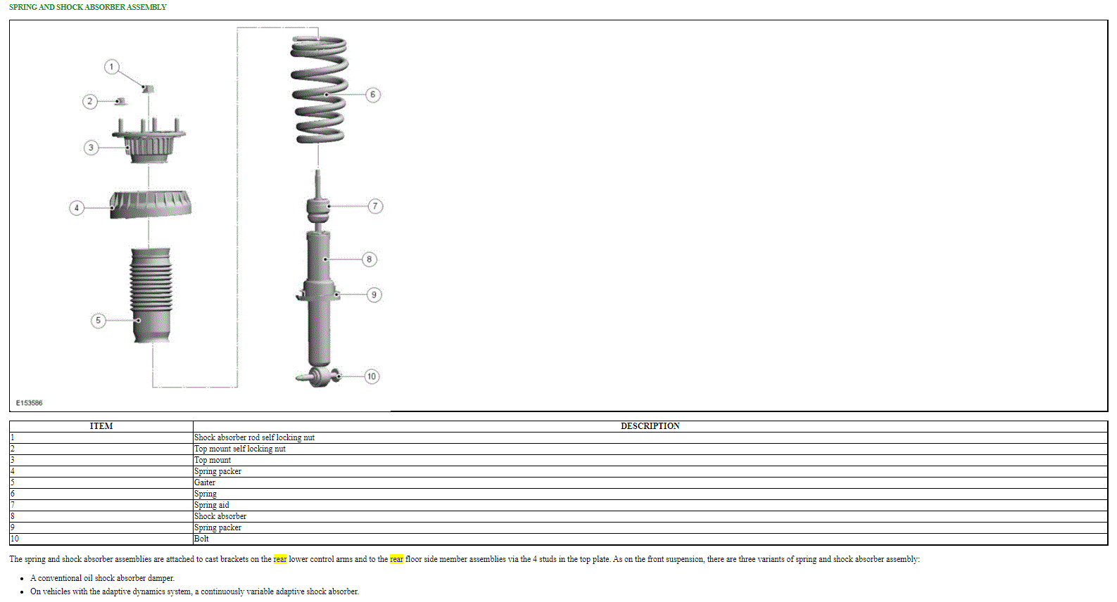

I think your issue is definitely going to be the missing isolator/pad. I like to keep the same orientation, but likely rotating it a bit will be OK.
The torques are below and image with parts and orientation.

Thank you so much DC, I'm heading to the shop now. Good to know the active shock center nut requires only half the torque of passive shock, mine is probably over tightened.

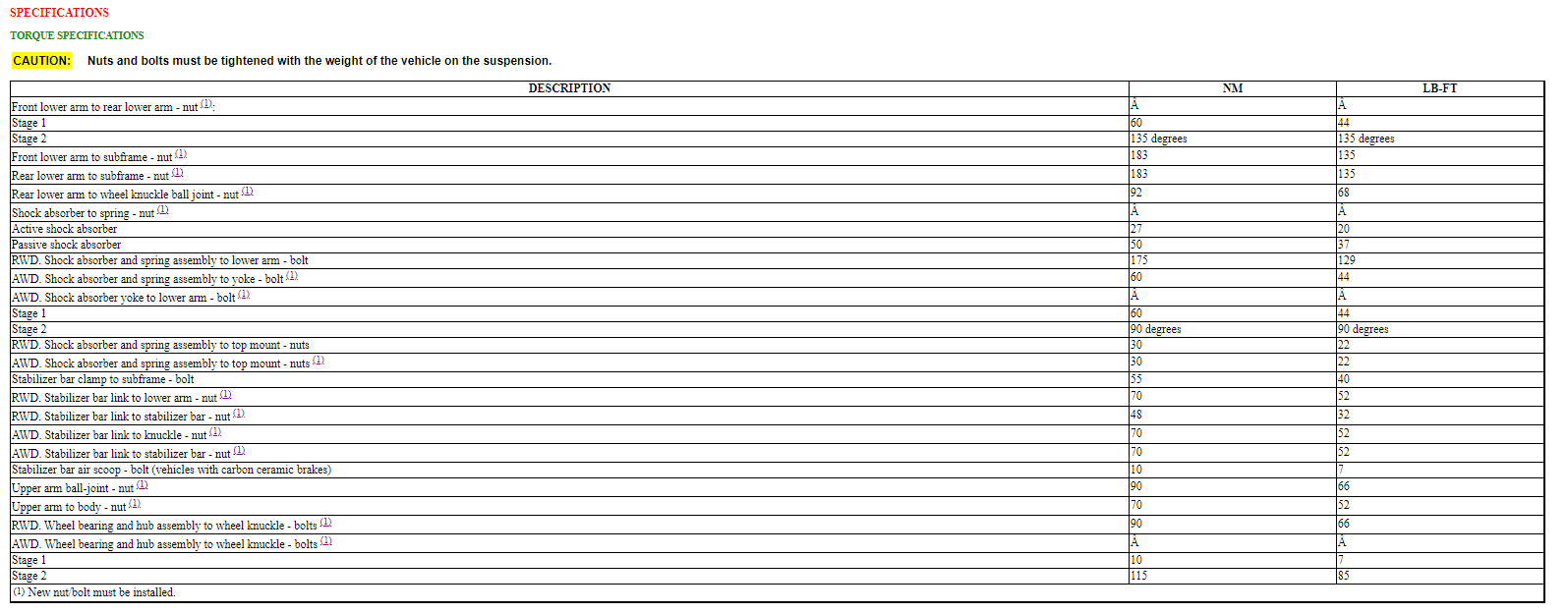

Do you have the torque spec for the front? Might as well check em all.

I'm glad to report back that putting on the spring isolator have completely fixed the issue. There were no obvious signs of other installation problem and i can answer my own question #1 now, it does not matter which bolt goes into which hole.

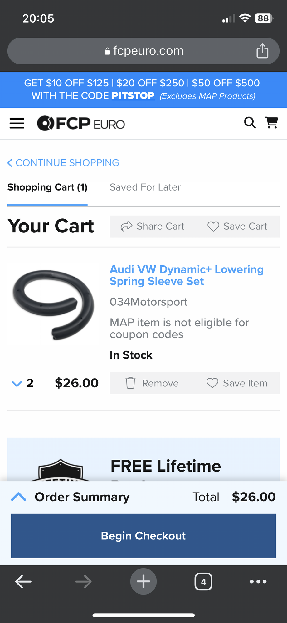

Guess i will try that. i will let you know if replacement fixes the issue, going with these, getting 2 pairs just in case, would be really dumb to be hit by the same issue 3 times 😂

I vaguely recall a few years ago others reporting "spring bind" (or whatever it's really called, clunking from when the coils of the springs hit each other) with H&R springs, and that those spring sleeves fixed the problem.

New Spring insulators installed, added one extra loop per side, no more clunking, these damn rubbers should be standard on lowering springs!
i can also confirm there is a washer on the shock shaft, but it’s more like a metal sleeve with a flange on top, not something that’d be easily forgotten when you put things back on.
