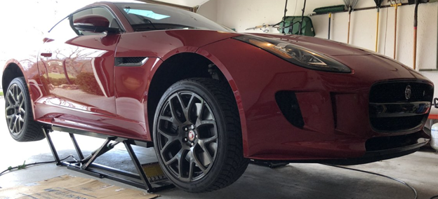

Hi RGPV6S, I did see where you posted... "I have the BL-5000SLX model and find it to be fine for working on my F-Type and other vehicles for the last two years. I don't feel it is too short at all.” But I could not find any photos from you.
In another thread Nait wrote... "This is the 5000-SLX model. Do note that the fore and aft lift points on the F Type are at the absolute limits of these frames. Honestly, the optimal spots are about 1-2" further apart than these frames allow, but I think it still reaches suitable spots." and he shows a clean lift...
J
JasksonvilleJag writes about the 5000-TL…"I angled the fronts in to align with the correct lift points.” And he posts this photo where it looks like the two jacks are not in parallel…
I asked him if he has done a full lift with the jacks set like this, but I’ve not heard back from him.
Old May 5, 2022 | 05:34 PM
kb58's Avatar
Joined: Apr 2022
Posts: 491
Likes: 142
From: San Marcos, CA
Anything other than parallel with this type of lift "can" be a problem. How much a concern it may be is directly related to how non-parallel they are. The amount the load shifts is something like: Cos(angle between ramps) x Distance between lift points. The lifts can likely put up with "some" sideways movement, but how much very much depends upon a bunch of stuff we can't know. Best case, people here step up and say they use them all the time and they work fine, otherwise it's kinda sketchy. BTW, an alternative way, and much safer - if you have the room - is to orient the lifts sideways. The car will shift as it goes up but with this arrangement there's no issue about it sliding off one of the lifts.

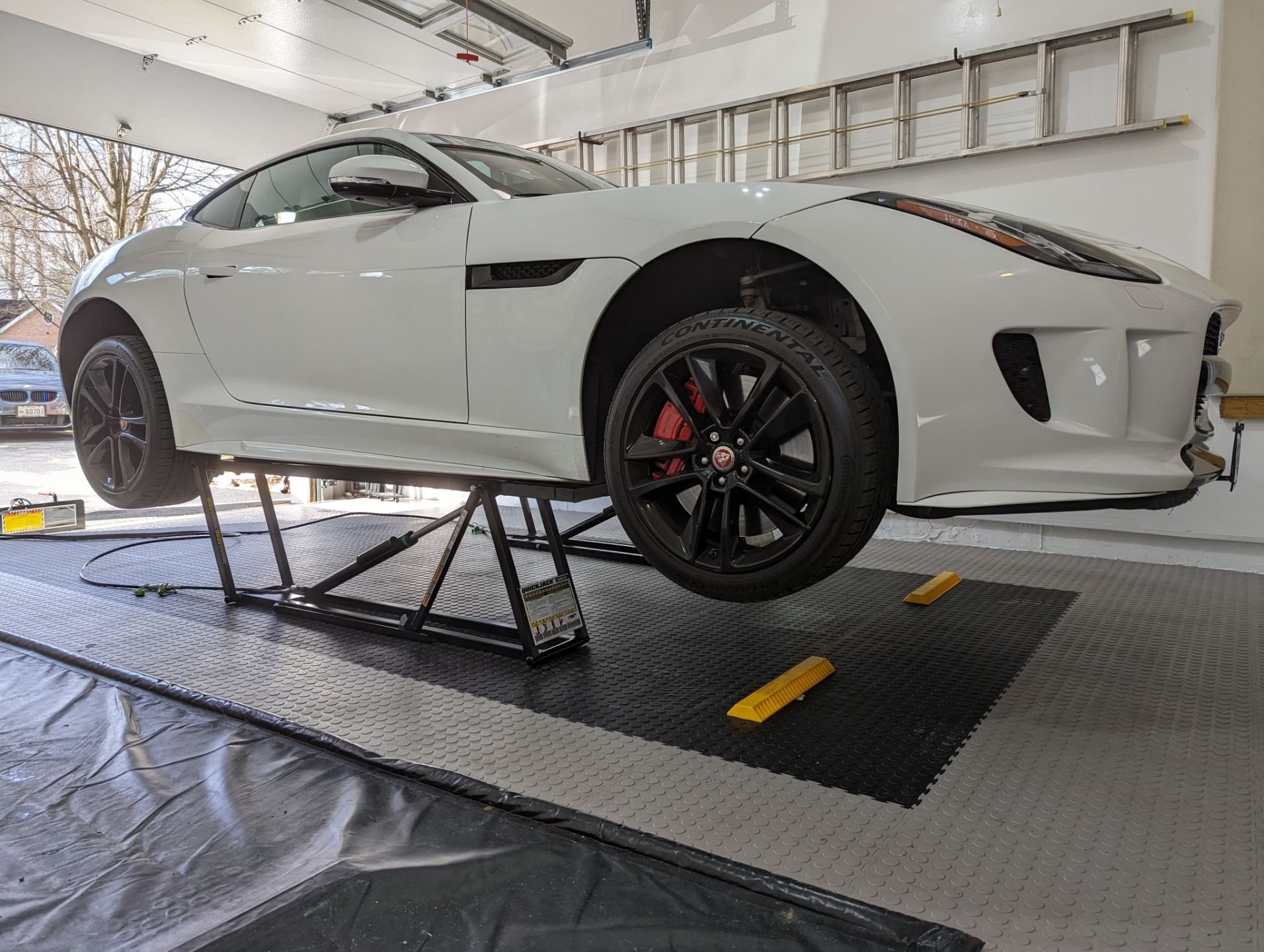

A little late to the party. I had the original QuickJack BL-5000 (circa 2015) which has a maximum lifting spread of 60" and was way too short for the F-Type so earlier this year I ordered the new 5000TLX frames (still using my original pump and hoses). The 5000TLX is the perfect size for the F-Type and lets you reach the recommended lifting points with ease. The maximum lifting spread is 76" (vs 70" for the 5000TL). The extra 6" doesn't sound like much but it makes a world of different when lifting cars/trucks/SUVs that have defined lift points or long wheel bases.

Sorry, you're correct. For some reason I was thinking of the overall frame lengths, not the lift point spread. The original BL-5000 had an overall frame length (when collapsed) of 69" and the maximum lift point spread was 50.5". The 5000-TL frame length is, as you said, 70" when collapsed and the max lift point spread is 60" and the TLX has a 76" frame length spread and a max lift point spread of 66". The frame lengths are good to know in case you have a shorter wheelbase car and want to know if the frames will fit between the tires when collapsed.
BTW, you could always stick with the 5000-TL and if you find it too short, purchase the frame extender kit. They lay on top of the frames and add an extra 6" to the length while only adding an additional 1" of height.
Old May 15, 2022 | 10:45 AM
jlewis10's Avatar
Joined: Jan 2021
Posts: 62
Likes: 6
From: NE Ohio
FWIW, I have the TL. It's a bit of a pain to get situated (could really use a few extra inches), but it does work. I have also used the lift horizontally so the jacking points are even on the front and rear, but that's not much easier since our cars are so low to begin with, it's kinda hard to see no matter how you do it. You'll be fine with the TL, I wouldn't bother with the hassle of returning.
