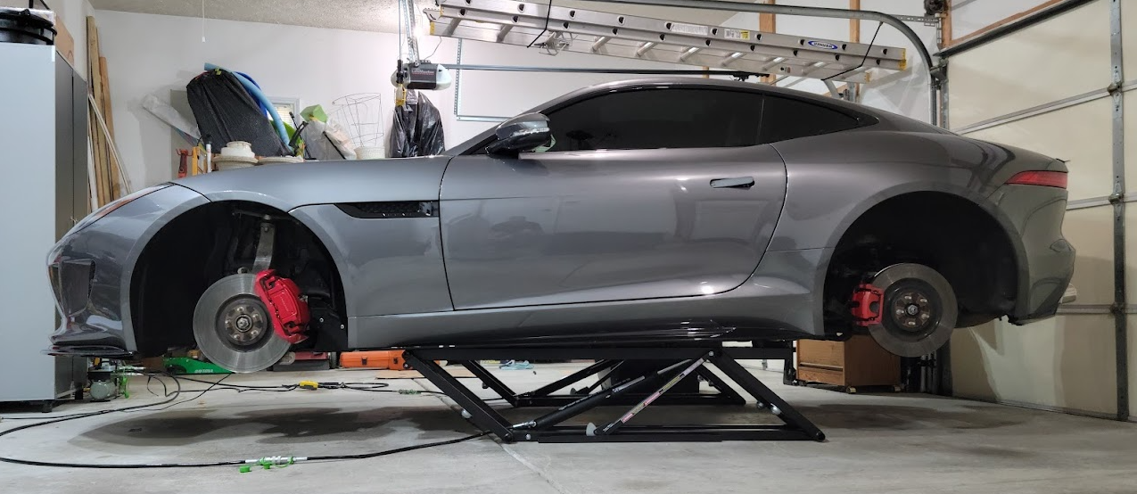

Don't have that model but a BL-5000-SLX. Works fine as long as you make sure you follow the initial bleeding instructions.

I'm not into big trucks or SUVs so the 5000 was enough for my needs. I found the lift height fine for the stuff I have used it for: Crank pulley, brake flush, diff oil change, change brake pads. On other cars tire rotation, oil changes, brake jobs, etc.
The only issue is for doing things in the middle of the car like O2 sensors since the jacks block side access. I know you can use the jacks the other way but never tried it.

Yes you can but I am old and stiff. Plus the creeper does use up some of the headspace between you and the underside of the car so I that would be an advantage of having a higher lift capability.
BTW if I am going to going to slide under the car between the jacks I set safety jacks under one end of each jack just in case the jack lock slips.

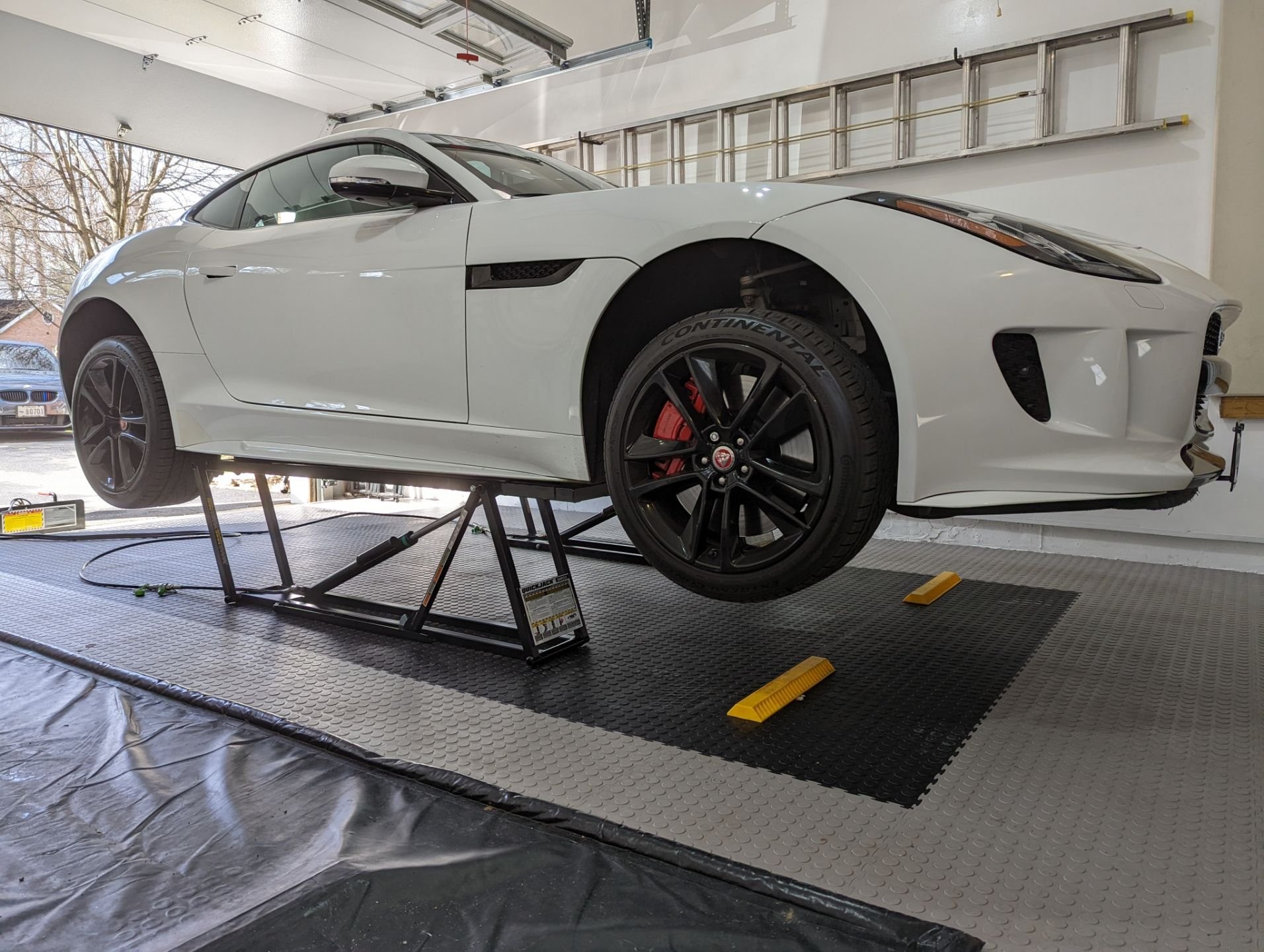

I have the QuickJack 7000 TL and use it all the time with my F-Type. It's a little heavier than the 5000 so a little harder to maneuver into position. I added some steel ball rollers that allow me to roll it into position rather than having to slide it across the garage floor. Here is a good thread with options to make moving them around easier - https://www.corvetteforum.com/forums...with-ease.html.
I chose the 7000 series for the added capacity and lift height. Works great with the F-Type and allows me to use it on a wider range of vehicles.

I don't believe the 7000TL will be able to reach the recommended lift points since the maximum lift spread is only 60". I purchased my QuickJack back in 2015 and recently upgraded it with 5000 TLX frames which have a maximum lift spread of 66" and they're the perfect size.
Appreciate your input. The 7000TL is clearly workable given Gearhead's post above...That's his F-type on a 7000TL.

Yeah, I'm sure you can make it work. My point was that the F-Type has specific lift points which are about 57" apart on center so you really need a minimum of 61" to reach them using QuickJack's rubber blocks. That's a stretch for a TL since it only spans 60" but is well within range of the TLX's 66".
