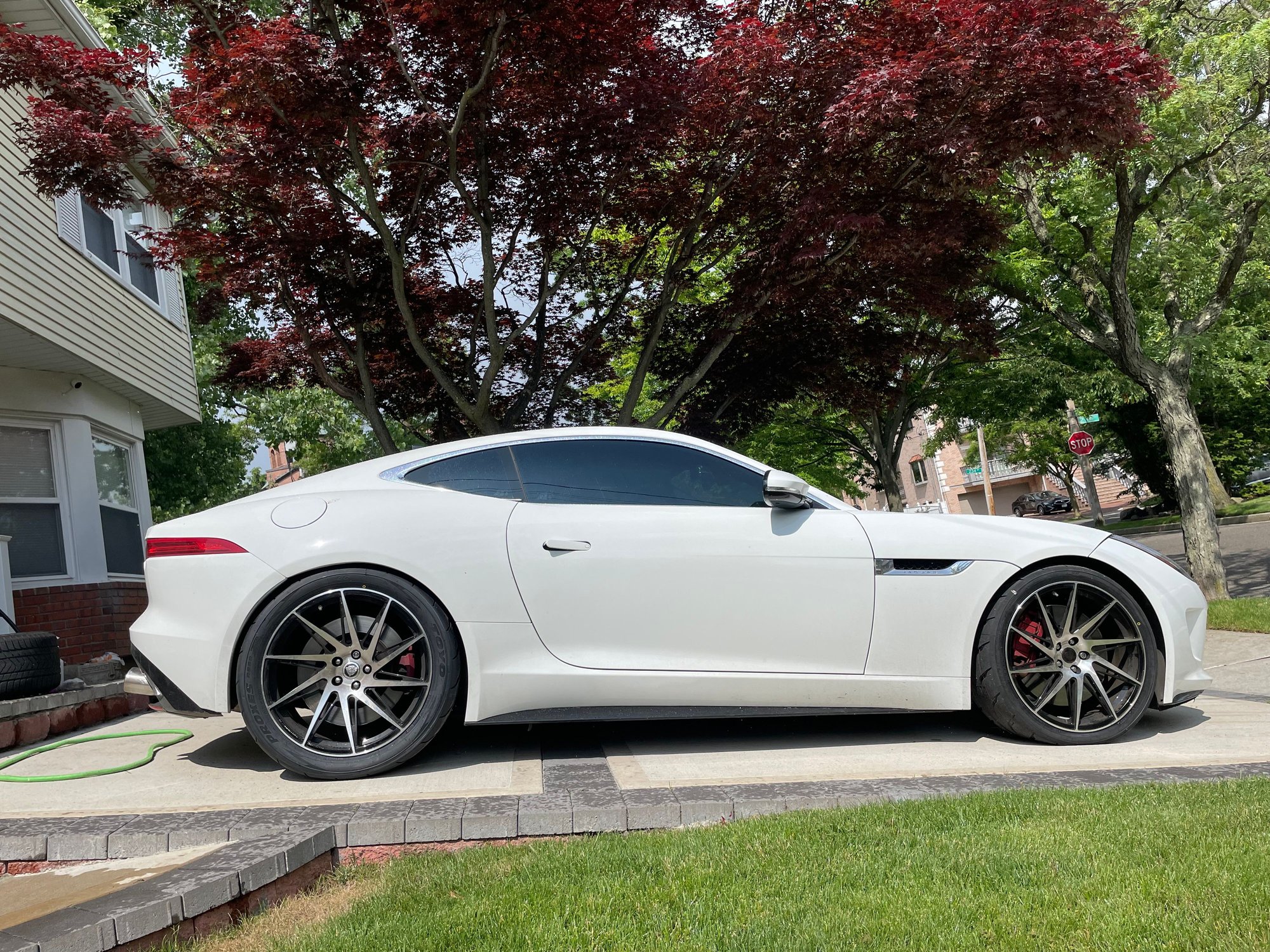

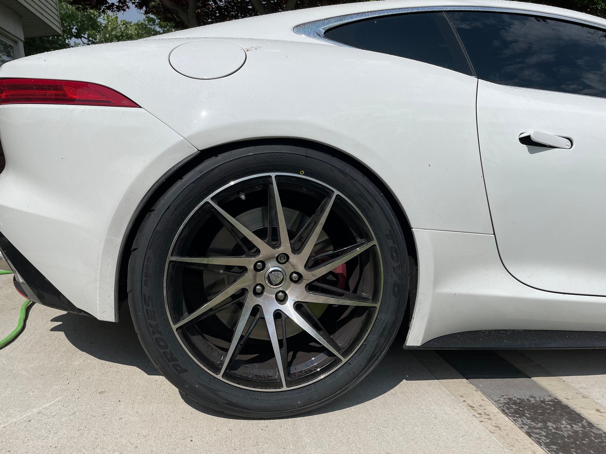

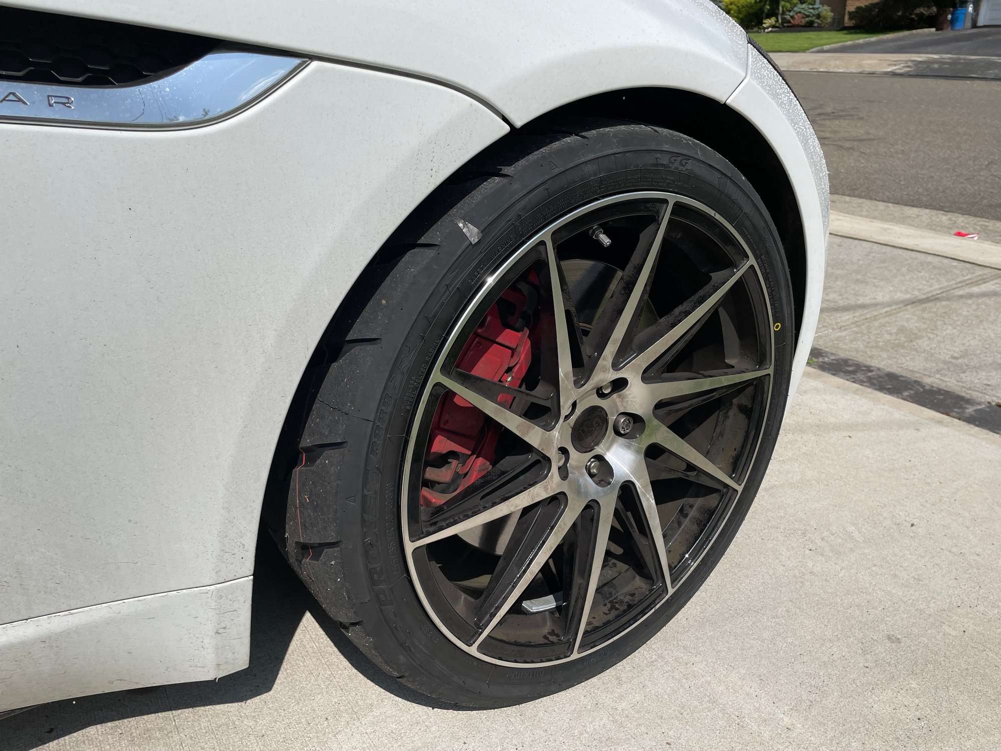

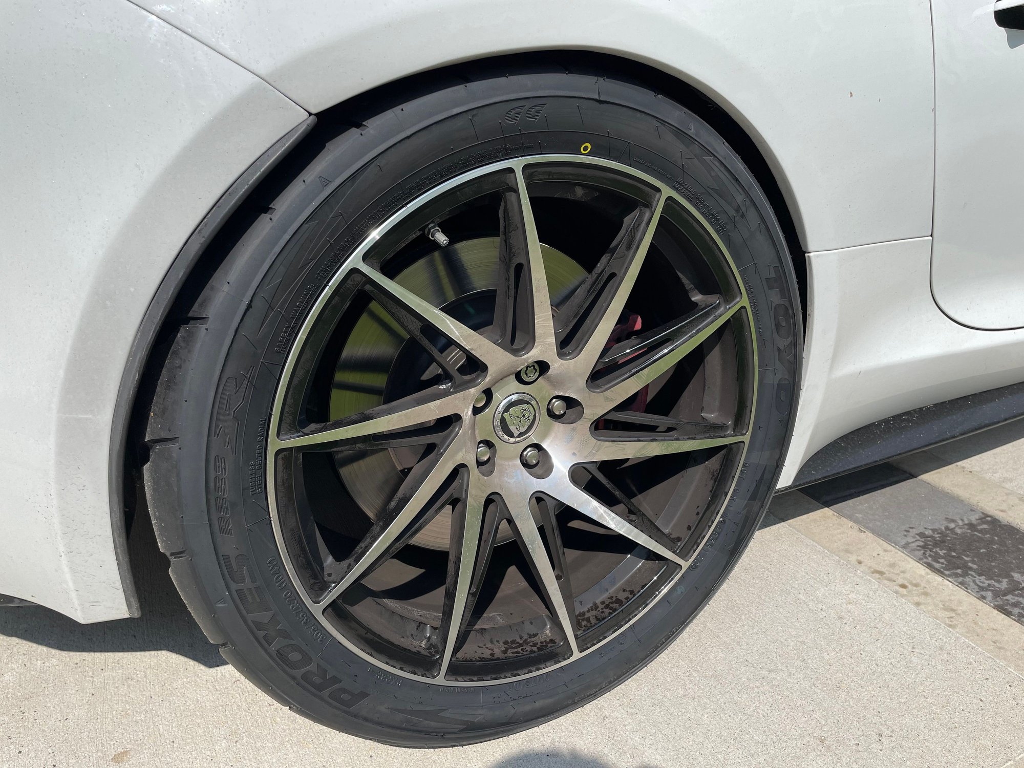

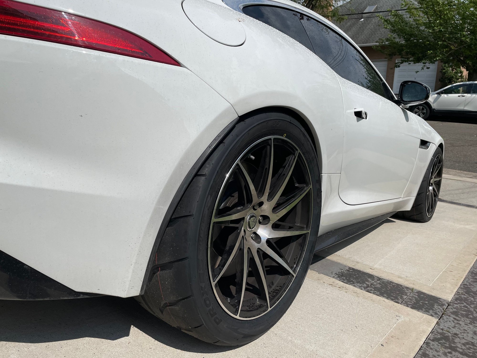

Finally installed these bad boys, I went with taller side wall on the rear and it has completely filled up the wheel well, haven't drove them extensively except the one mile trip home. Glad I didn't take it to the highway as I later found out all four are leaking air, ima check it later when the rain stops, most likely the new TPMSs are the culprit.
Loving the look on the rear so far, finger crossed they won't rub on the bumper/fender, clearance seems really really tight.
305/35/20 rear
255/35/20 front

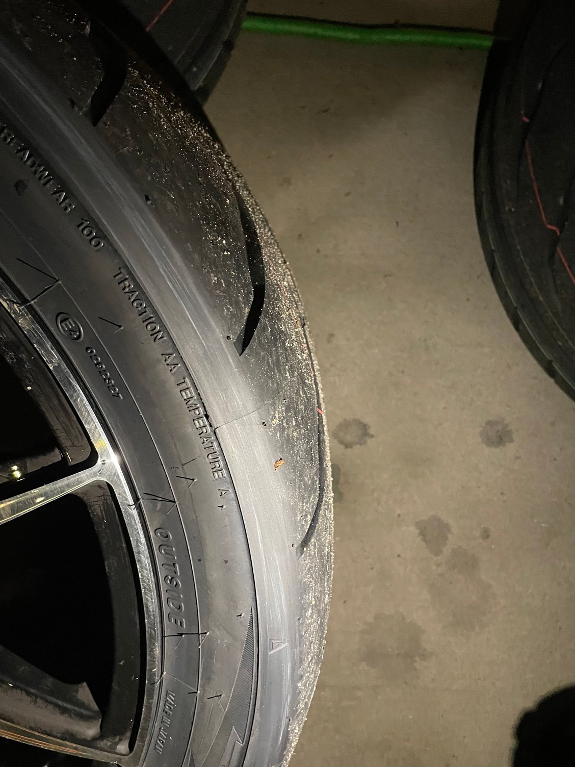

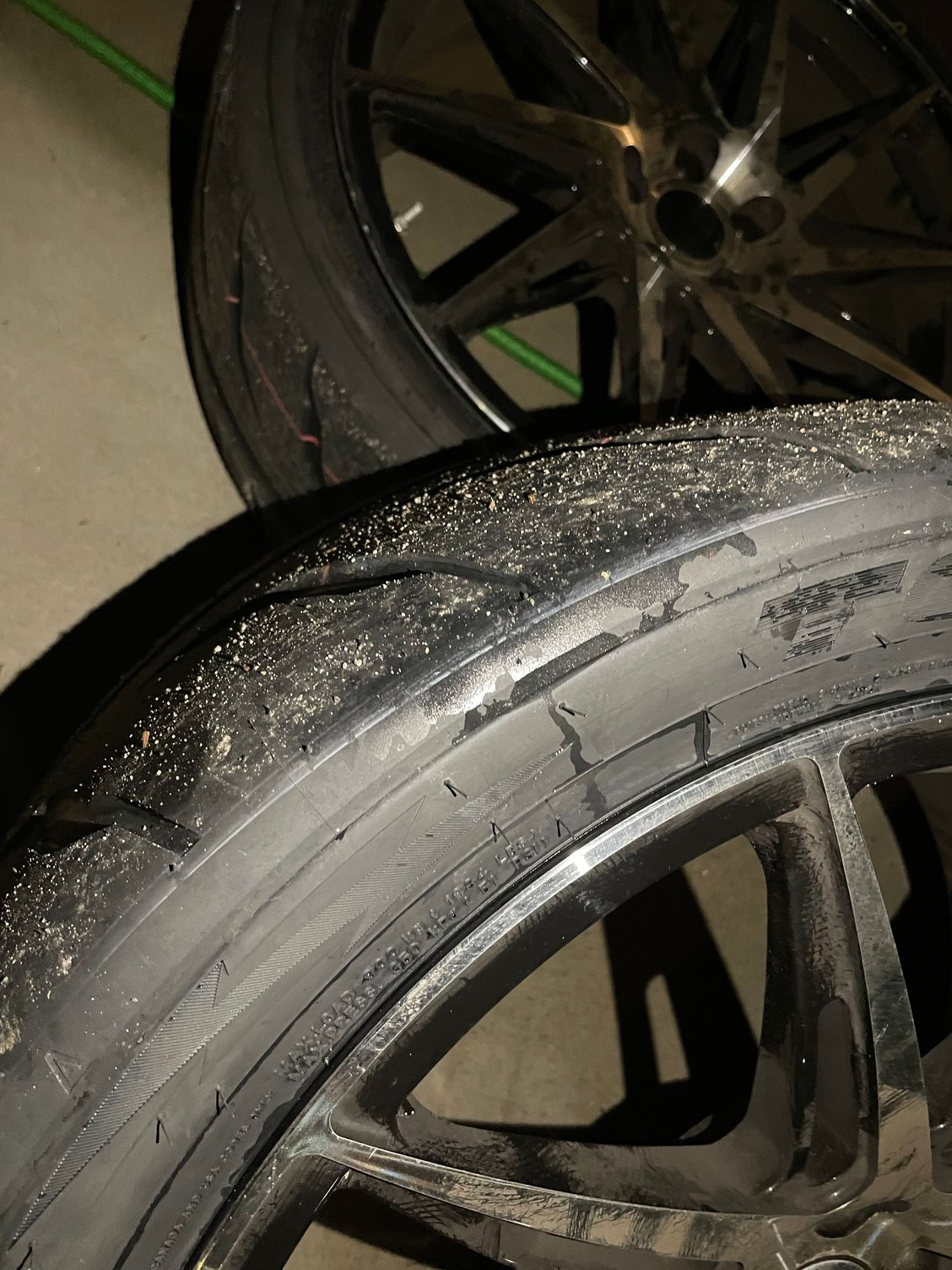

Originally Posted by mrjohnt
Any rubbing on the rears? Or too early to tell? And that’s not lowered?
Too early to tell, I didn't hear/see any rubbing on the way home, but with the pressure dropped to under 20psi I did hear some rubbing, see attached pic, visual inspection suggests its only happening on the passenger side outer side, need more mileage with proper pressure to tell exactly.
It's lowered on VAP springs.
Rubbing mark visible, the pics are of the same tire.

Got the tires fixed, tire shop says the washer between valve and rim wasn't working, they replaced it with a rubber one.
So far so good, drove about 10 miles now, slight rubbing on compression on the rear, on the inner fender lip.
Tpms doesn't work, not sure if I got the wrong or bad ones. Any special procedure to "forget" the previous sensor and learn the new one?
Currently in the shop for a brake job, they will roll the fenders if time allows. Hopefully that's all is needed.
If it still rubs, I might have to put on the stock springs for the rear.

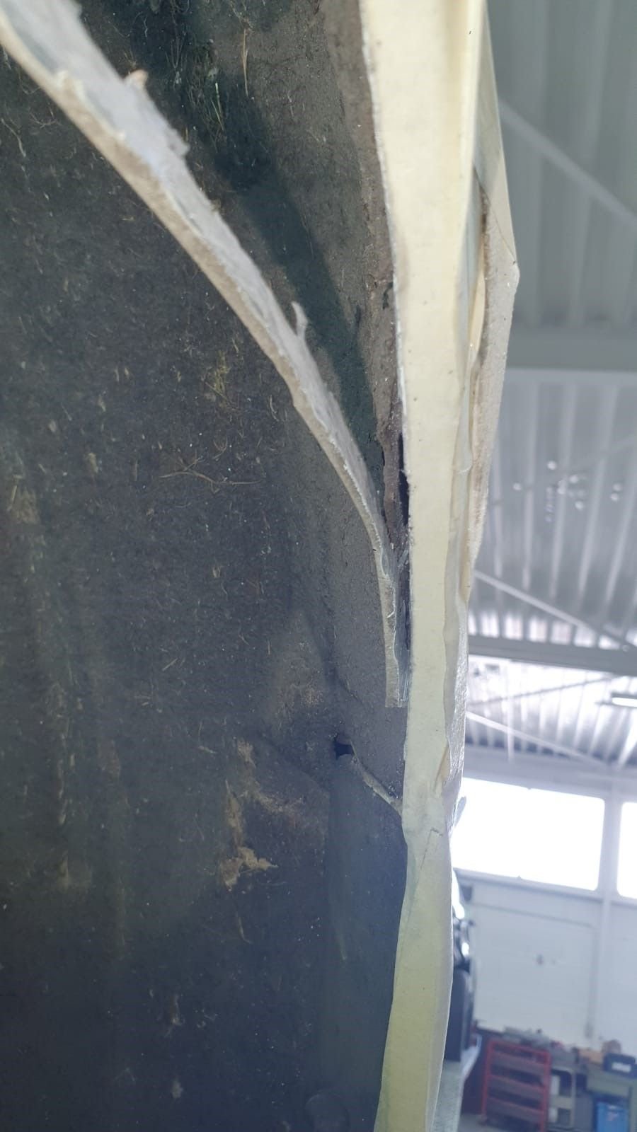

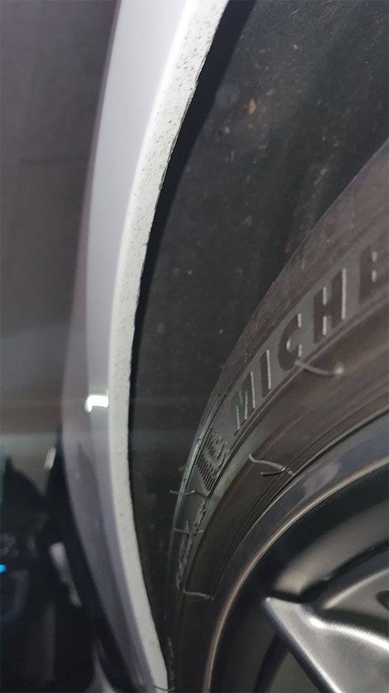

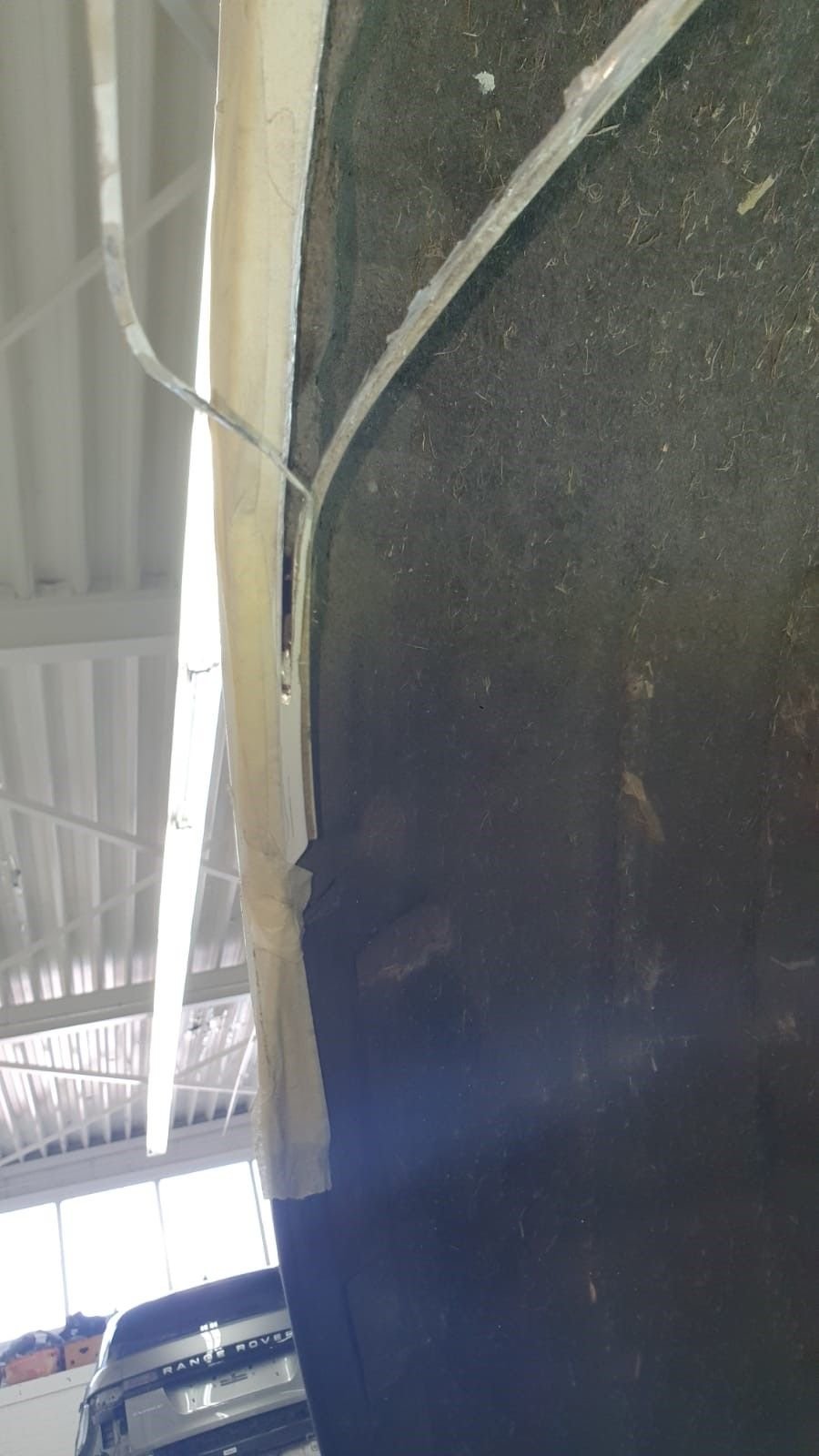

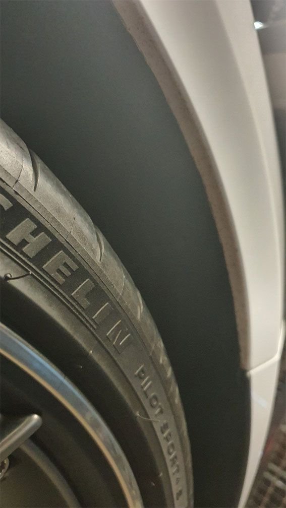

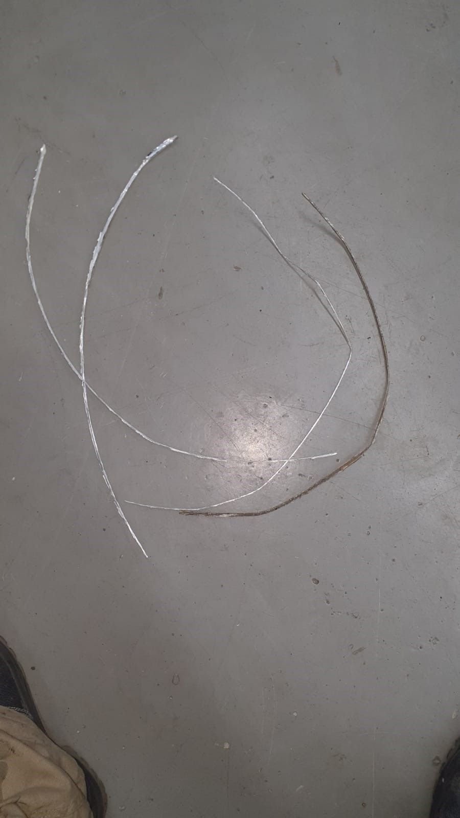

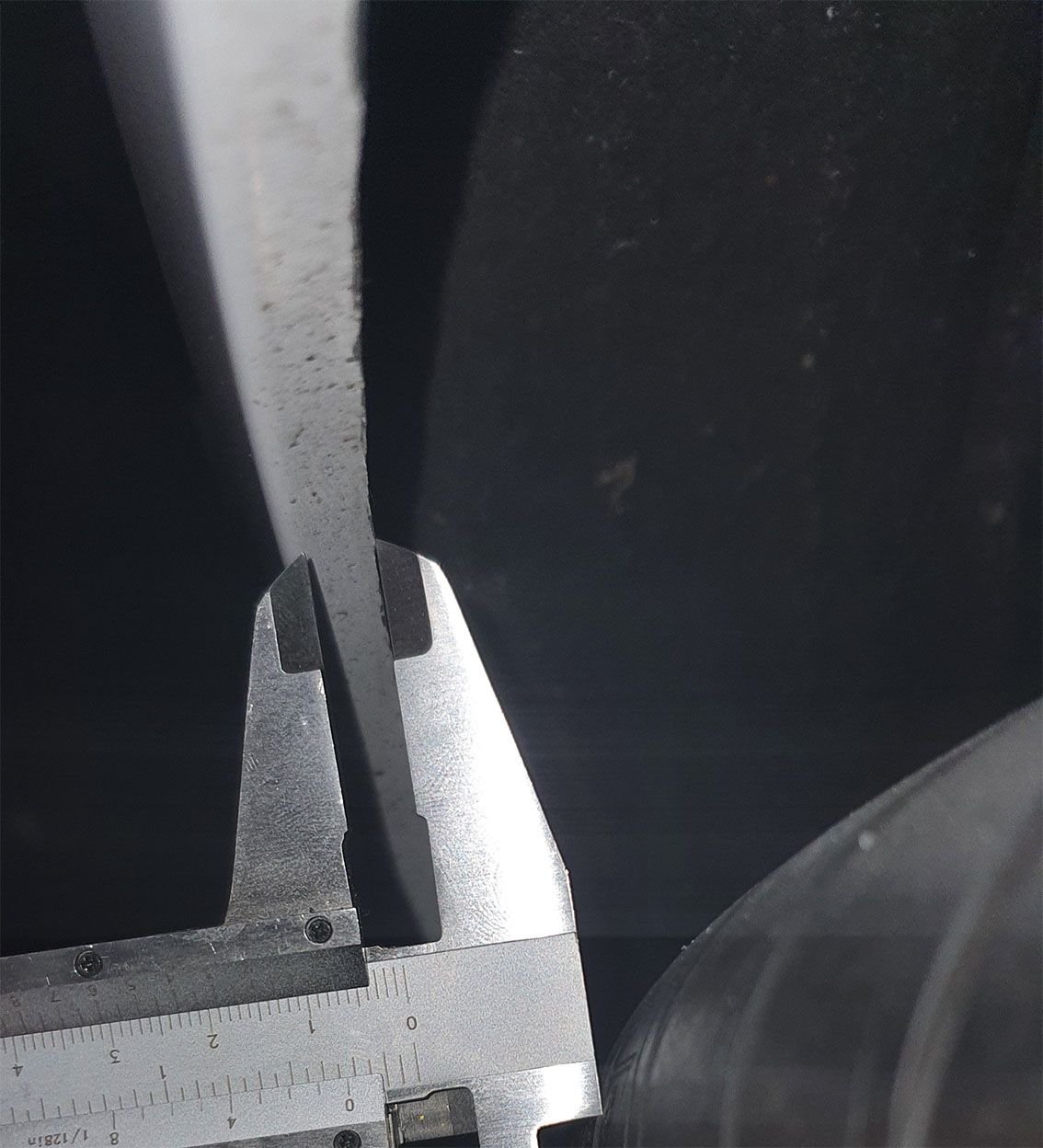

Nice, i was expected that results increasing footprint, when rear set wears out, I'll try 305/30 instead of 25.
About shaving, aluminum expert said rolled was possible but only if painting too, shaving, some whining that isn't easy because the double plate, this is how much on mine (way less than half mm stayed), only have pics from cutting but after was sanded perfectly, If you need better pics let me know.
Good to know it's double plated, that's probably what my guy was referring to as "there is something inside". I rubbed my finger inside and felt it. Hard to visualize without actually looking at it tho.
Please post more pics if you can find them, I will visit my race shop again and hopefully make an informed decision.
I'm guessing you're running 305/25/21? Did you have other mods that necessitates the fender adjustment?

Later today, will measure and take better pics.
Yes, they 21's, shaved to be ready for VAP springs and due the carbon brakes, custom wheel adaptor (17mm adaptor + smaller wheel offset) to allow clearance on spokes/ calipers and also the rotor hat have a smaller diameter.

variable 4 mm to 8mm, couldn't take better pics

Thanks these are perfect pics!! The stock lip measures about 18mm so I need to cut away 3/4 of that. Do you know if the double plates are parallel to each other, if so, just cut straight up both panels? are they welded at any point?
Careful with going 305/30/21, if they rub you pretty much have no recourse, maybe try a junk used tire before plunging for the real deal. Should be safe though, 28.2'' vs 28.4'' with my 20s.
