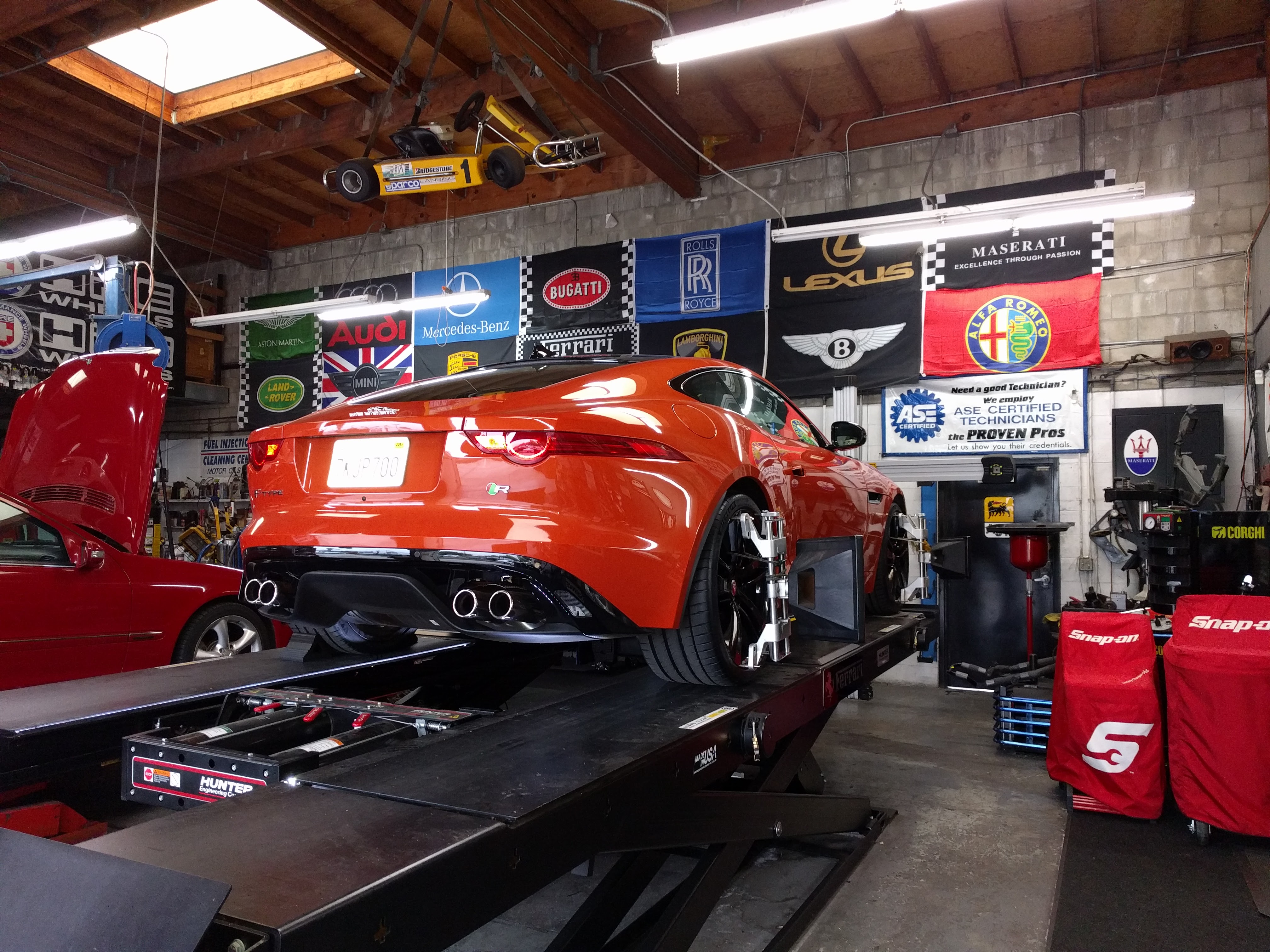

Rear alignment on mine was out enough to cause allot of wear on the inside half of the tire tread. Tires only lasted maybe 9000 miles. After four wheel alignment + tweaking, car tracks well around curves without fear of back sliding out. Much more stable on the twisties.
