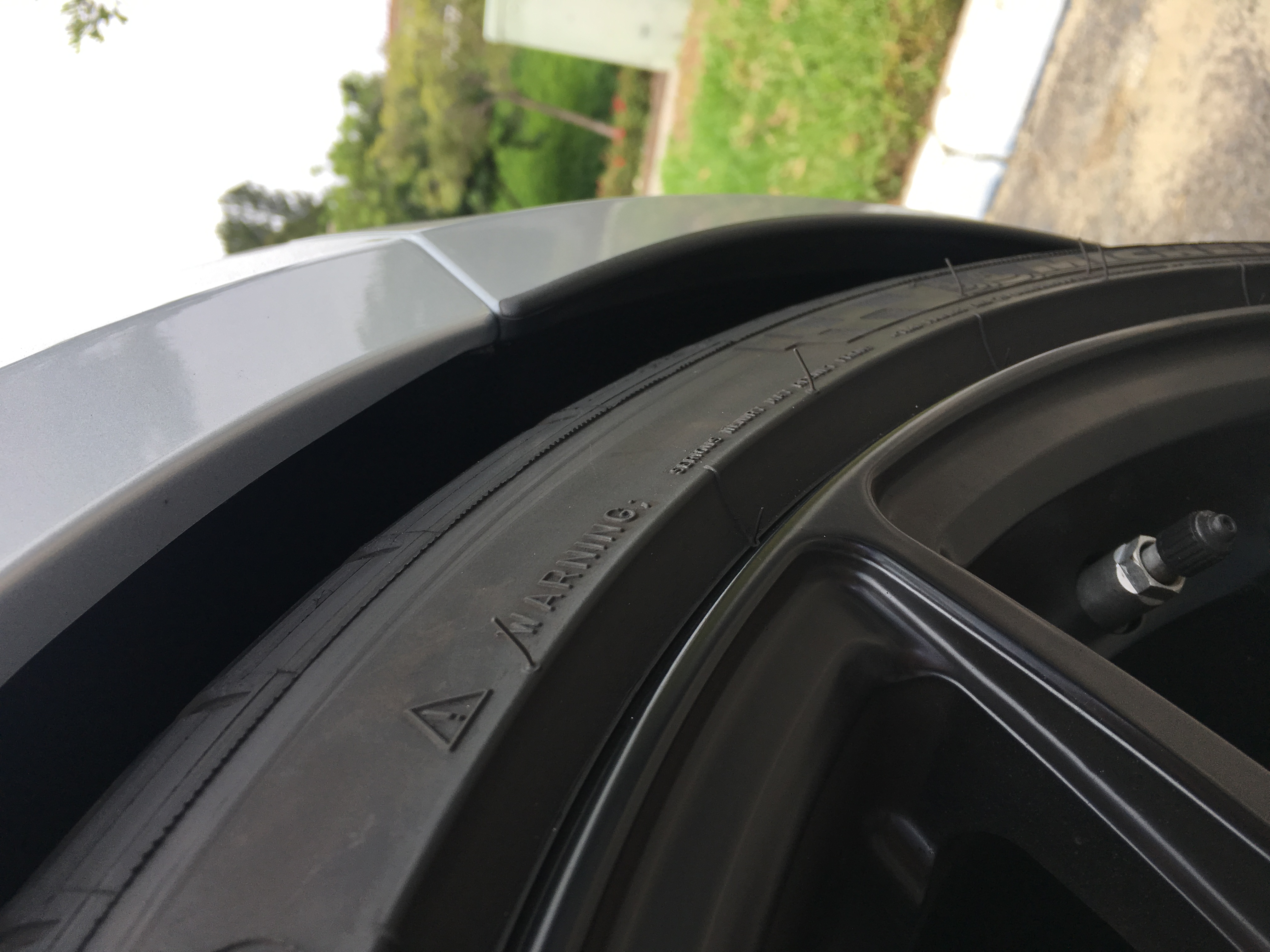

All taken care of. My buddy referred me to a guy that is well known in Orange County and he was able to take the car in after work this evening. Super cool guy that knows his stuff and supposedly has done thousands of cars in our area. He took his time and REALLY cares about the details of his work. No rolling was needed. The tab that meets the rear bumper just needed to be trimmed and transitioned across about a 4" space. It immediately took care of the issue us lowered guys have on some of the heavy dips on the 5 freeway lol. I'll take a picture of it tomorrow!

Here you go:
