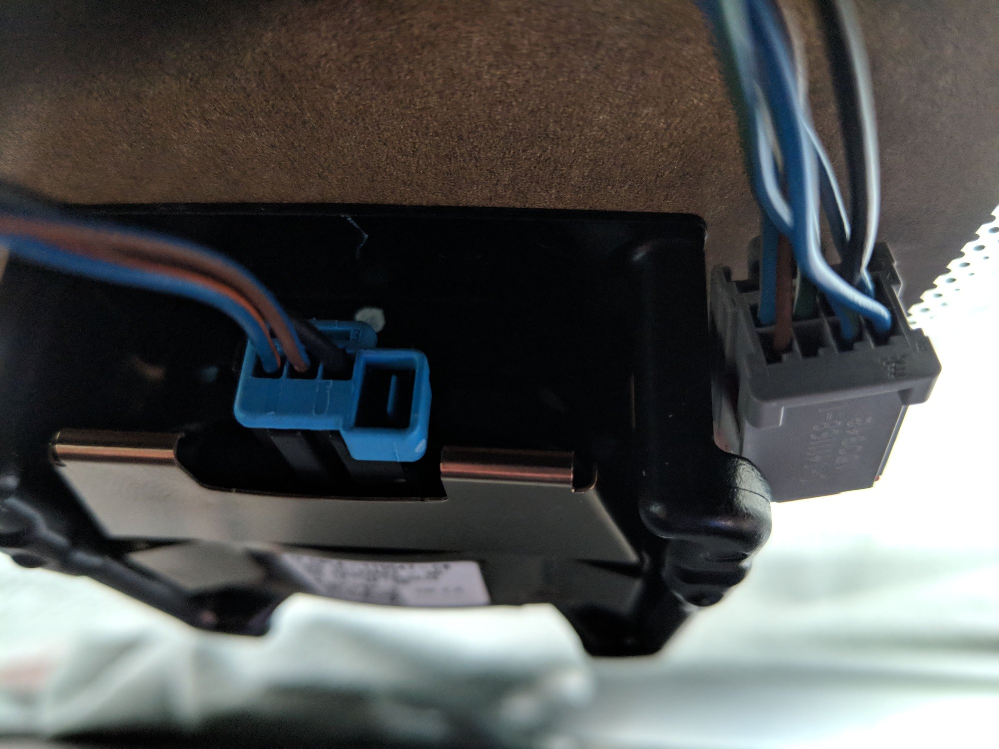

So to double check I removed the mirror with the Homelink buttons and checked the wiring connections. The mirror mount on the windscreen is shown with the cable to the right, with connections to all but one. The mirror connector, mirrors this exactly, missing one connector. So all physical connectivity seems to be there. So I have no idea why it doesnt work. As I say the homelink led flashes and seems to learn. just no transmit of the learnt signal ?
Connector on the mirror
Connector from overhead panel (on the right)

Can you swap the jag and RR mirrors and see if the RR works in the jag. That will tell you if it's the mirror itself or the connections

Paul, sorry for delayed response, just spotted your issue. Here is what I do know...
1. My wiring looked very much like yours. I would be surprised if the pre-wired connections were different from 2016 and my 2017. Not having it apart, I cannot be sure, but I checked 2016 and 2017 wiring diagram(s) and they look very much the same.
2. I do note the rang on this unit sucks compared to most homelink units. I have two other cars and one standalone with Homelink and a rolling code unit, and they can punch through from 100 feet (I have big curved driveway). This one has to be no more than 30 feet and, more importantly, pointed right at the door(nose of car aimed at door). More than 30 degrees and not enough signal.
3. The programming was a pain. At first I had same issue as you. Mu process was..Empty the memory by pressing the two outside buttons for XX seconds per the instructions. Then follow the Rolling Code instructions explicitly . Timing was critical as was sequence. And do NOT try to program more than one button to same rolling code door..seems this makes unit screw up and nothing works (he says from experience!).
4. Homelink worked out of the box, but the auto High Beam function required me to use JLR SDD to reprogram (add) before it worked, but I did that and it works flawlessly now.
If this does not get you there, let me know, and I will do reality check by doing pictures of wiring. Is it possible you got a bum unit ?
