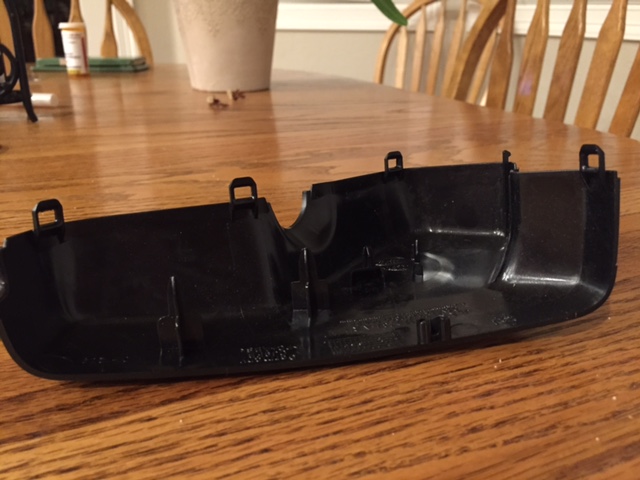

How did u get the plastic cover off? I want to install a mirror tap but am afraid of breaking the tabs on the cover.

The plastic pieces come apart quite easily, I didn't need any tools. There are 4 tabs as you can see from the picture
