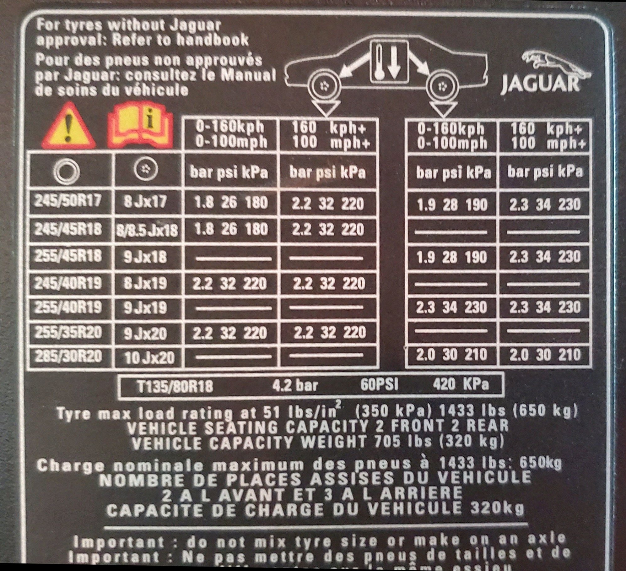

Yes, both correct, this is for the XK8. Here is what it says under my center arm rest. This being said, comments welcome from anyone on alternative 19 inch sizes as I am not considering a plus one.
P.S. Apologies for posting this in the F-Type forum. I got here directly by searching for tire recommendations and did not notice it took me away from XK8. I need to be more careful to not wander so far from my own villiage, but since I'm here I still value your tire opinions. Thanks.
2004 Jaguar XK8 tire chart

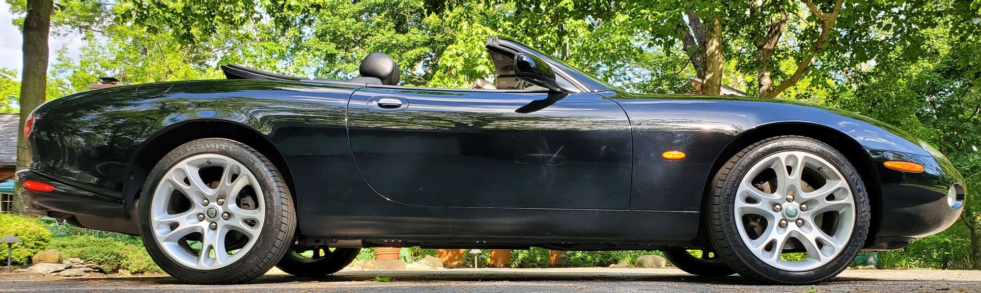

Hello Good People:
Here is a follow up on this interesting tire conversation. I finally got around to finishing the tire project on my XK8, but some of this may be relevant to the F-type. Based on the good advice in this forum, I got the Michelins from Tirerack with rebate. The ride and handling has improved. My Jag has staggered wheels so I went with the stock size front and a wider rear as follows:
F: 245/40ZR-19 Michelin Pilot Sport all season 4XL
R: 265/40ZR-19 Michelin Pilot Sport all season 4XL (noting the OEM size is 255/40)
I had the Wheel Medic true each wheel and powder coat to show less brake dust. Here are before and after pictures for the record:
OEM staggered wheels with Continental Extreme
OEM wheels metallic grey powder with Michelin Pilot and wider rears.
