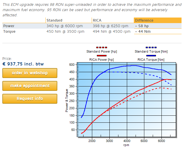

Here are the curves from the website for the base V-6.
Note that the recommended octane rating for the ECU is 98 RON (equivalent to 93 US octane rating). At least in California, that octane grade is not commonly available.
USA (AKI/PON) --- Europe (RON) conversion
  • 87 = 91
  • 89 = 93
  • 91 = 95
  • 93 = 98
The supercharger torque curves are really interesting. I note that the torque curve starts maximizing in the 2500 to 3000rpm band.
When the transmission is not in sport mode, I find that the transmission often shifts around or below that range. That may be for fuel economy reasons, but it'd be nice if it were more aggressive. For this reason, i've been driving mainly in sport mode even when cruising around the city.
