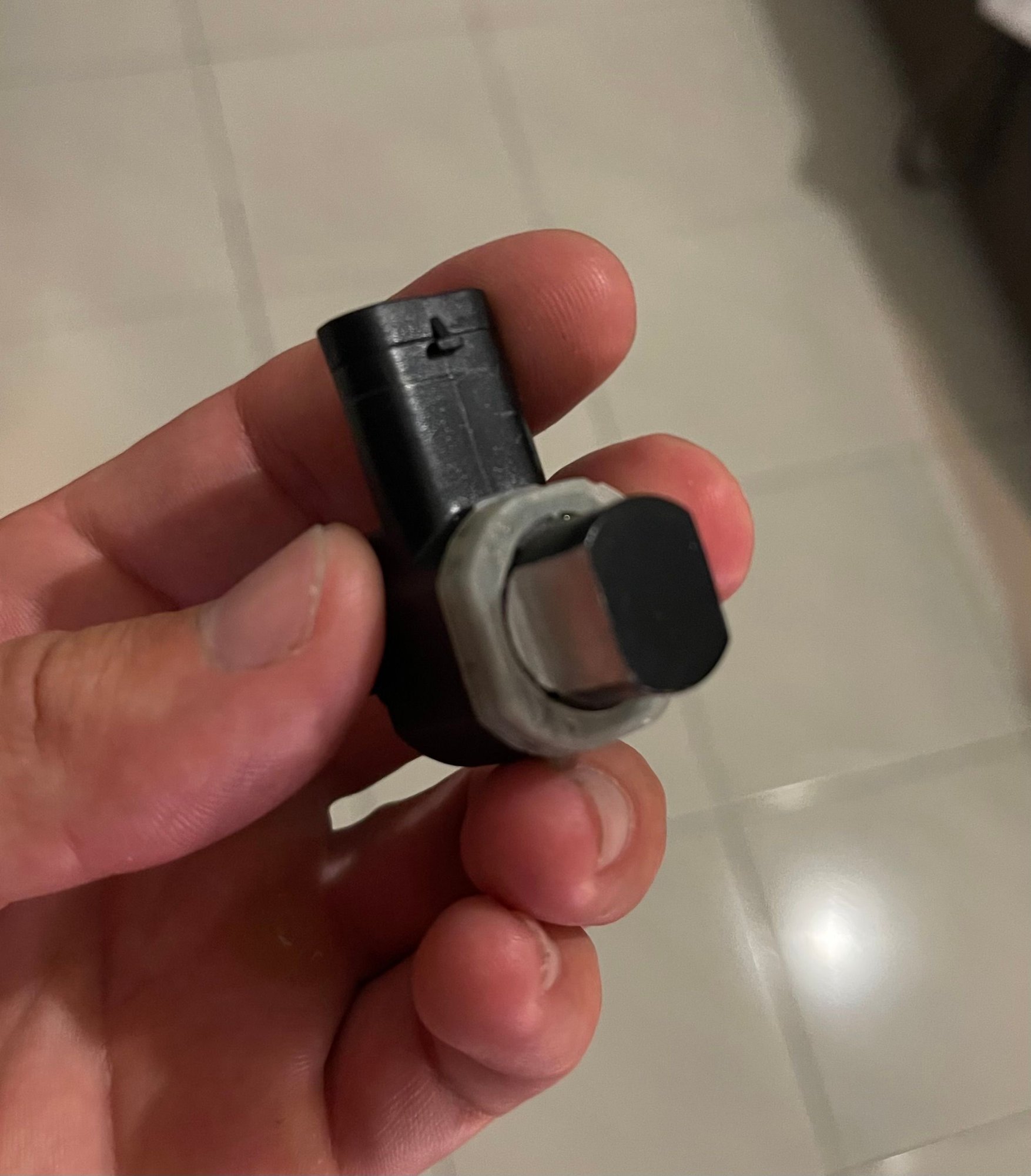

Thanks for the document describing the operation of the parking aid system. Here's what I tried to do.
I bought two types of compatible sensors for f-type: these of the same height as the original ones
20,71€ 17% Off | 4PCS Sensore di Parcheggio LR038084 LR010927 JDE28658 Per 2010-2013 Freelander 2 Evoque auto parti elettriche https://a.aliexpress.com/_EyLzrQX
And these higher than the originals, so as to make them protrude more on the e-pace grille
6,75€ 35% Off | CJ5T-15C868-AA per Ford Jaguar Land Range Rover Valeo Park Radar sensore di parcheggio BJ32-15K859-AA BJ3215K859AA
https://a.aliexpress.com/_EQVIvXZ
I filed them both as in the photo,

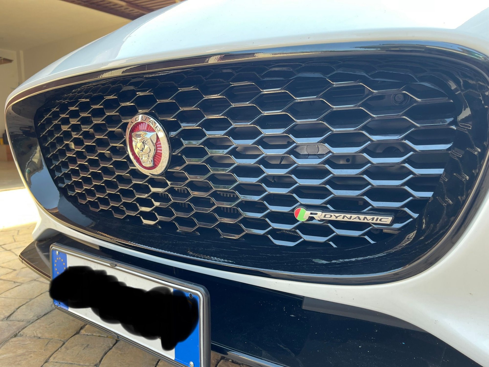

I filed them both as pictured, so they fit into the holes in the e-pace grille. I mounted the shorter one on the left and the taller one on the right. The result is that both work but they fire differently (which I think is normal). Also sometimes I have false positives and sometimes they don't activate, probably because they are slightly inclined downwards and not perfectly parallel to the asphalt. Or because they are not original, I don't know. Do you have any suggestions?

I believe you have the sensors too far back in the grill, which gives false alarms.

Agree! Should try to mount them so they are flush or close to flush with the very front edge of the Grill material.

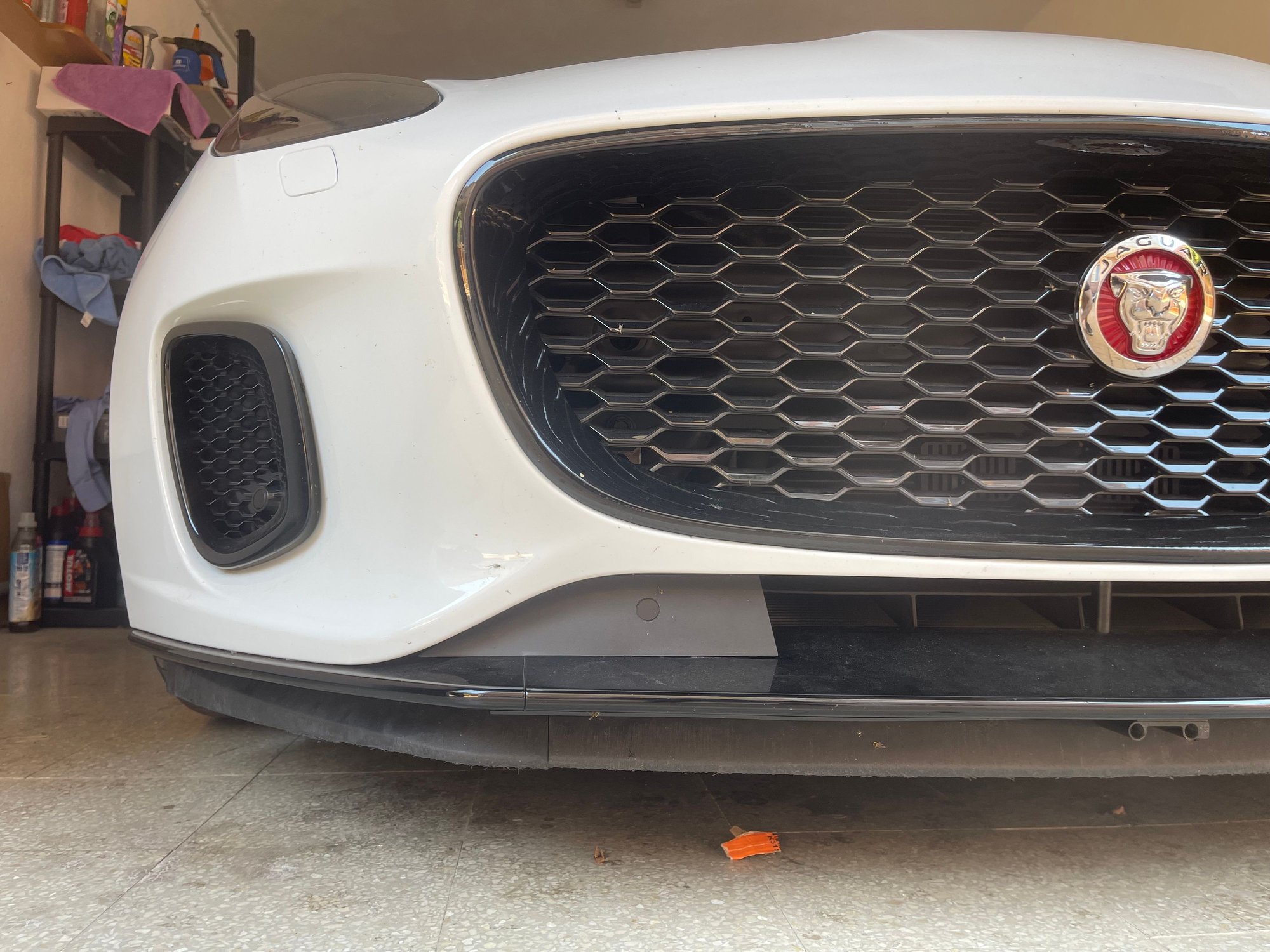

After doing some testing, I couldn't get the parking sensors on the grille to work. Probably because they are too far behind, as well as you said. I placed them on the black plastics below the grille and they seem to work fine here. I have to do some other tests but it seems to me the only way forward.
supports are not yet in the final version, I mounted them to verify the functionality of the sensors.
it is not possible to remove a sensor, otherwise the whole line will no longer work.

Hi, I can confirm that after doing about twenty tests I managed to find the correct position to make it work perfectly.
Unfortunately they don't fit the holes in the e-pace grille and so I had to find an alternative solution. in this mode the front grille is completely free and the visual impact is, in my opinion, better.

I doubt you will be able to use the covers you ordered. behind them you have full plastic of the bumper that you would have to drill... I created supports from scratch with the 3D printer and anchored them to the rear support of the bumper. I wasted a lot of time finding the correct inclination...
