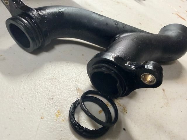

This is an older post, but the OP was asking about the longevity of the newer design (no seam) of the coolant Y-pipe. Mine just started leaking, most likely at the weakest point, which is where the Y-pipe meets the engine block. I won't know for sure until I remove the supercharger and inspect. I will be installing the newest aluminium pipes, which hopefully will last for the remainder life of my Jag. Anyway, the previous owner replaced the plastic Y pipe in 2018, still under warranty, as the car is 2015. I bought it in 2019, so the pipes lasted about 8 years and 40K miles.
Quick update as I've just recently completed the y-pipe replacement procedure. The "improved" plastic y-pipe failed, as suspected, at the connection point with the block. The flanges literally separated/disintegrated and I was experiencing a slow leak. The entire process of removing the supercharger was easier than anticipated and everything went smoothly, but I discovered that the aftermarket aluminum top pipe that connects to the Y-pipe had its mounting points misaligned. It took some grinding to get it to fit, but all's well now and no more leaks for the time being. The aftermarket part was an inexpensive, Chinese knock-off, so no surprise there, but its O-rings fit very well into the block, so that's the crucial part. I replaced the SC coupler and SC oil white at it. There was some play in the turbine, which the new coupler minimized. I went with the stock design.

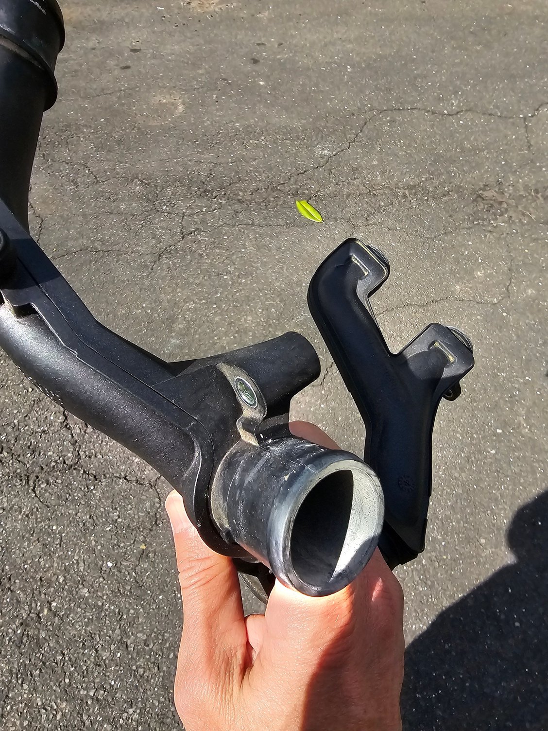

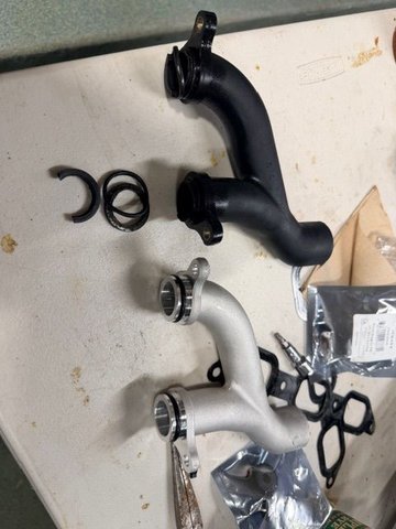

Look at the photos in the above post. If your black pipes are round like a piece of pvc, those are the newer ones. If your pipes have flanges, those are the old style. The aluminum ones are available from an aftermarket vendor or, possibly now with JLR part number, through JLR.

Not a dumb question at all. The original design of the Y-pipe was made up of two plastic halves, glued together. Most would fail eventually, as the glue did not last too long. The revised design from JLR was a one piece Y-pipe, but still plastic, so while the pipe itself would not crack, the plastic flanges that hold O-rings which connect into the block start to leak as the plastic melts, separates and disintegrates, eventually. The newest, aluminum design, promises to outlast the engine as it's unlikely to crack or melt or disintegrate. Time will tell. The only weakness point may be the O-rings. We will see...

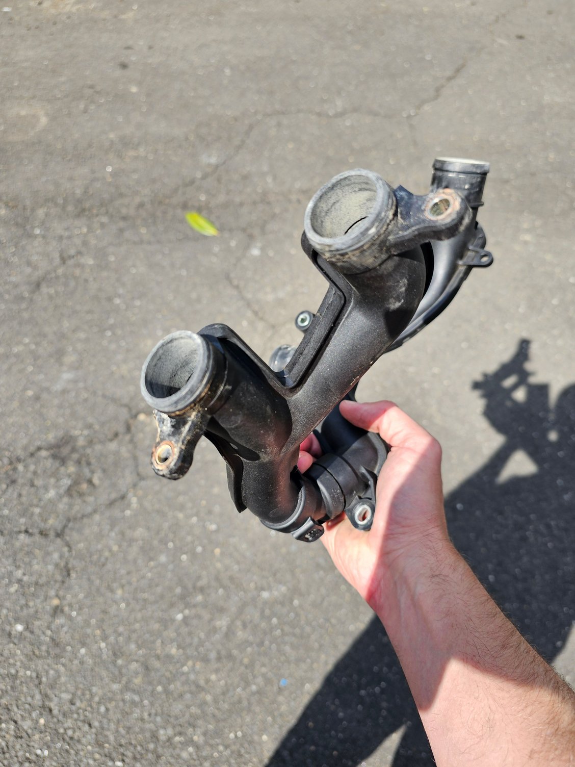

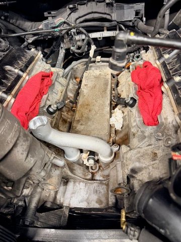

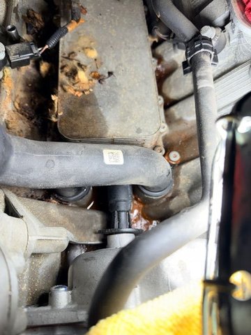

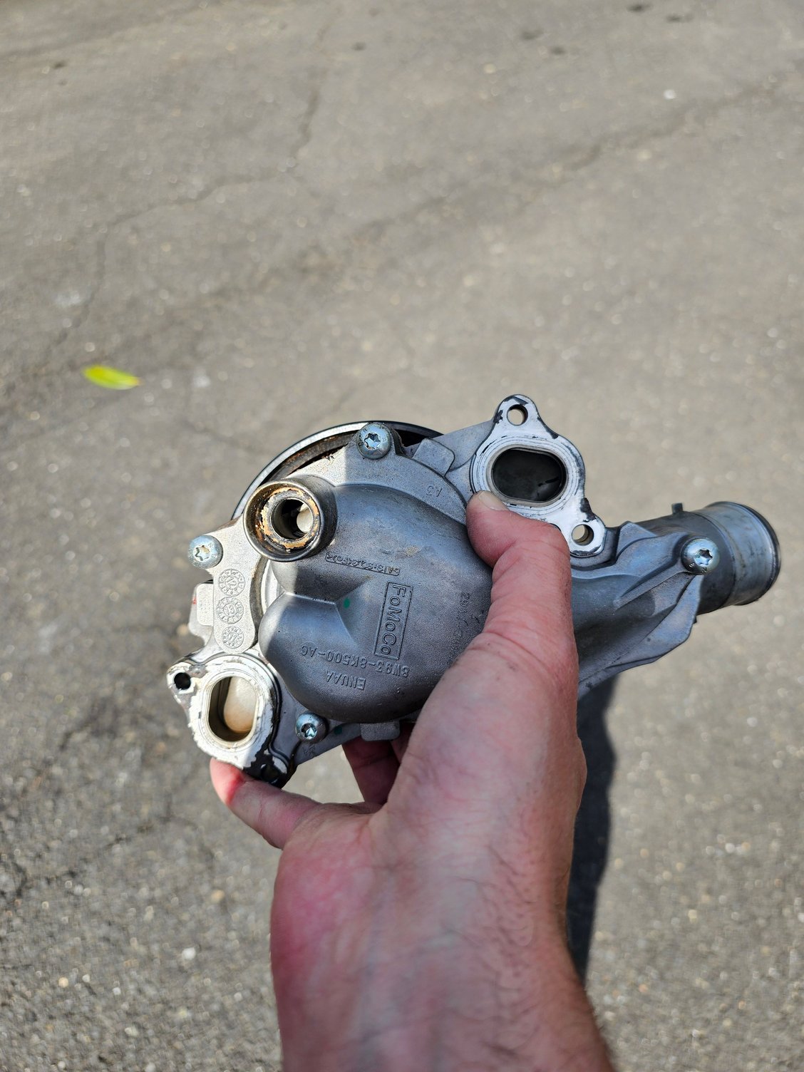

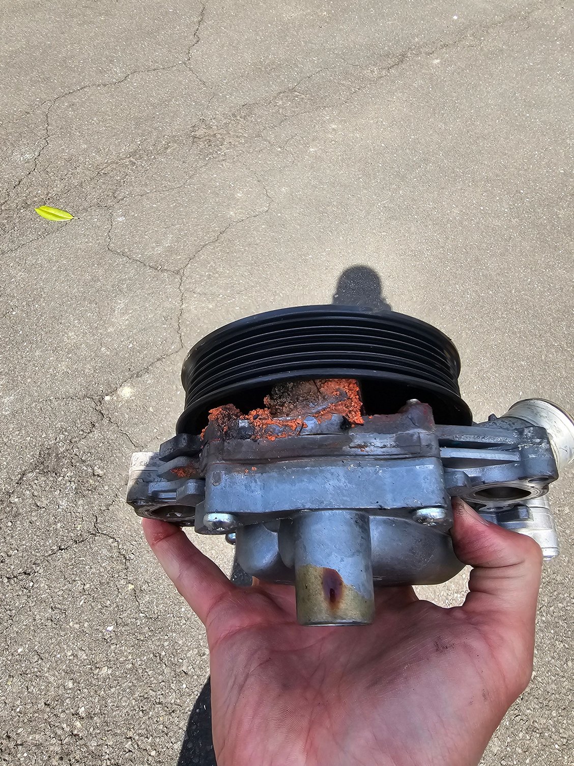

Just some post coolant system overhaul forensics, most things except the water pump were in fantastic shape foe a 2015 R with 34k miles. Just goes to show, environment matters (these are the old seamed pipes too):
Symposed and the other hoses weren't all that bad either, maybe a little stiff. Water pump had been seeping for years.
