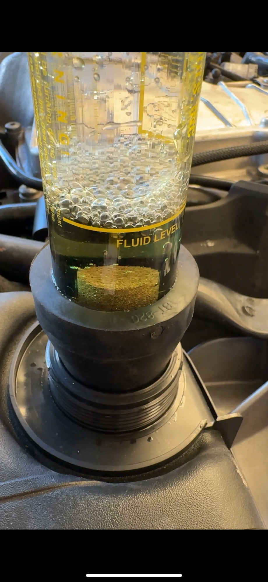

Funny enough, I did do the same test before I took it to the shop. Just wanted to see what they thought. My guess is their "inconclusive" came from it being a green color like this rather than bight yellow? This is what I got when I did the test.
I just know the car didn't overheat, which is why I'm iffy on it being the head gasket but if thats the case..
That sure looks yellow enough to me to be evidence of CO2 in the coolant!
Maybe not a lot but some, so a small gasket breach not a big one, which would also explain the slow coolant loss and lack of overheating.
But still a big expensive job to replace the head gaskets, with the probable good news that that is all that needs doing and neither the head(s) or the block are warped so the engine can be saved.
That makes sense. Welp, its gonna be an expensive one
