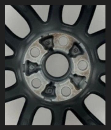

I believe we spoke earlier on this via email as well. You would need to shave down some of the OEM studs to fit spacers with your OEM Wheel style. The pockets are not recessed enough for the OEM studs to fit. See picture below.

The Tornado wheels have one of the least recessed area for where the studs would need to go. Even with the 18mm spacer it is likely these would need to be slightly shaved down.
Here is another example of a different style F-Type OEM wheel that would work with these spacers. You can see the difference in the recessed area that would accommodate the studs.

@WhiteTardis I sent you an email last night as well, but for the sake of this thread, I was logged into my personal account last night when I made the above post, but yes the Tornado wheels have the least recessed area for studs to go, hence why we indicate that the 18mm spacers will work with most wheels (but not all) without modification. There are a couple of options.
  • Shave down the stock studs to fit
  • Remove the hubs and tap out the stock studs, more work, but no longer an issue
As much as we'd love to confirm the compatibility of each wheel fitment, it is not feasible with so many variations
