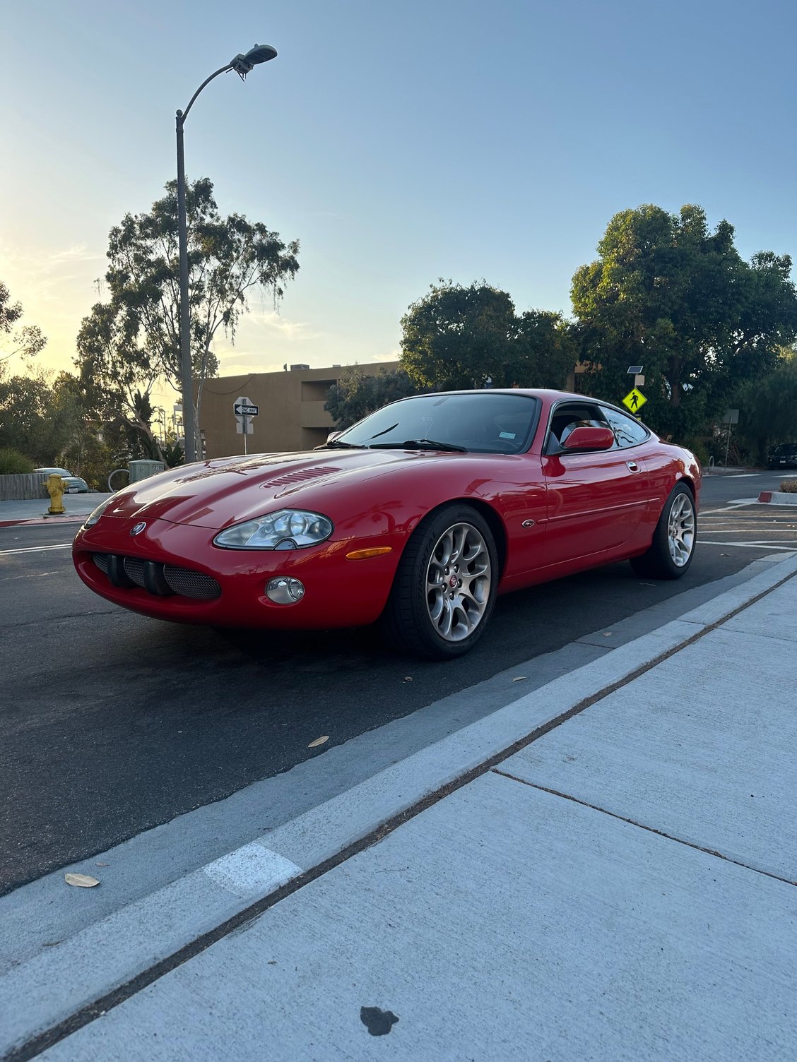

On a lowered car, can run 25mm front and 30mm rear without having to roll the inner fenders.

18" Double 5 Wheels with +25mm front & +30mm rear and lowered on Nitron coilovers. The ride height is set fairly tall on the coilovers as we were creating an OEM+ stance and ride.
H&R lowering springs will be significantly cheaper ($500) than the Nitrons ($4k). H&R springs are usually in stock, the spacers are special order from H&R and take about a month to get - oddly the 30mm ($180) are cheaper than the 25mm ($250). The spacers bolt to the hub with new hardware and have offset studs for the stock lugnuts to thread onto. If anyone wants more info on the H&R or Nitrons, shoot me a message.
