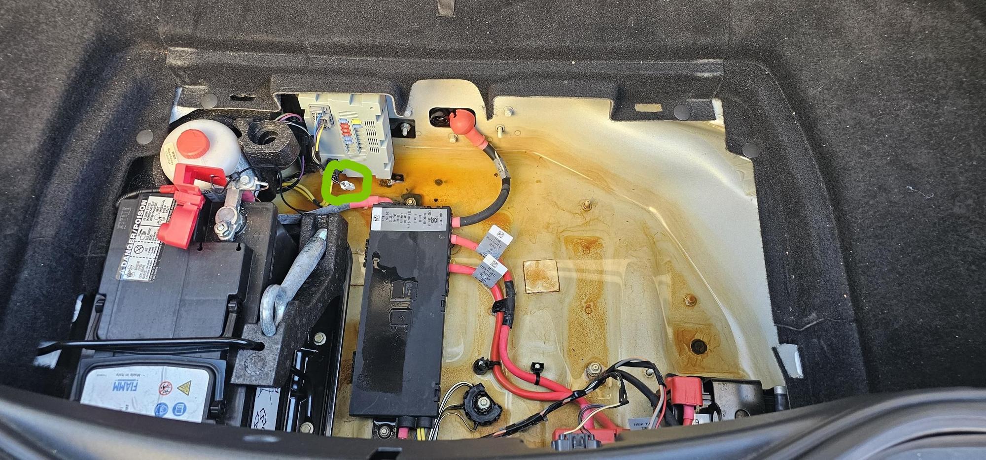

Hello Board
While replacing my battery I noticed a minimum of 2" of standing water in the bottom of my trunk.
Does anyone know the source of this issue of:
1) how is the water getting in there?
2) why isn't it draining out?
3) Can anyone please explain where do I plug in the connector that is circled? While vacuuming out water I noticed it was disconnected.

That connector is supposed to be unplugged, it’s only used during shipping.
Yikes. There are a number of threads here about checking for plugged drainage holes, I’m not sure where they are.

I had water there too. It turned out to be a special sealing clip that wasn't sealing. I'd only get water intrusion during heavy rain, so it was difficult to track down.
First, you need to get that dried out thoroughly. Once that's done you'll need to put the car in a position to let water in again and find where water is coming in. For mine, I could feel the carpet was wet on the passenger side.
The liftgate has a seal that goes down both sides. It is held in place by pretty standard looking clips, like you'd find holding door cards in place. They do have a difference though. There is a rubber part that seals the hold the clip snaps into, and it wasn't sealing for me. I lifted the seal and put some 3-M strip caulk (often called dum-dum) around the clip and that solved the problem. I ran a piece of black vinyl tape the length of the seal at the outer edge to hold it back in place. If this is the problem for you, be advised that the weatherstrip tears very easily once it's a few years old. You might be able to push down on the place where the clip is to seat it better. I'd already torn things apart by that point, so used the strip caulk to be sure of a seal.
I hope this is helpful.
