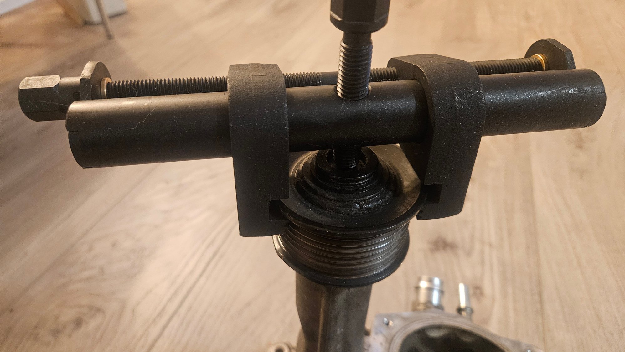

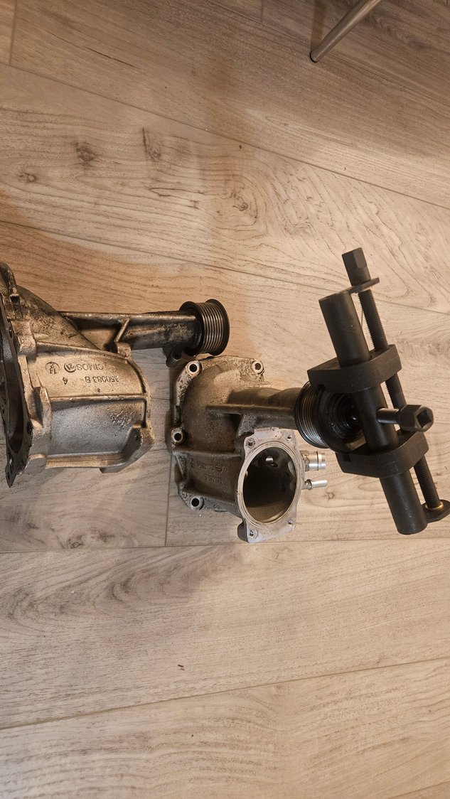

What happens is the coupler starts to wear against the shaft and creates a vibration
then it wears against the shaft intern the bearing gets a beating, so from opening the snout
and finding bad bearings , i found replacing the snout and coupler with a solid ZZP coupler ,not the fake ones
Cleared up the rattler for all the members cars I've
done for the last 5 to 6 years, but lately ive been rebuilding
the shaft bearings in the snout
