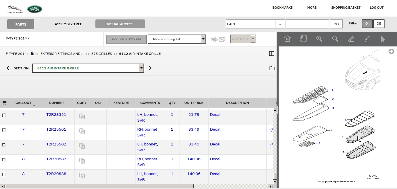

Old Sep 23, 2017 | 05:23 AM
Cambo's Avatar
Joined: Jan 2011
Posts: 8,637
Likes: 4,525
From: Sydney, Australia
Thank me later!

Originally Posted by Cambo
I love you! I've been looking for these part numbers foreeevverrrr. I am a bit confused on whats part 7 and 8.
Originally Posted by GreggM
I too think the SVR vents look cool. Has anyone actually done the install on a non-SVR hood?
Looks like its about to happen now that I got the numbers.
