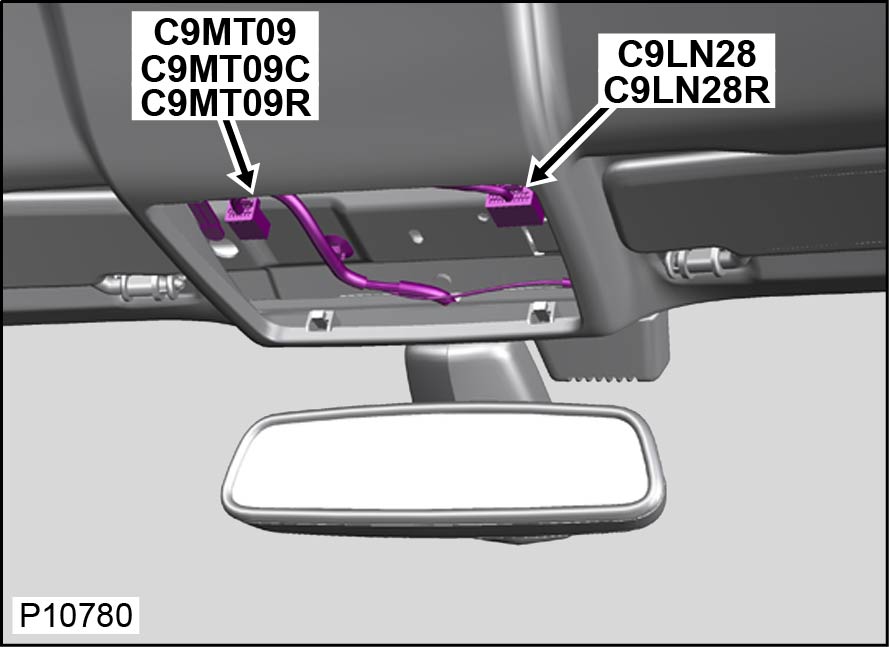

Not having telematics in my 2015 I have no hands on experience with them, so I am limited to the troubleshooting information that Jaguar publish.
The TCU has a direct connection with the RCM (airbag module) which receives crash events so it is possible that if that was reprogrammed then maybe the TCU does as well as it might still think there has been an accident. Really it needs to be diagnosed with SDD/Pathfinder software to see exactly what is causing the message. A main dealer should not take 3-4 hours to do that, it should be achievable within a 30 minute diagnostics session as it only requires them to plug their laptop in and start a new session, although obviously any further steps would take time.
The only thing I can suggest is checking the connections are not disturbed.
C4MT01A/B/C
C4ME192A/B/C
C9MT09R/C
C3MT13
C33BG
C2MM13R
If the GPS on your navigation is working correctly then no need to check the rear roof pod connections
Attached Thumbnails Telematic Module-p4126.jpg   Telematic Module-p10768.jpg   Telematic Module-p10780.jpg   Telematic Module-p10762.jpg
