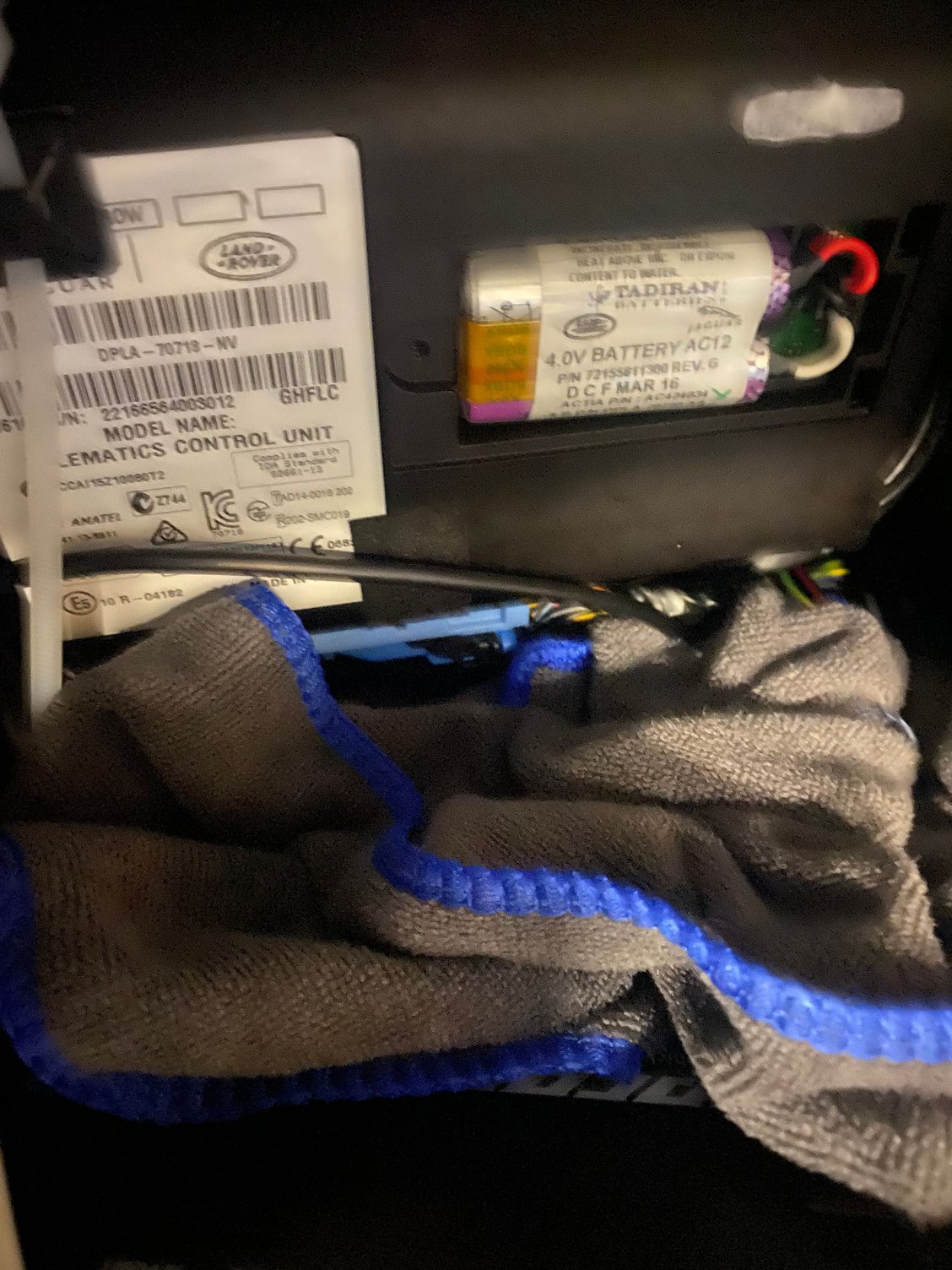

Hi
can anyone tell me where the Telematics control box is located in a My 2017 f type, I’m looking to change the small battery in it
Thanks

It is located behind the cubby between the seats. I have not seen any references that the TCU contains a battery.

I recently saw a post on the F-Pace forum from someone who just had the battery replaced by the dealer.
The price was $700! - in part driven by the labor of getting to it deep under the rear seat. Stupid design. Presumably easier to reach on the F-Type.

Yes, in the rear. Duracell H8 $200.00 from Sam's club.

Battery replacement £58.00 from jaguar

I think we're talking about a different battery - the one in the TCU.
