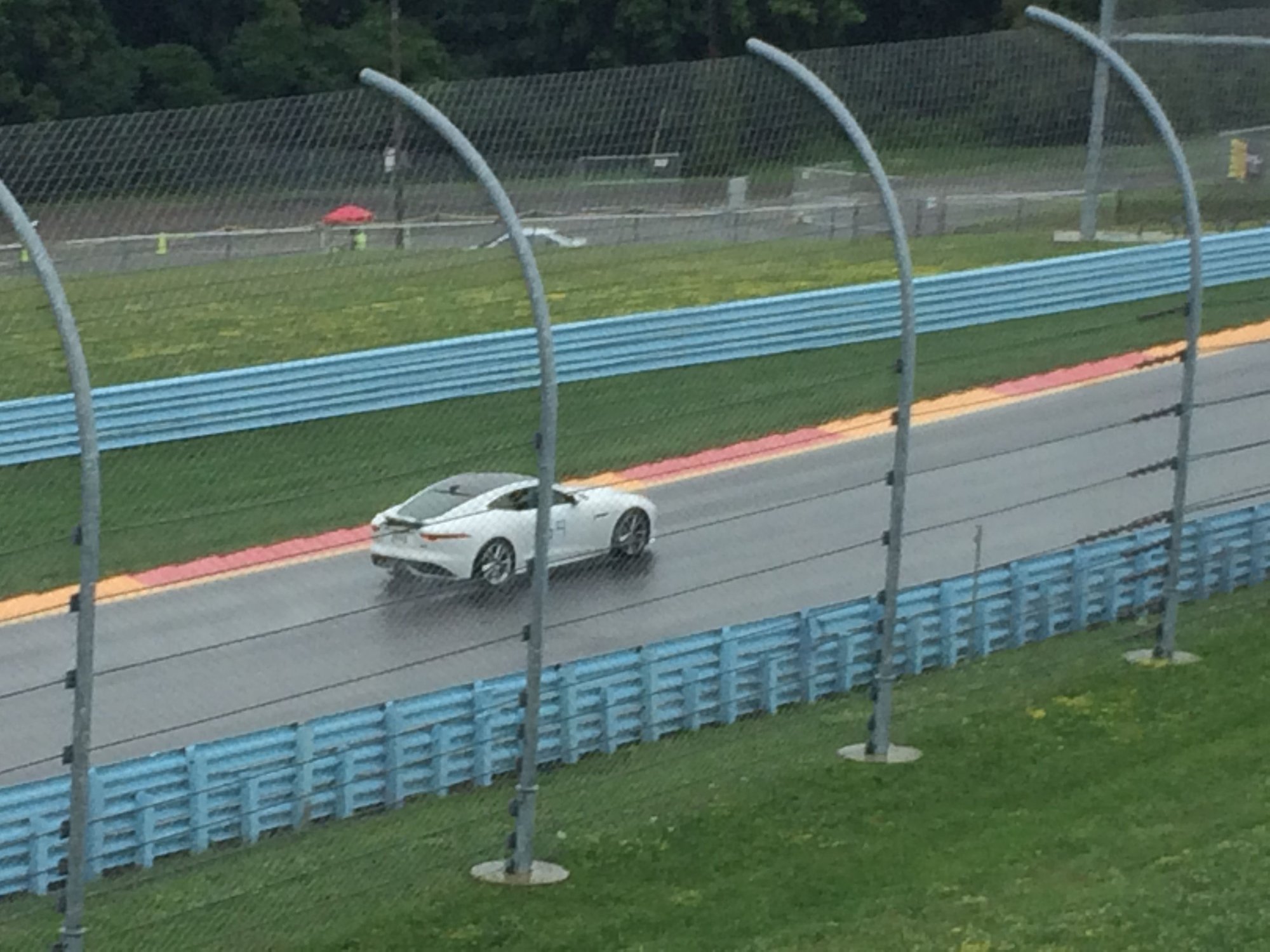

  • it did amazing in the rain - we had rain the morning of day 2 and Jag was the fastest car on the track. I passed EVERYONE and never felt like I was reaching the limits of the car in the wet (the Pilot Super Sports are also very good in the wet).

In the wet at Watkins Glen
