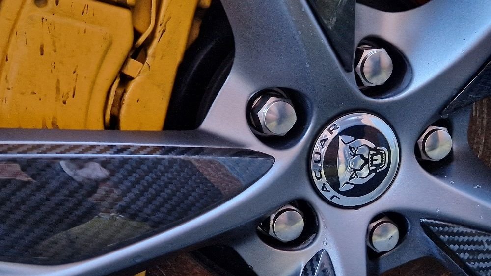

Fitted Ti lug nuts to my carbon blades as the stock nuts looked really shabby, plus was trying to offset weight gain from fitting 10mm spacers, (didn't want to go 15mm adapters as the weight gain v look was too much for me). The Ti nuts will not save much weight, yes I did weigh the old and new, just to check. The 20 stock lug nuts including lockers came in at 1,505g. The Ti nuts (Jaguar Ti Lug nuts) came in at 925g (61% of stock), so 705g (1.55lbs) saved overall . The nuts I purchased have a slightly longer thread ~2.5mm, so reduced the risk from the 10mm spacers. So in summary little if anything to be gained in weight savings, although it did halve the weight gains of my 10mm spacers. The Ti nuts look so much better than stock. Final point, as an ex vehicle mechanic, you were taught never to put any coatings on wheel studs/bolts, always fit them dry and torque to recommended settings.
