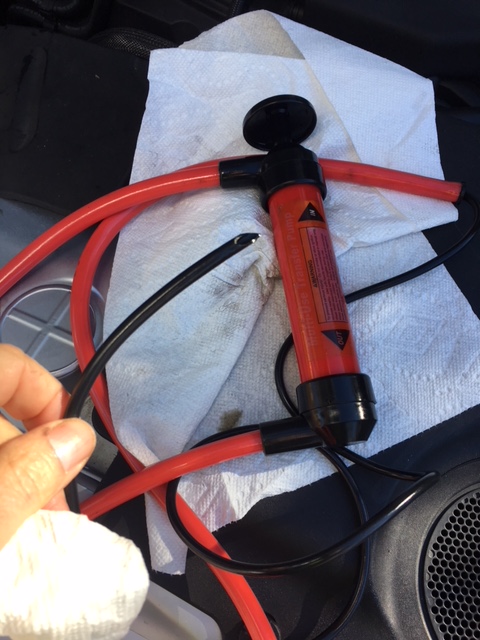

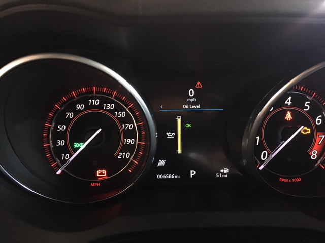

Default Engine Oil Overfill Again!
I once again had the oil changed and checked the oil level after operating it awhile. Yep, in the "red" segment - overfilled again!
I think for a Best Practice, it will be necessary to ask the dealer to leave it a QUART or 2 LOW, then drive it until the oil gets heated, then check and add in 8 oz increments until it full.
If you are going to be tracking or do some spirited driving, I recommend you fill it to a level that is either 1 or 2 segments below full so to leave room for expansion which does occur on the track.

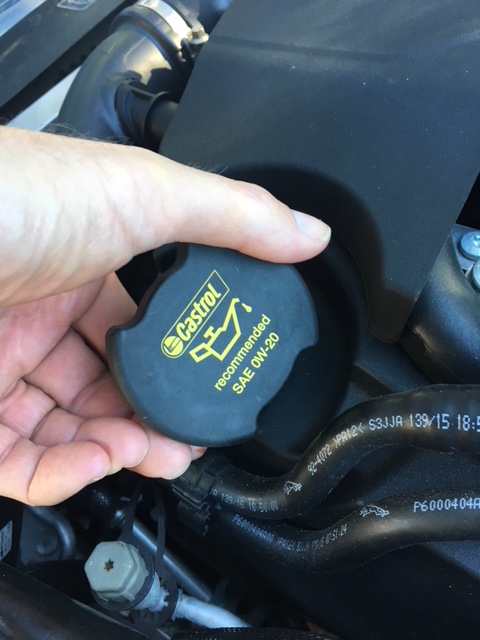

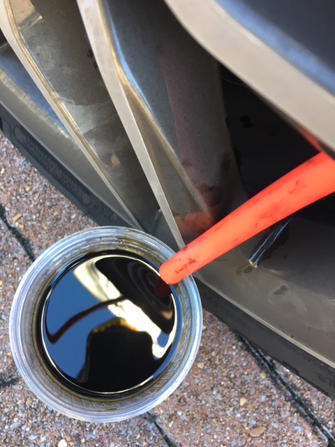

Removing Oil:
My tools for removing are a $15 Harbor Freight hand pump and a clear solo cup.
The smaller diameter tube is barely the correct size to wedge into the small oil tube you find under the oil fill cap. Note; the small black tube is actually too wide to go down into the oil. But it does make an air tight seal and allows for the pump to create a suction. Same result. In this instance, I removed 14 ounces of oil to get the car back to full segments. I will remove another 8 - 16 ounces before the next track day to allow for expansion.
Here are pictures of the oil removable tools and process...
Attached Thumbnails Tracking the F type R-oil-cap.jpg   Tracking the F type R-oil-tube.jpg   Tracking the F type R-hand-pump.jpg   Tracking the F type R-cup-overfill-oil.jpg   Tracking the F type R-after-removing-14-oz.jpg

Or take it somewhere else to get the oil changed. If I did that, I'd be very clear with the dealer why I was going elsewhere. Or, since you have the extractor, change it yourself. But in any case, I'd probably rip the service manager a new one, if this was the 2nd time they did that.

DJS, the problem is not that simple.
I checked the oil level when I picked up from the dealer and it indicated full segments (NOT OVERFULL). Perhaps it expanded when it went from cold to hot, perhaps the electronic gauge is not 100% accurate, or perhaps some contaminates entered the oil after tracking - who knows??? That is why I say a Best Practice is to start a Quart or 2 Low and add it in 1/4 quart increments.
