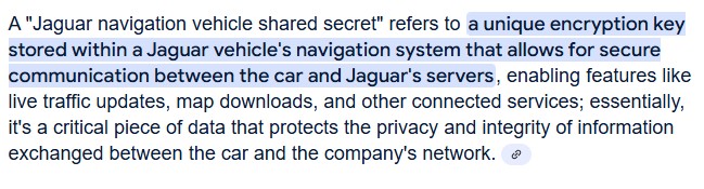

In the research I did, it was apparent that there are different Infotainment units with different methodologies for updating the NAV. Some cars have an SD card port and use a special (in some cases) SD card for that update. Some use USB, and some use USB that can be bought updated. I did see an entry where, yes, you bought the USB appropriate for your car and had at it.
The interesting thing here is that I also have InControl Remote. At first it took me a bit to understand that Remote and Nav are two different things in terms of account and log in. I was able to connect my car to the Remote. The InControl remote app required my VIN because that app communicates with my car and my car communicates with it. Remote is a subscription service for a fee after the 5 th year. I paid the $70 for a year try it out.
Once you log in to Remote (for this car) it shows you where it is on a graphic that is like a line-drawing map. It shows the outline of my house and a marker that shows where the car is. Other menus in this app allow remote starting, tell you the status of the car,( windows up/down, doors locked/unlocked, etc.)
If the car is in the home garage, I can have a device with the app on it with me and I can bring up the app. It then shows a black dot which is me/my device/app and where I am in relation to the car. For example, the car was in the home garage earlier in the week. I went to the dealer (about 15 miles away) Changing the map size allowed me to be able to see me in relation to the car. Other users have cited where they have used the Remote app from home to see if the dealer has done anything with their car in terms of moving it from the parking lot in to the shop for service. It's also a great tracking device if the car was ever stolen, or if you are trying to find it in the dark when too far away to have the fob work for the lights. So, there is obviously two-way communication going on. The car tells me/the app where it is, for example, and, I can remotely up the windows or fiddle with the locks. That communication has to use some sort of locater associated with the VIN to know the correct car.
It seems that the "enablement" for this communication may be housed in an encrypted file called Vehicle Secret Services. It's how cellphone companies do things with cars and is not accessible to vehicle owners. I'm sure there's more to VSS. It's probably like the hives that are used in the registry for Windows OSs.
This link is for a similar issue with newer Jaguars that use PIVI, but I think it boils down to the same kind of thing.

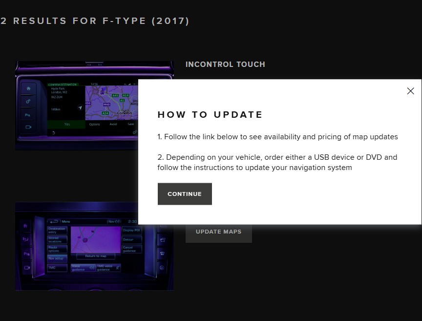

Here is how I know I have InControlTouchPlus. Pro seems to be the later version with capability to use Carplay and Android Auto.
https://www.jaguarusa.com/ownership/...tes/index.html
One has the choice of two different systems as pictured. The top one takes you to the SD card process... not what I have.
The bottom one takes you to USB process, which IS what I have in the console. Continuing from that page takes you to the log in page. I do have a log in, and then it askes for the VIN. It won't accept my VIN, so dead in the water.
I really don't care that the Infotainment system I have can't use Apple Carplay or Android Auto. All I'm trying to do is update the current Nav info.
Thank you for trying to help. I WILL get it sorted out!

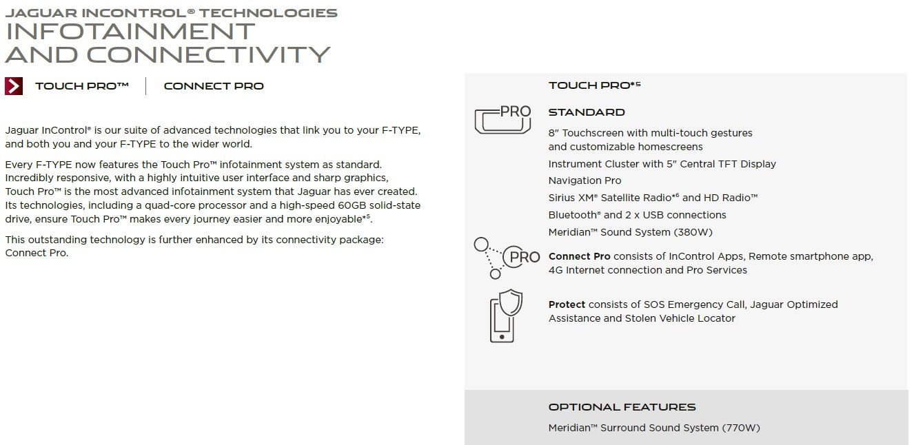

A bit OT because it concerns MY18 and ICTP but there seems to be some confusion here about the infotainment systems and a weird answer from Feral's dealer...
All MY18 cars came with In Control Touch Pro and an 8" screen with physical buttons on the sides. There was no base version - all cars came with the full fat "Pro" system with all available features including wifi hotspot functionality, over the air software updates (of the system software, not navigation though), weather updates, music streaming through built in apps for Spotify etc. Everything except CarPlay/AA which they for some reason never got working with that hardware. There was actually one system update which included CarPlay/AA but it didn't work so that feature was removed in a later update. A bit later the 10" screen without physical buttons was introduced. That also ran the same In Touch Control Pro system with exactly the same features except that CarPlay/AA worked.
There was never any possibility to update anything via wifi. The only thing that could be updated wirelessly was the system software, provided that you had an additional data SIM card in the car. The over the air updates stopped coming a couple of years ago when they stopped developing the system. I guess the amount of map data in each update from Here was too large to be feasible to run over a 4G SIM card in the car and therefore was only available via USB stick based updates. From memory each monthly update used to be some 40-50 GB, at least here in Europe where the map data weirdly only came in a huge package including all of Russia and some surrounding far away East European countries.

From the US MY18 brochure:

After reading through the TSBs I linked in above posting, I think it has something to do with the NAV not being enabled, much like the interior blue lighting in my car was not enabled. Tech had to drill down while connected to the car to access some module that controls it.
