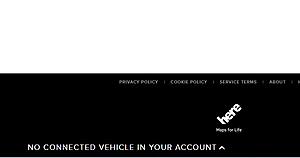

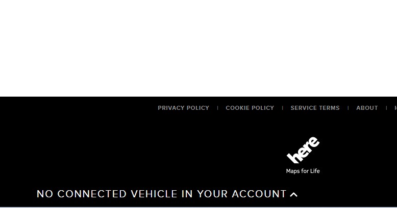

Went out to the Jaguar HERE site again. At the bottom this graphic appears, No Connected Vehicle In your Account (NOTE, these graphics and links JUST started to appear on this site. I have been on this regularly and today is the first day I've seen this)

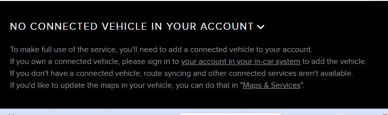

Clicking on that graphic opens up some details. Note the second line " If you own a connected vehicle, please sign in to your account in your In Car system to add the vehicle"

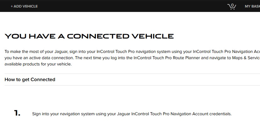

Clicking that underlined link brings up the 3rd graphic, saying that it is InControl Touch Pro Navigation system.....
My optimism now pretty much crushed, it seems that there is no update unless I were to have Touch Pro, not the older Touch Plus.
I'm still going to call, I will see if I can get an answer for the Touch Plus vs Touch pro.

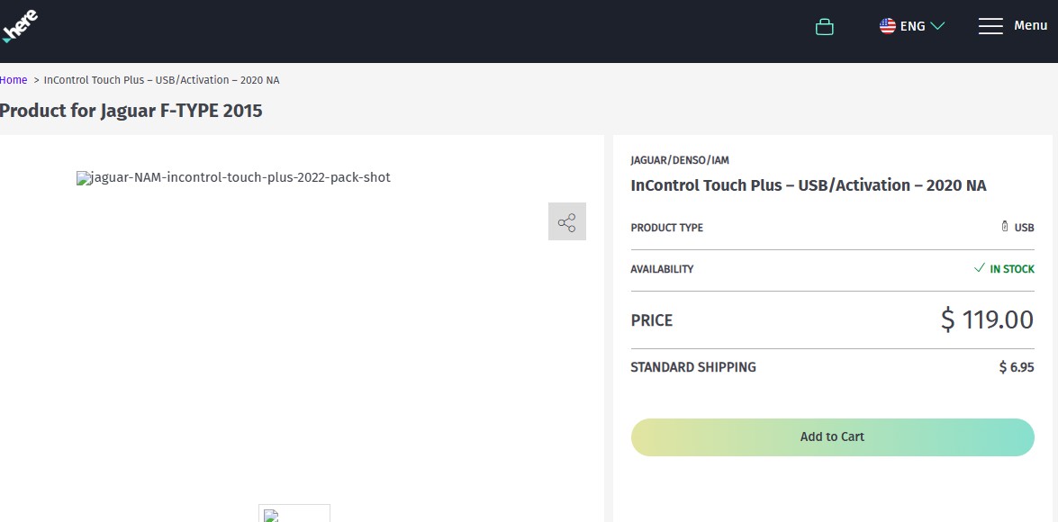

Many thanks to all of you for your suggestions and advice. I believe I have come to the end of the trail for information on any sort of Navigation update for my 2017 F, built late 2016. Do recall that this F does NOT HAVE AN SD card, only the USB port in the console. It is InControl PLUS, not PRO.
My appreciation as well to my JLR tech who dove into this. He happened to have a used Jaguar at hand that has an identical ICTPlus unit in it. He found that if he went to HERE, but using a 2015 Jaguar F type entry, he could locate a USB Nav update. Here is his synopsis:
"Logging into one of the accounts for the route planning and attempting to add a vehicle I have found that those instructions are for a Incontrol Touch Pro vehicle kinda similar to the white XE that I was showing you on Friday so we can not login to that due to the software being different.
Next I have been messing around here and going through their updating path where you click on the Jaguar then asks what vehicle and year and that is where it gets interesting. I believe that they have the wrong information on their site because when you do 2016 or 2017 Jaguar F-type it brings you to that screen that says login to your vehicle from the vehicle which is impossible because the Infotainment system in your vehicle does not have that feature. The info on the HERE website is wrong and directs you in the wrong area and gives the wrong info for the vehicle selected. So I entered it as a 2015 Jaguar F-type and it brings up a usb able to purchase right from their website with no vehicle info needed which I believe to be the correct path due to your vehicle not having the ability to have those other account features. As well as the infotainment system in 2015 is the same as your vehicle so they should work the same. Now here is the kicker.... They have stopped updating the maps in 2020.... even if you buy it and update it the maps are already 5 years old which is disappointing to say the least but I will attach the link for it and I downloaded the instructions and they appear to be what would be required to update your vehicle. "
In conclusion, Jag is wrong. Here is wrong. I believe that they have too many overlapping years for tech and they don't know what is in what cars."
[I AM NOT ADVOCATING ANY FURTHER STEPS TO THIS PROCESS, PROCEED AT YOUR OWN RISK AND DO YOUR OWN DUE DILIGENCE. PROVIDED AS INFORMATION ONLY.]
In closing he provides this link to the remaining USB updates:
https://here.navigation.com/product/..._US/HERENA/USD
