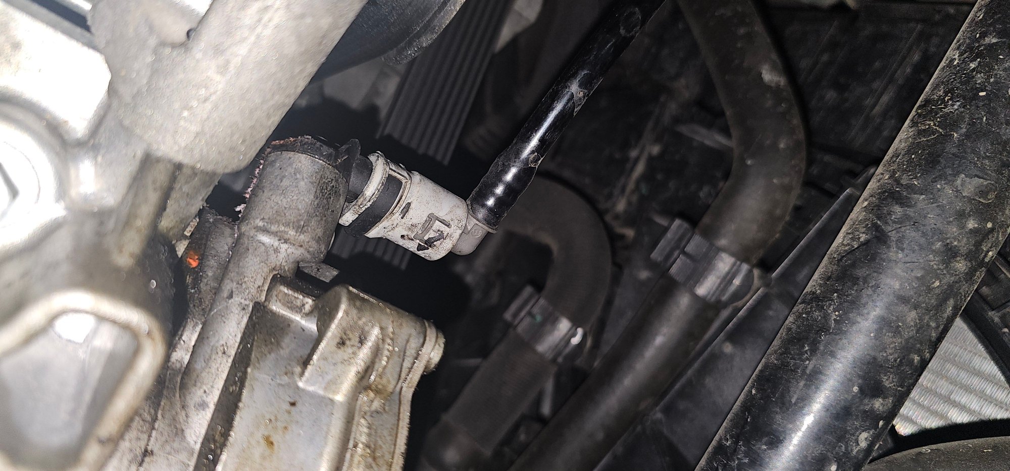

Returning to this thread for advice. How do I get the vacuum hose off of my pump (pic included). The example video from RKX showed a red tab on the hose clamp, but I don't have a red tab.

Press on the black keeper and pull grey fitting off the black nipple. Hard to get a finger in there but you can wedge a screwdriver shaft in-between the black keeper and the pump. Not a lot of pressure is required.
