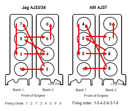

Well the purpose of the x-pipe (or H-pipe) is to balance out the uneven exhaust pulses in the V8, the V8's have an uneven firing order with two cylinders on each bank firing in succession. If you can imagine it fires; right, left, right, right, left, right, left, left and that sequential firing on the bank kind of doubles up the exhaust pulse down that pipe, the x-pipe, h-pipe (call it a crossover) relieves some of that pressure by balancing it out down the other exhaust pipe.
VelocityAP Jaguar F-Type High Flow 200 Cell Sport Catalysts + Downpipe-firing-orders.jpg
The V6 on the other hand is even fire; right, left, right, left, right, left so you don't have the same big pulses of exhaust.
I think an x-pipe will change the sound on a V6, but I don't think it'll bring any measurable performance gains, not like the V8's where they do really make a difference...
