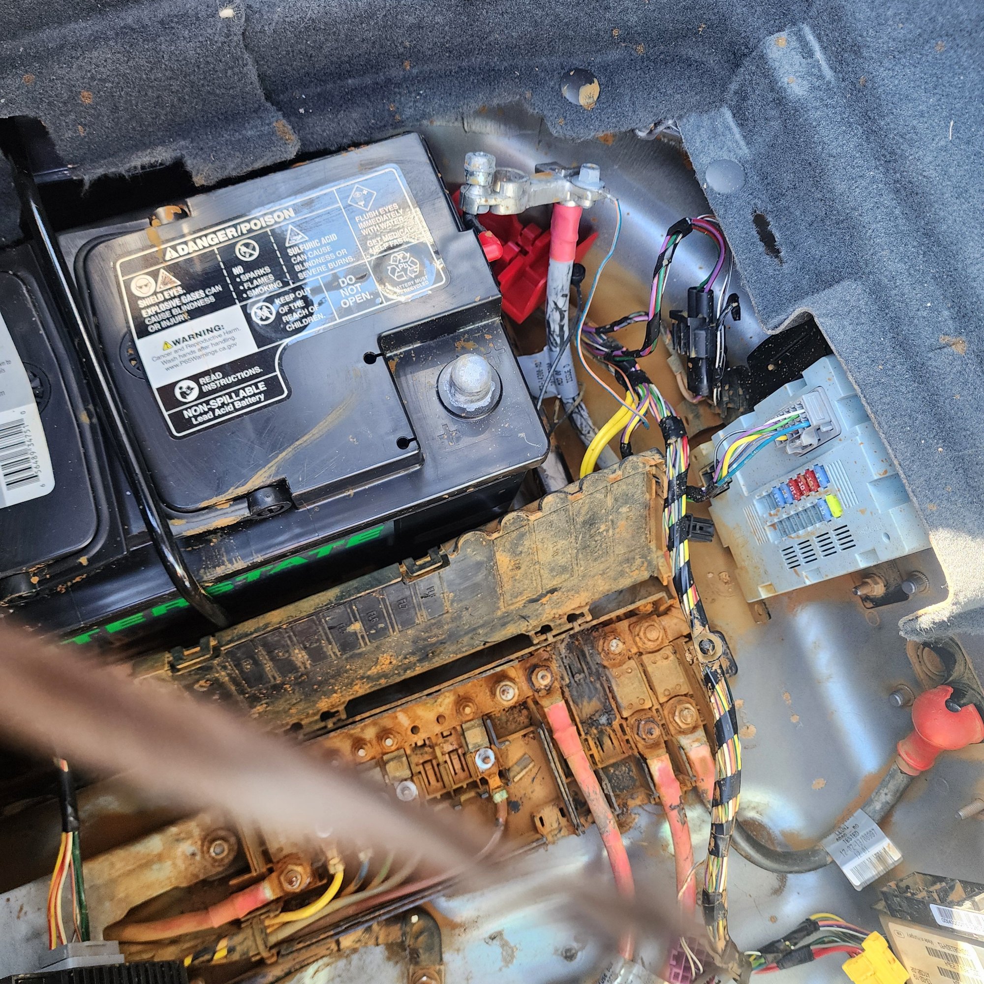

Default Bad to worse
Okay I have bad news for myself I thought I posted this already but I don't see the post so I'll repost it just in case maybe I'll get some people laughing at me apparently this car got wet a long time ago I opened the trunk to disconnect the battery and it was an inch of water in the bottom of the trunk. The fuse relay in the middle was completely rusted I mean rusted and the water in there was reddish brown and it had swatched all around and coated everything so the whole compartment was covered in rust water. I removed that center fuse relay and ordered one on eBay I'm not sure that's my only problem but I'll start there the only problem the car has is not staying in gear or going into gear I'm not sure these relays these relays are going to solve the problem but I'll start there. What a mess it looks like the water came up about an inch almost 2 in so that one fuse relay is bad there's another fuse panel on the firewall there in the trunk that the bottom inch got wet I took the plug out and the bottom two prongs were Brown the tops were clean so that told me that that's where the water got to which which confirmation of water level. There's also auxiliary battery back there I'm thinking that's probably not harmed I did not remove it I don't know what's attached to it that might be harmed that'll be next but I'm thinking I'll replace the fuse block first and try it and see what happens and if it's not corrected I'll just keep going any suggested and sorry appreciate it this is really a mess this is my fault you're not paying attention this car's been under a tarp and not driven my bad lesson learned.
