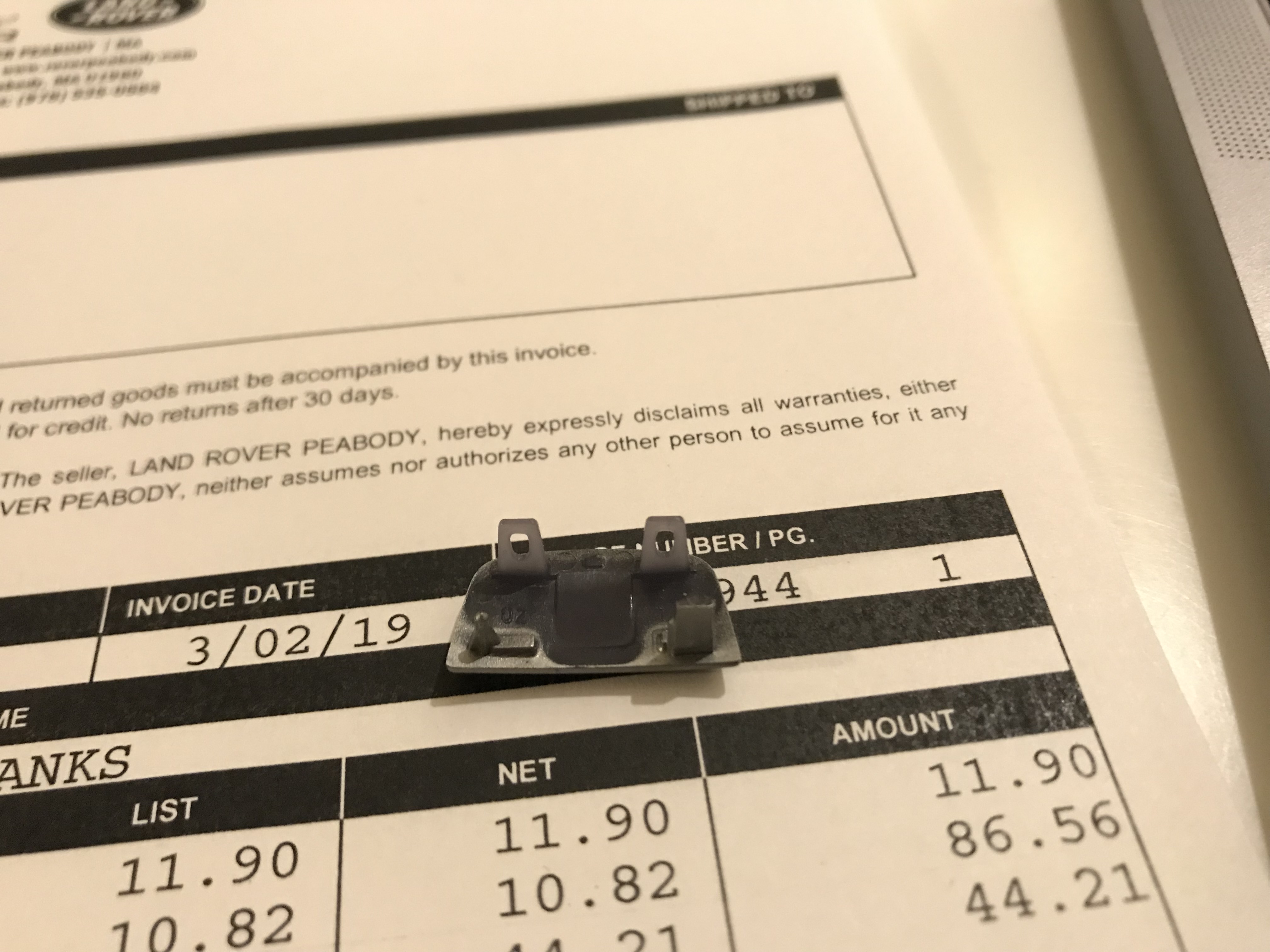

ah I'll add that detail to my first post in this thread so there's an easy place to find it
see photo attached -- its just clipped in, I slipped a small flat head screwdriver under the bottom of it and quite easily popped it out -- then slipped the new one in.
Perhaps we should build a thread of part numbers for common wear items so its easier for people to find this stuff....maybe when I'm hungover and bored tomorrow I'll put together a framework.

Could you be a bit more specific about the removal of the P button cover? The photo would suggest that the cover is held in place by pins in tabs (the two pieces with holes in them -so something in the shifter handle slots into these holes as it is fitted to retain the cover firmly?) . For removal, which side did you use the flat screwdriver on - top of the P or bottom of the P? The use of the screwdriver tilts the cover to disengage the tabs? And replacement is literally just snapping it down? Forgive the fussy questions but I would not want to break any part of this.

You've pretty much nailed the description but when I get home on Thursday I can snap a quick video of the removal and replacement
Screwdriver under the button from the rear of the car, slow pressure to tilt the button allows the top clips to disengage, and button pops up -- installation is the reversal of removal [I literally just snapped it into place quite quickly].
Frankly, I didn't pay too much attention to doing this and kinda just tossed the screw driver under the button and it popped right out

Thanks! And a video of the process would be very helpful...it isn't that I think it is difficult but rather that I would not want to cause any damage.
