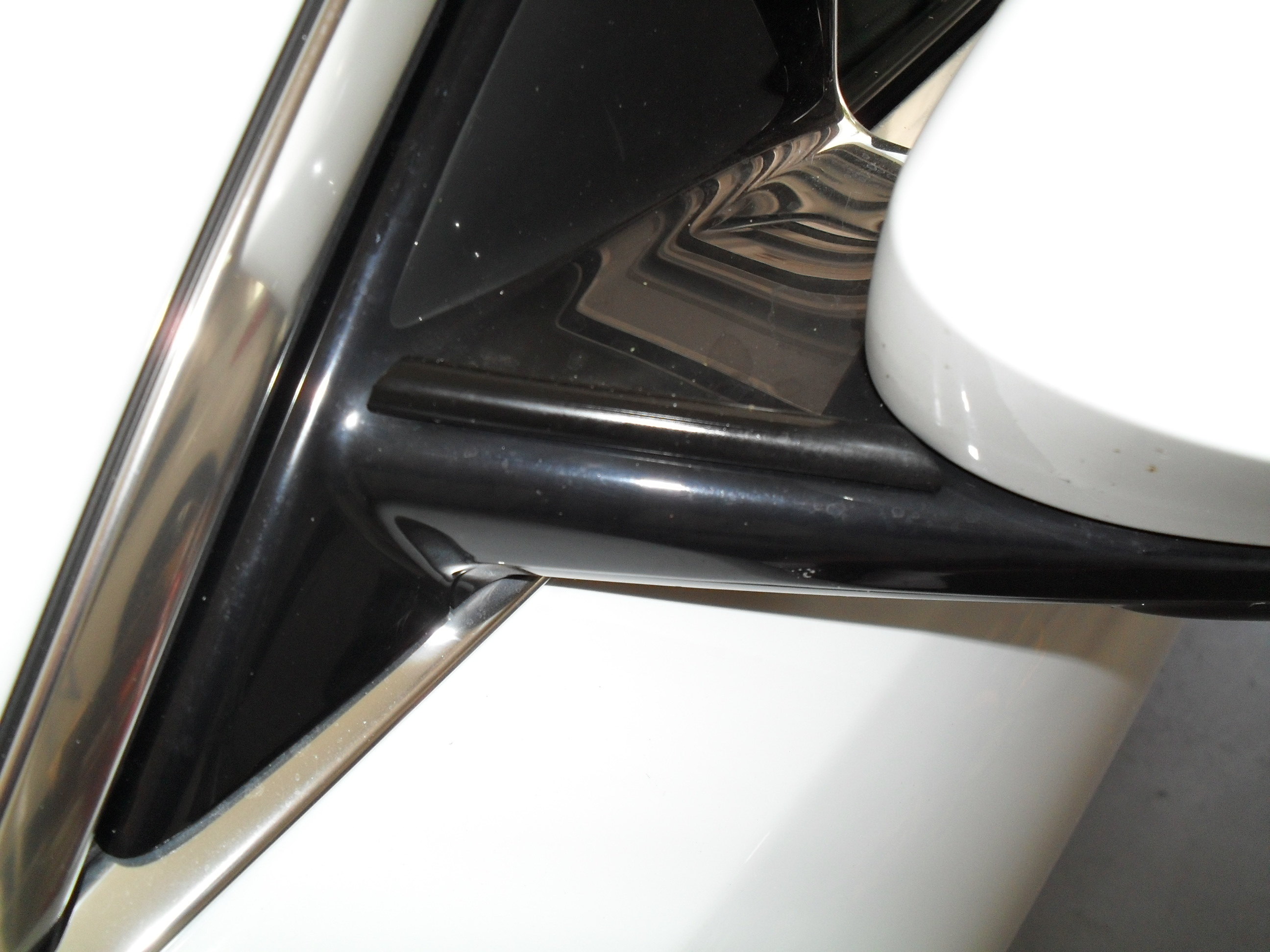

Default Solution To 60 mph Whistle
With the driver window down on my 2015 v6 Coupe, there was a high pitched whistling sound starting at about 60 mph coming from around the mirror. It could not be heard with the window up. It is now gone. My solution was to go to Pep Boys and buy the thinnest rubber gloss black body side molding. I cut a piece to fit on the front edge of the outside mirror. The self adhesive is strong enough to keep it in place. No more whistle. See pic. I wish the factory had a prettier fix. At any rate, when you trade in the car, just take it off.
